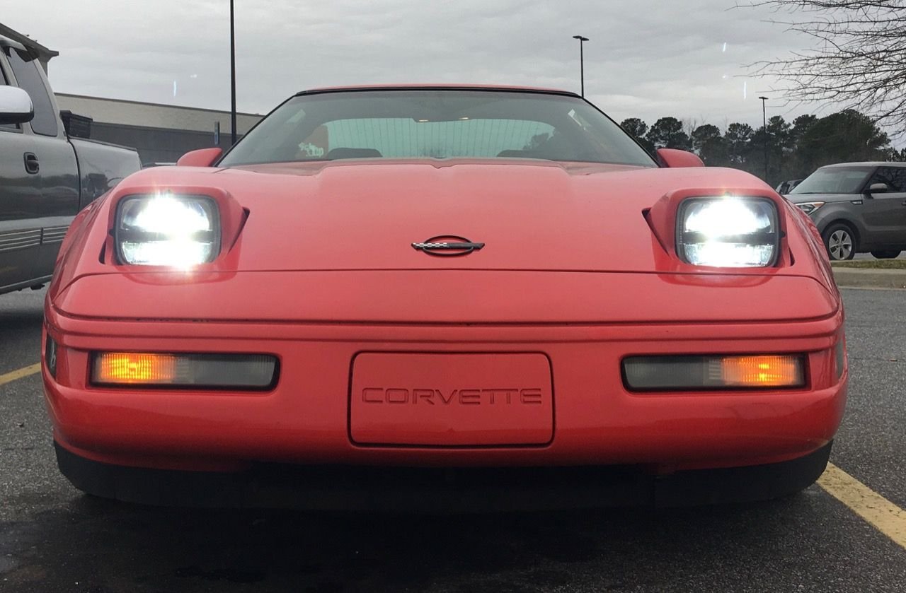

Hello everybody,
I own two C4 Corvettes i.e. 85 and 89. I am going to replace the headlights looking for better night vision. I've been to Amazon and paged through a bunch of lights that all claim to be the best blah, blah, blah. Can I get some input as to what you all are using.

Genssi LED with the correct resistors to make life easier?

No and no. No resistors and it is plug and play

https://smile.amazon.com/dp/B0733G5Q...roduct_details
No external resistance required. Just plug and play. Three years of excellent service so far. Wife couldn't believe how well they lit up the road.
Highly recommended but of course they're the only ones I've sampled.
Brights make the fogs go out. Just like stock.

Just another option is to go with traditional lights with replaceable halogen bulbs should one burn out. Many on the forum are using these

I installed GE Nighthawks, love the but needed to ground the fog lamp relay to the frame otherwise the high beam come on with the fog lamp switch.

I put these in and it is a night and day difference, literally. I have not grounded the sport light relay yet, so if the sport lights are turned on, it will activate the high beams.
