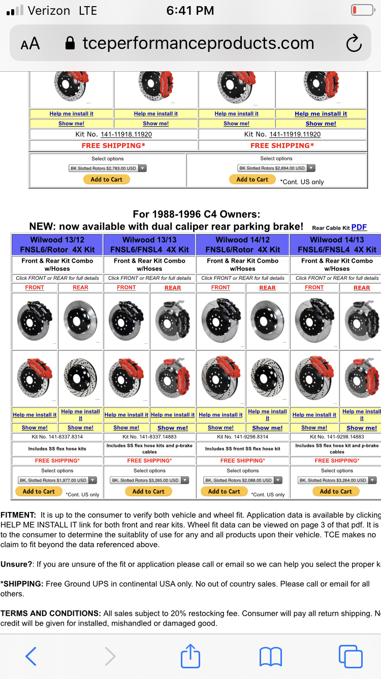

this site has good resources for c4 options. Many manufacturers dont support c4

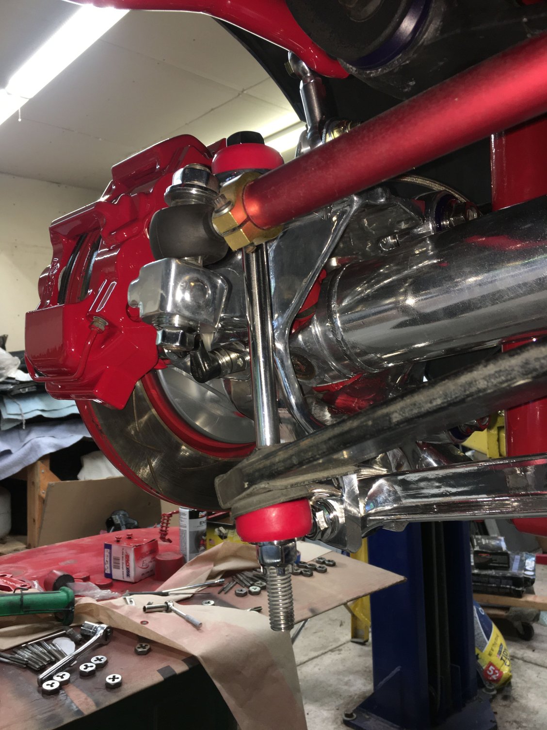

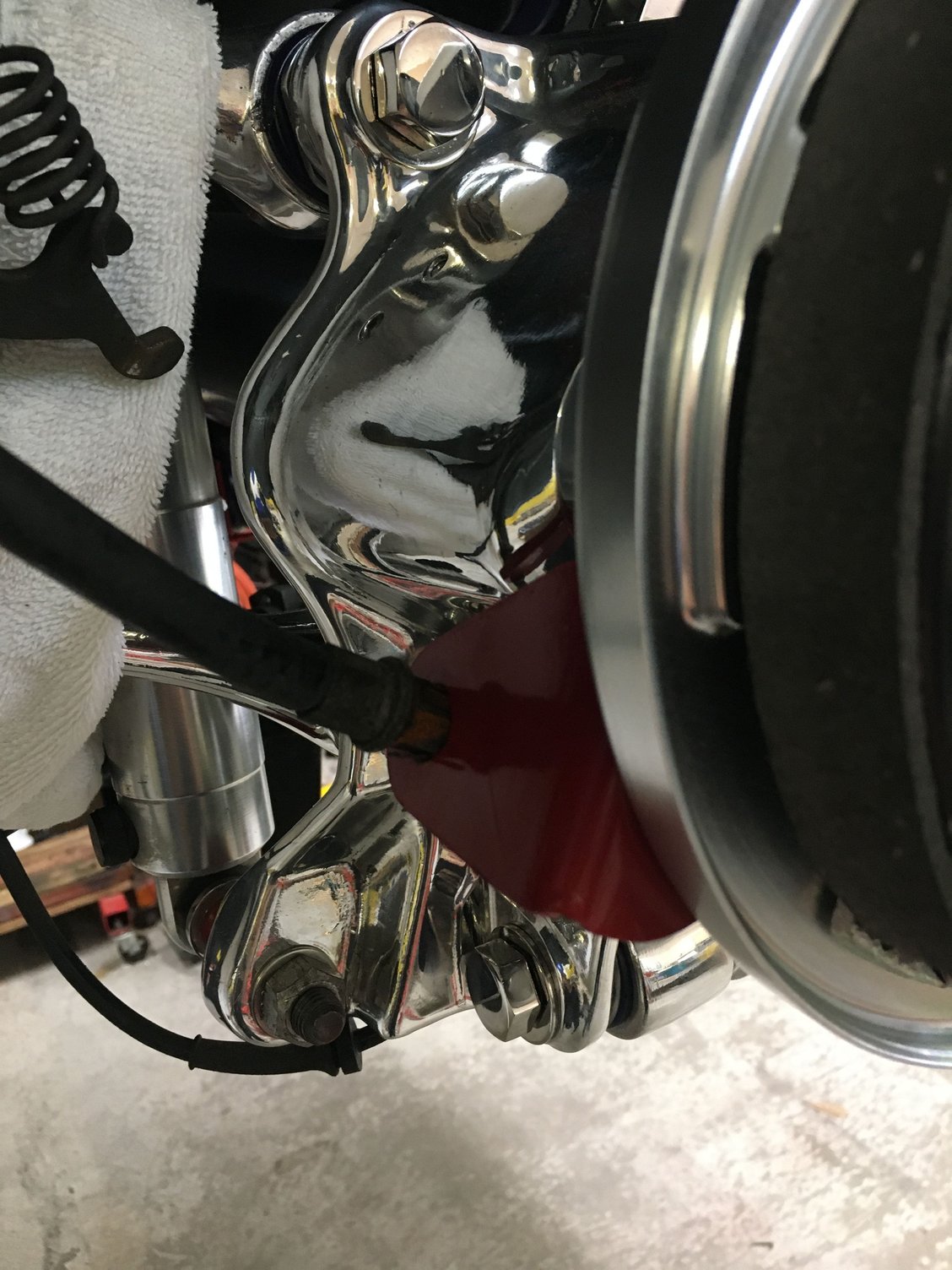

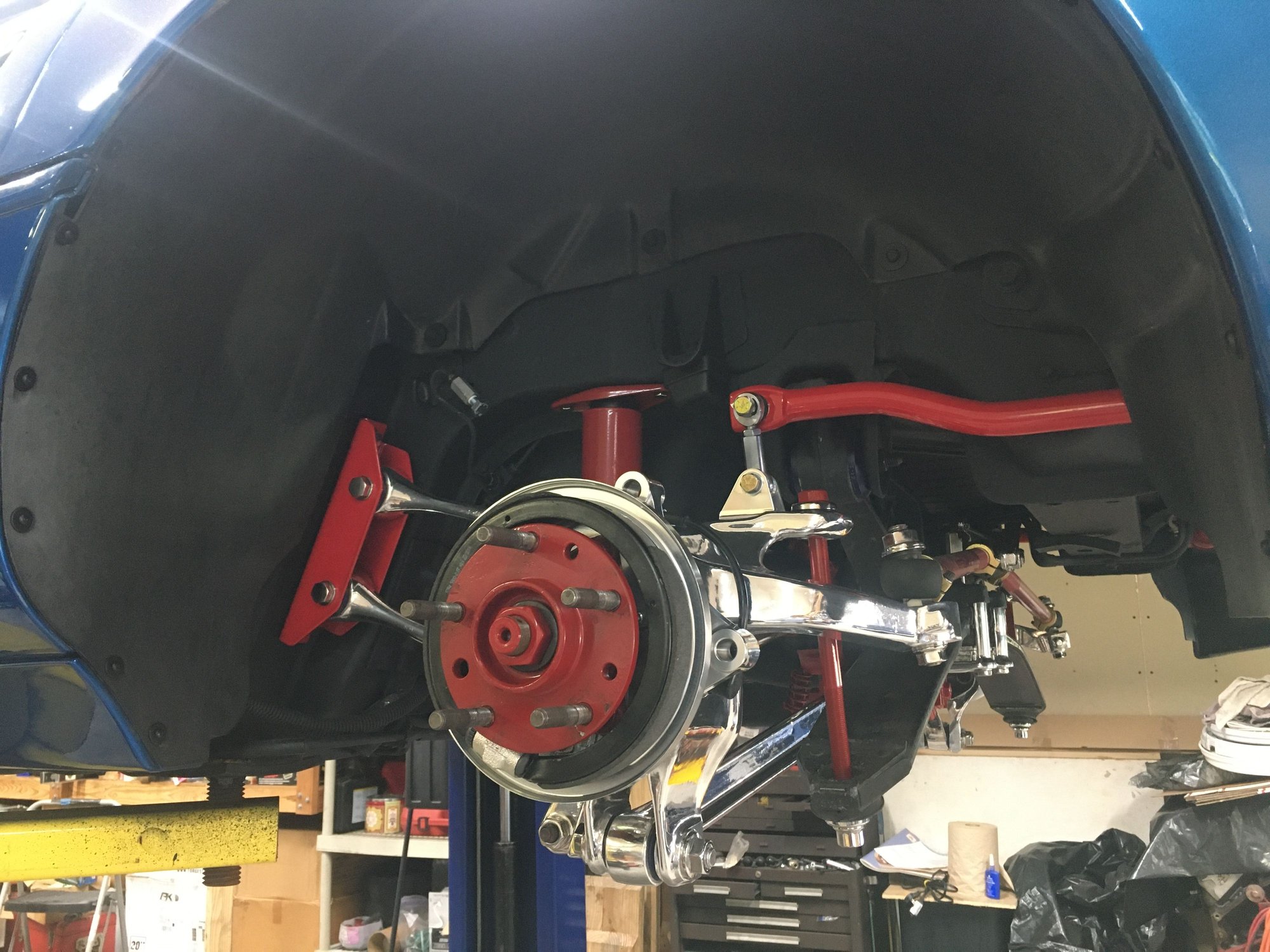

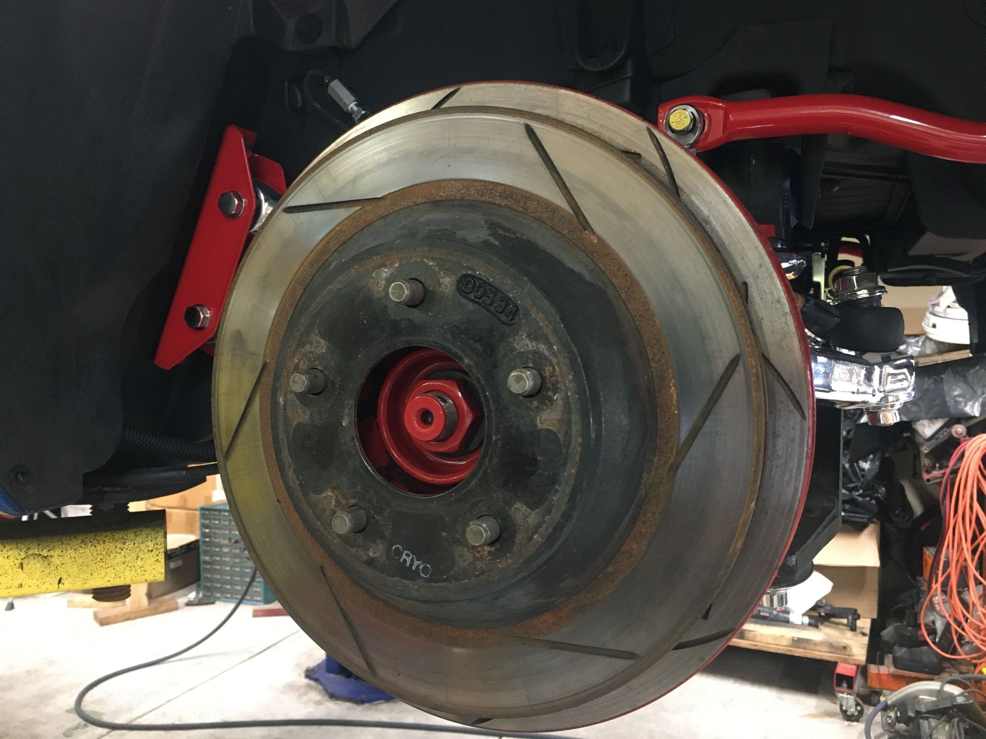

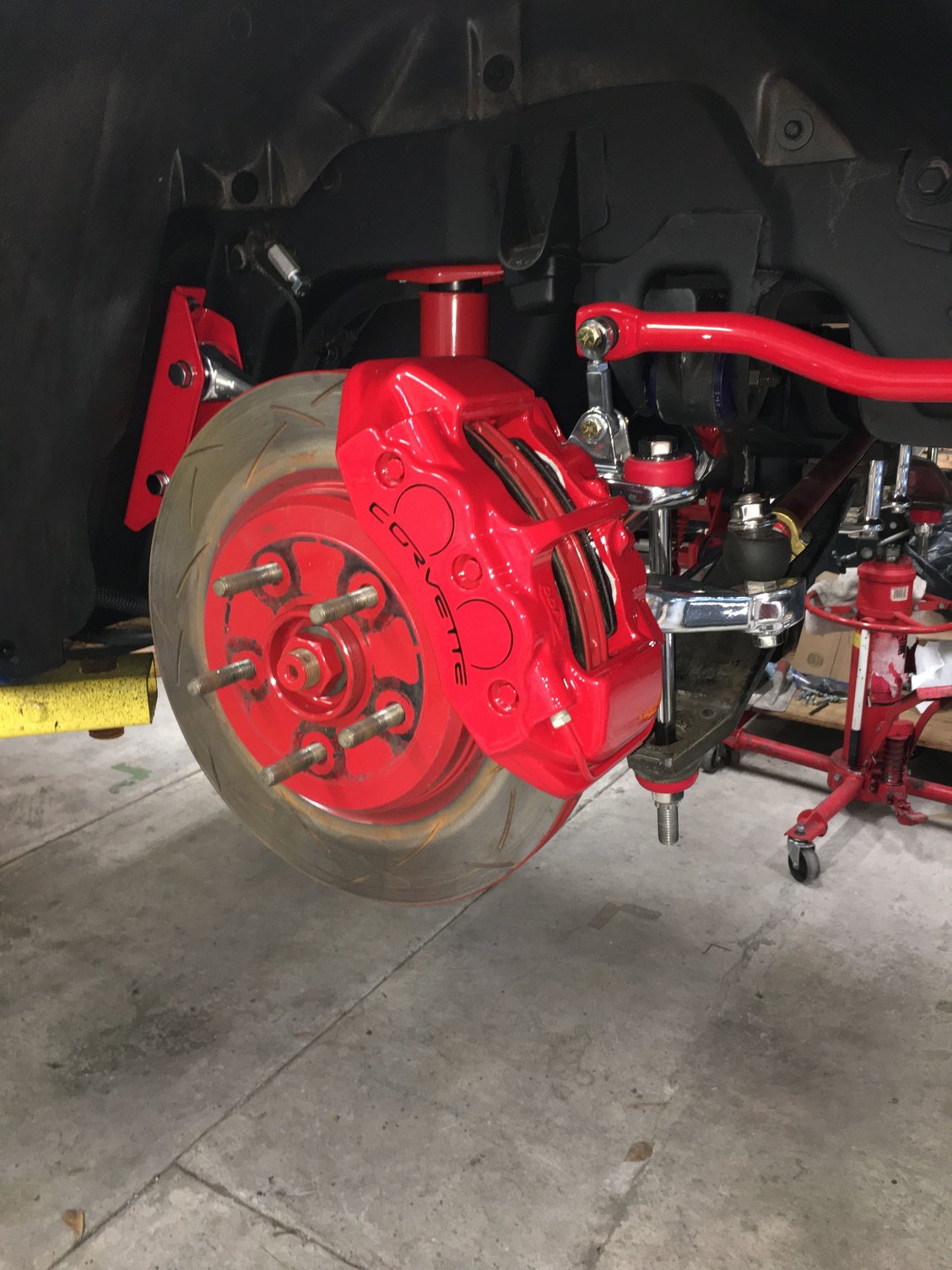

street shop is the vender but the adapters are not on the web site, you need to call and talk to trey. he also told me that the oem brake cables will fit if you pull them real tight but i didn't like that scenario so i am going to get a longer pair made up.
this bracket is where the e-brake cable gets locked in
this is the adapter plate with the brake shoes
this is the c4 rotor overlaid on the c6 z06 rotor. the c4 rotor is .8" thick and 12" diameter. the c6z rotor is 1.05" thick and 13 3/8" diameter.
the boss on the adapter for the lower caliper bolt needed to be milled down .300" for the bolt head not to interfere with the abs sensors.
and this is what it looks like all together.
