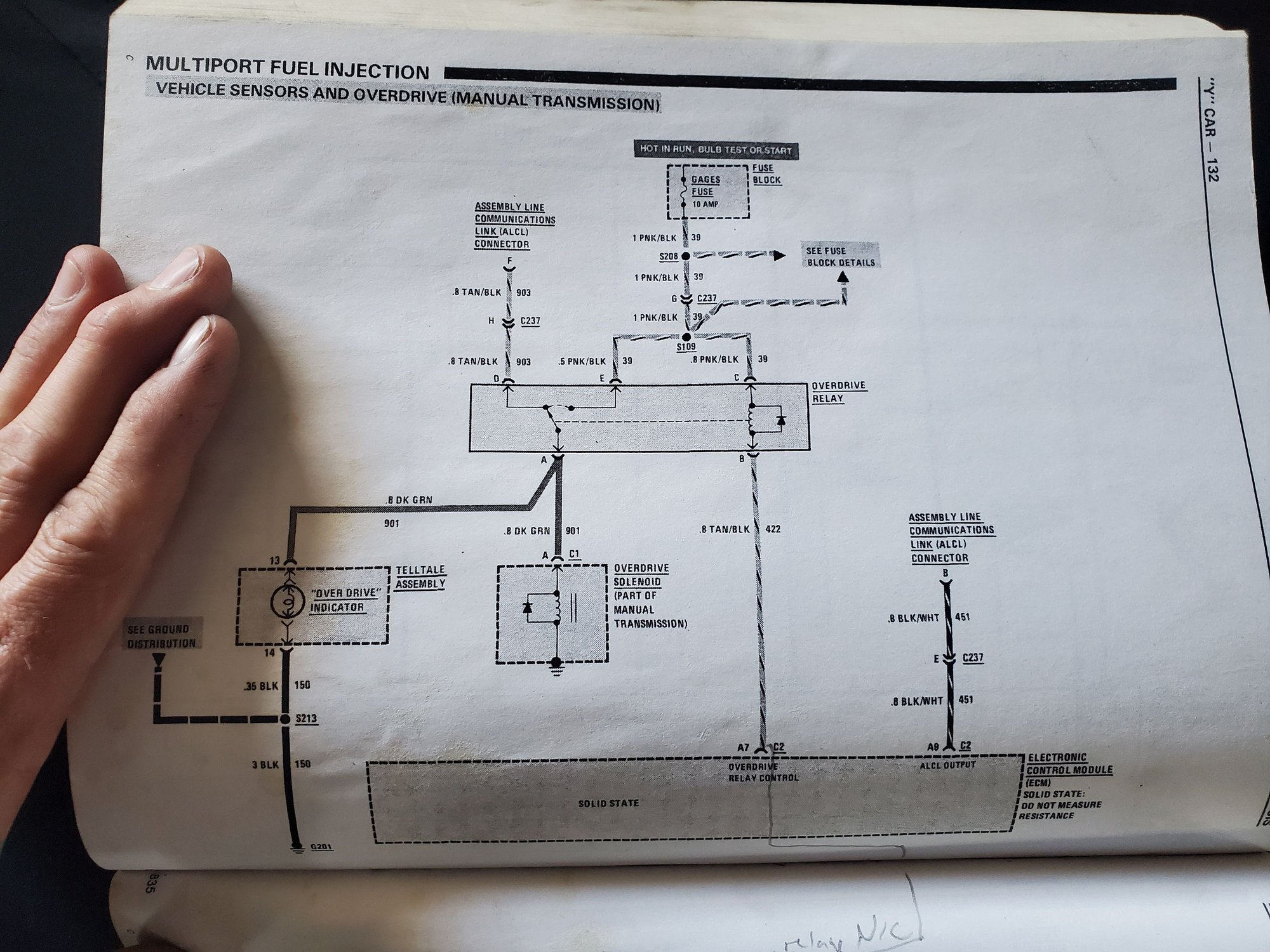

Yes, it can. When I switched to Holley EFI in my 85 I used the factory wiring,(keeping the switch that doesn't allow OD in 1st gear intact) added a relay, and used the switch on the console. Are you looking to put the Holley in charge of the overdrive or have manual control of it?

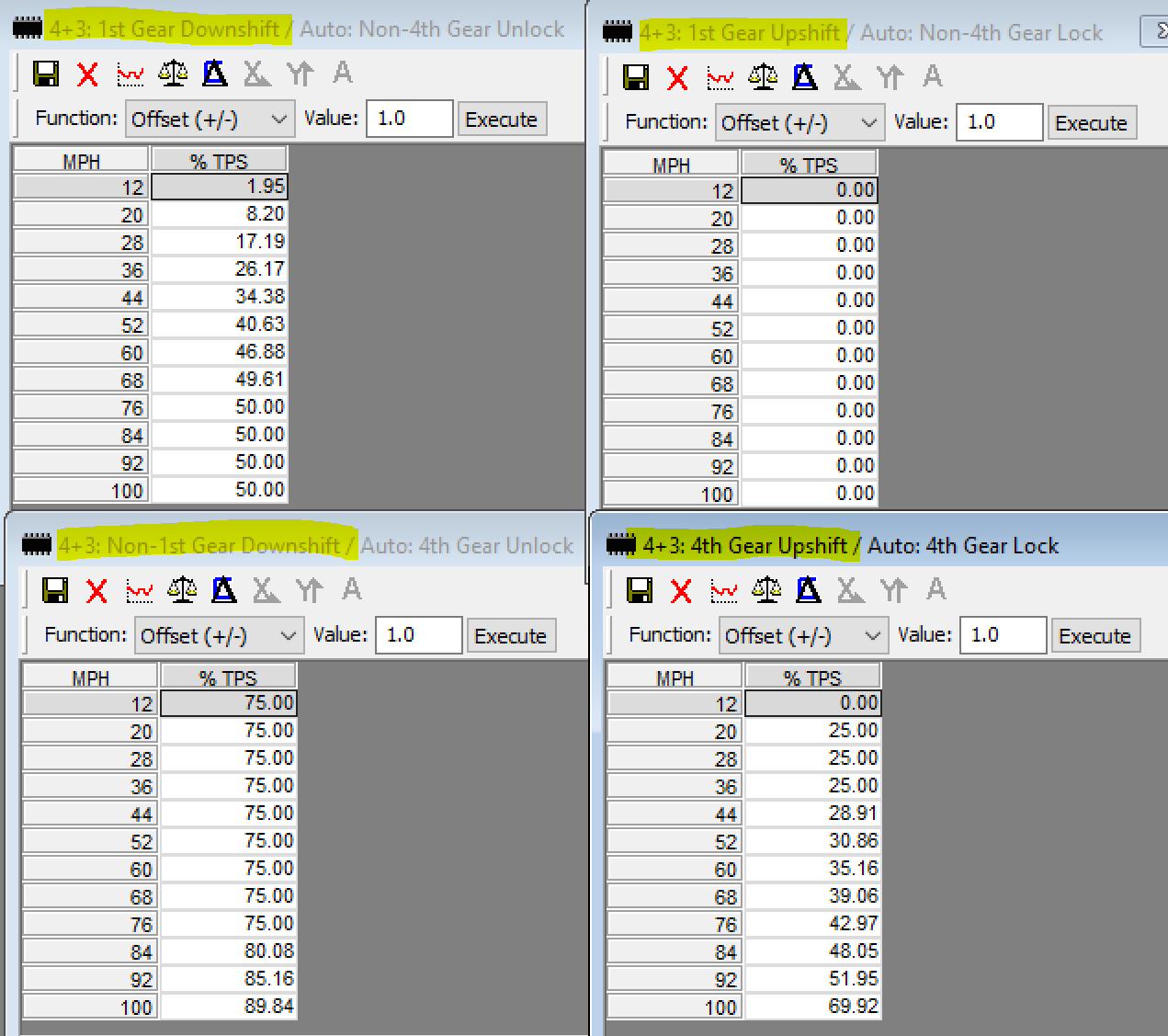

Here are some of the 4+3 parameter tables out of my 87 if you ever want to start integrating it into a modern ECM.

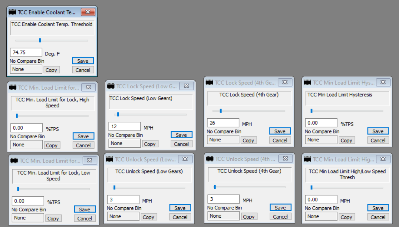

TCC values which I believe still come into play for OD.

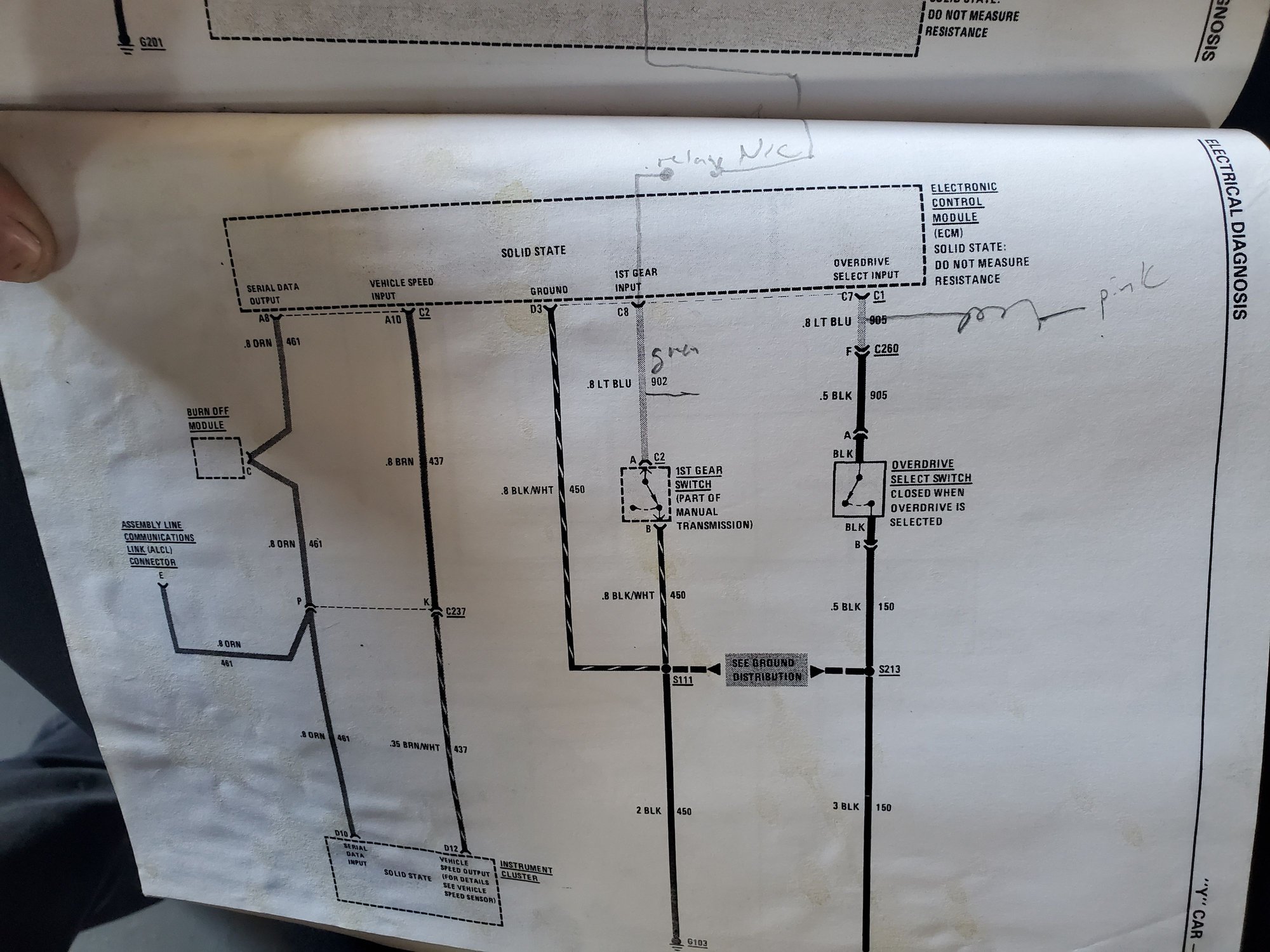

I'm running a Holley HP. (I would suggest the Dominator if you're planning on running boost. I ran out of IOs quick once i added the turbocharger!)
This is how my overdrive control is wired now.

If I’m reading this correctly there’s a black wire from the OD select switch that changes to a light blue wire which goes into the factory ECM? Since you’ve got a Holley I take it you added a pink wire in place of the LT Blue that originally went into the ECM?

It's been a while since I worked it but I believe the black wire changed to light blue. The pink wire is just the 12v + constant with ignition in start and run. I had plenty of those left over from the factory ECM harness when I stripped it. I would check a wiring diagram for your year if it isn't an 85 though.
