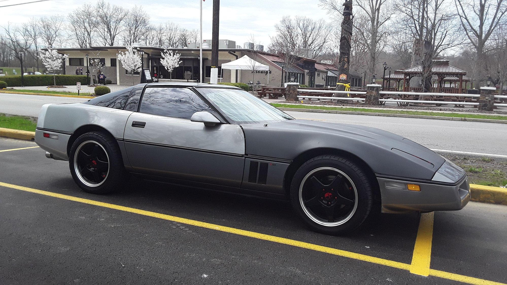

P.S. Here she is if you haven't seen her before.
