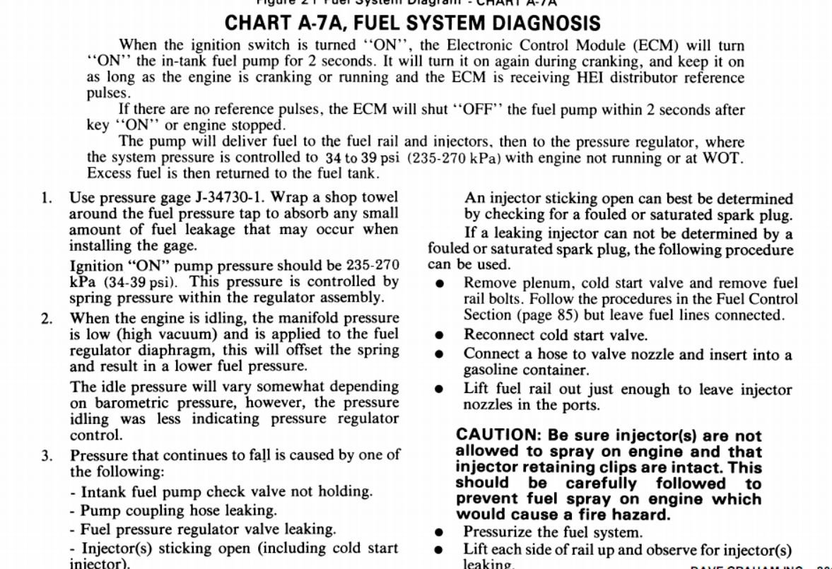

I've been tearing into the '85 I just purchased as it is almost entirely original, including the vacuum lines... As part of this I bought an adjustable fuel pressure regulator to ensure that I can get what I need out of any diaphragm I buy and now I'm about ready to get it back together.
I've got a question regarding setting the fuel pressure. The FSM for 85 says the pressure should be 34-39psi with the ignition on but engine OFF and "lower" with the engine running. Haynes and "the Internet" says this should be the pressure while RUNNING and that it should be 47-48psi with the engine off.
Any idea what best practice is here? I would usually swear by the FSM but maybe people have figured out better since it was printed

I would still listen to the FSM over ANY Chilton's, Haynes or aftermarket whatever. Most aftermarket manuals are written to cover more than one model or engine type and they lack sufficient detail on your specific model.

On my 1988 C4 I see 42-44 psi while idling when all is working properly. When you shut the engine off the pressure should hold somewhat and slowly bleed down. If the pressure drops too fast it might indicate a leaky injector.

stock 85 should be 36-38 key on.....should hold for a few minutes with key off....get a gm fsm.....

I spoke to Gordon Kilabrew i.e. Mr C4, he said 34-39 PSI for the 85.

Thanks for the replies. I'm glad I bought the FSM for just this reason, but figured I'd ask around. My pressure drops way faster than it should so that will be something to dig into to.

The 85 has many one year only features and I think fuel pressure is one of them. Trusting the FSM is the way to go. The Haynes manual for the C4 covers many models including the 84 Crossfire, so it’s not reliable when making general statements about fuel pressure.

'85 ran lower fuel pressure than the '86 thru ..... Reason being the '85 injectors were bigger - like 30's. That's why Lingenfelter used them. So say if you are using like Ford 24's the higher fuel pressure more closely mimics stock.

The FSM says I may have a restriction in my fuel return line, which I'll have looked at when I get the AC hoses replaced. Other than that I fired it up and took it out anyways. No codes even on the highway so I'm pretty pleased.

My 85 ran around 36 psi fuel pressure when she was standard, i do recall when i replaced the pressure regulator diaphragm it was in the 40 psi range.
Had to use the cover that came with it to run under 40 psi. the 85 has 24lb injectors hence lower fuel pressure.
They do like higher fuel pressure however will run rich at idle, i think 50 psi was a sweet spot bit the fumes from exhaust makes the eyes sting !!!
As for the fuel pressure holding when turning the ignition off, the injectors and fuel pump should seal for several minutes.
The usual culprit is the plastic pulsator between pump and sender piping cracking if the pressure drops straight away.
You can replace it with a piece of fuel hose and hose clamps, i have added a fuel pressure gauge on the schrader fitting to always show pressure.
My 85 will gradually loose pressure over half an hour or so, it does not affect restart from hot or overnight cold start as the pressure bumps up to normal right away when the fuel pump turns on.
