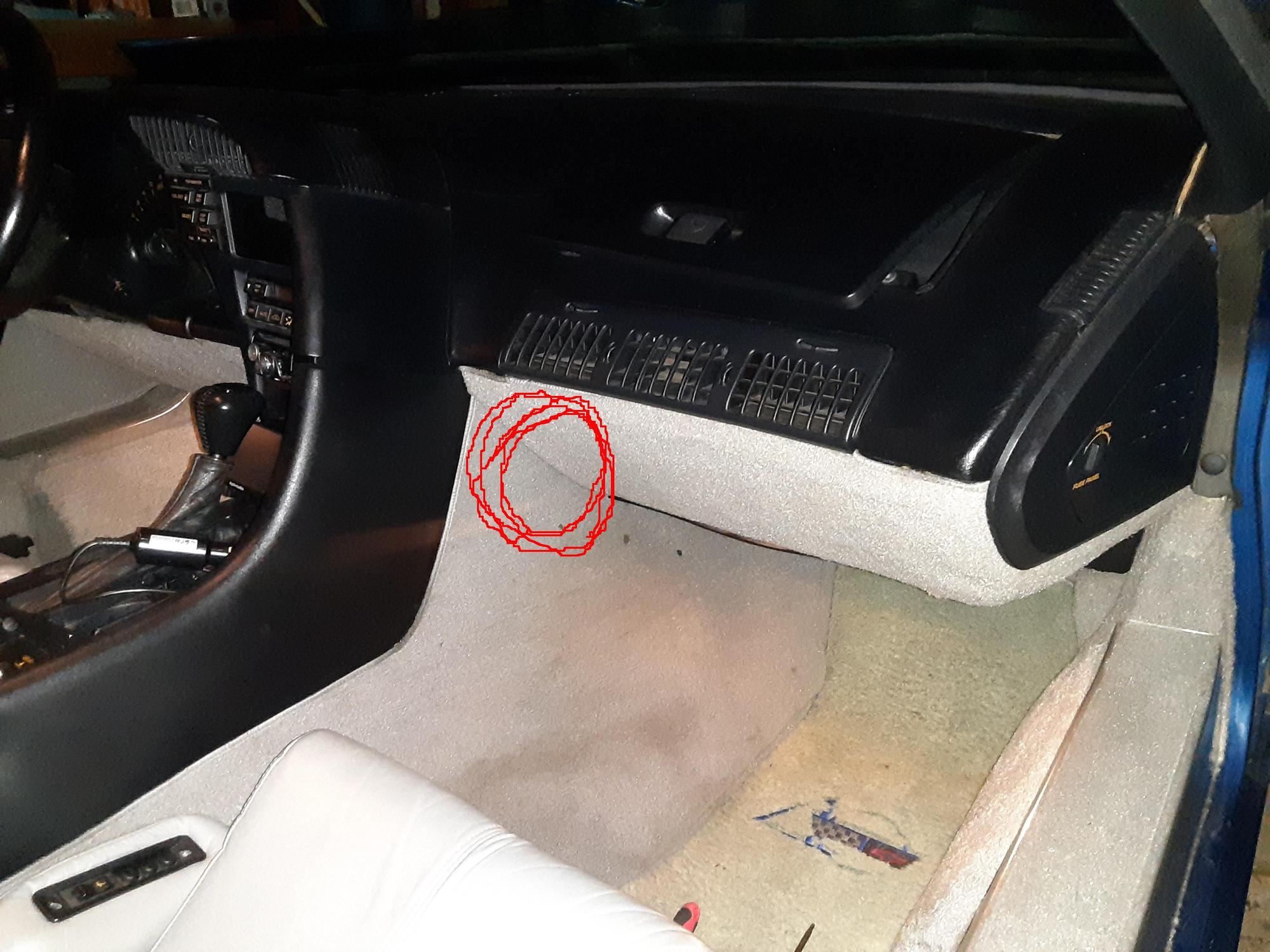

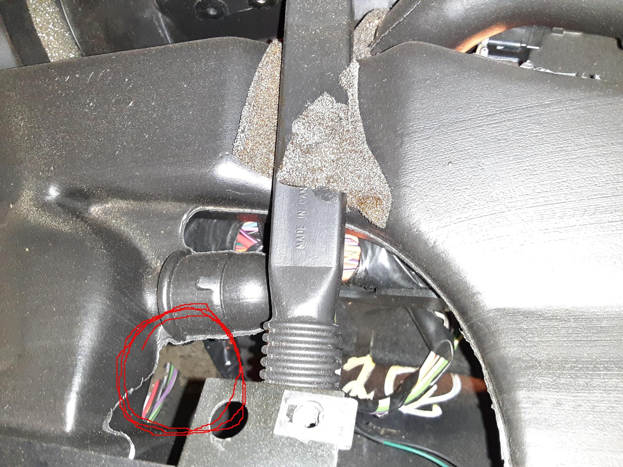

Alrighty, here's where i am so far, i took two front screws out of the front of the lower plastic part under dash but could find any more screws. I took the glovebox out and can see the nest (its down and to the left looking down into the glovebox whole) but cannot reach it due to plastic tubes in the way, if you look at the carpet under the glovebox part of the dash to the left where it connects to the center console the nest is right there, behind the center console on the right side ride next to where that carpet connects,, if i can remove that under plastic part i should be able to reach it.
position of the nest
looking down into the dash from the removed glovebox, circled is the nest ( be glad you cannot smell the second picture)

When I removed the center dash piece to install a new radio I found a huge nest made from the carpet insulation and some chewed wires. But no smell at all. Take yours off and take a look and maybe you will find your damage.

Couldn't find that last screw to the under dash so took it to the shop and the mechanic showed me where it is, found the nest, about softball sized,
