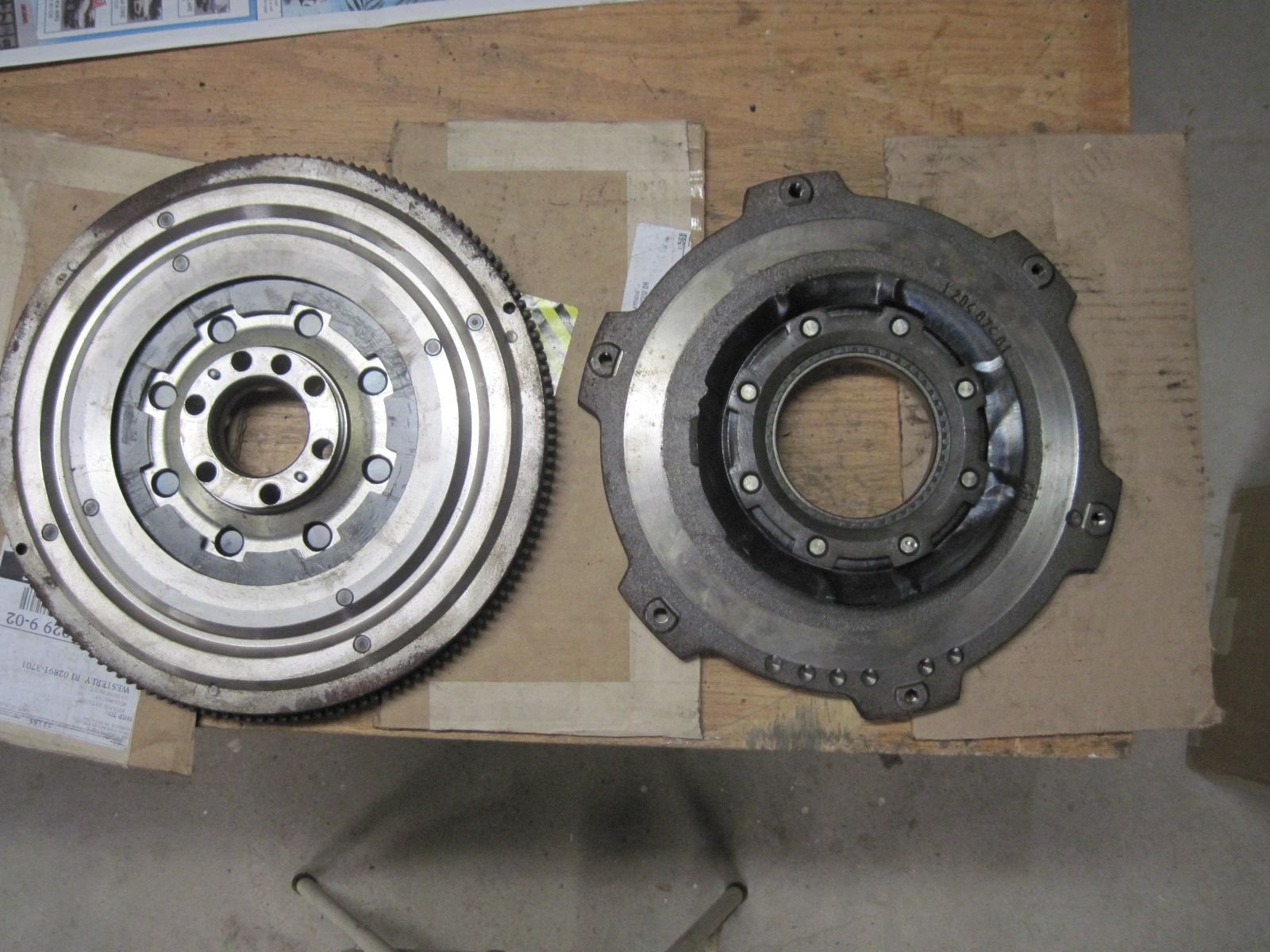

By way of a postmortem, this is what the insides of a dm flywheel look like. I expected to have a bunch of loose parts come rolling out, but nothing except two or three tiny coil springs were loose in there. Looking at the innards, I can't figure out how it was supposed to work or how it made the noises it made. BTW- I was able to duplicate the noises with the wheel on the bench before I took it apart. Anyone need a paperweight?

Banging against the stops that limit its maximum lash excursion?
Interesting photo. Thanks for posting.
