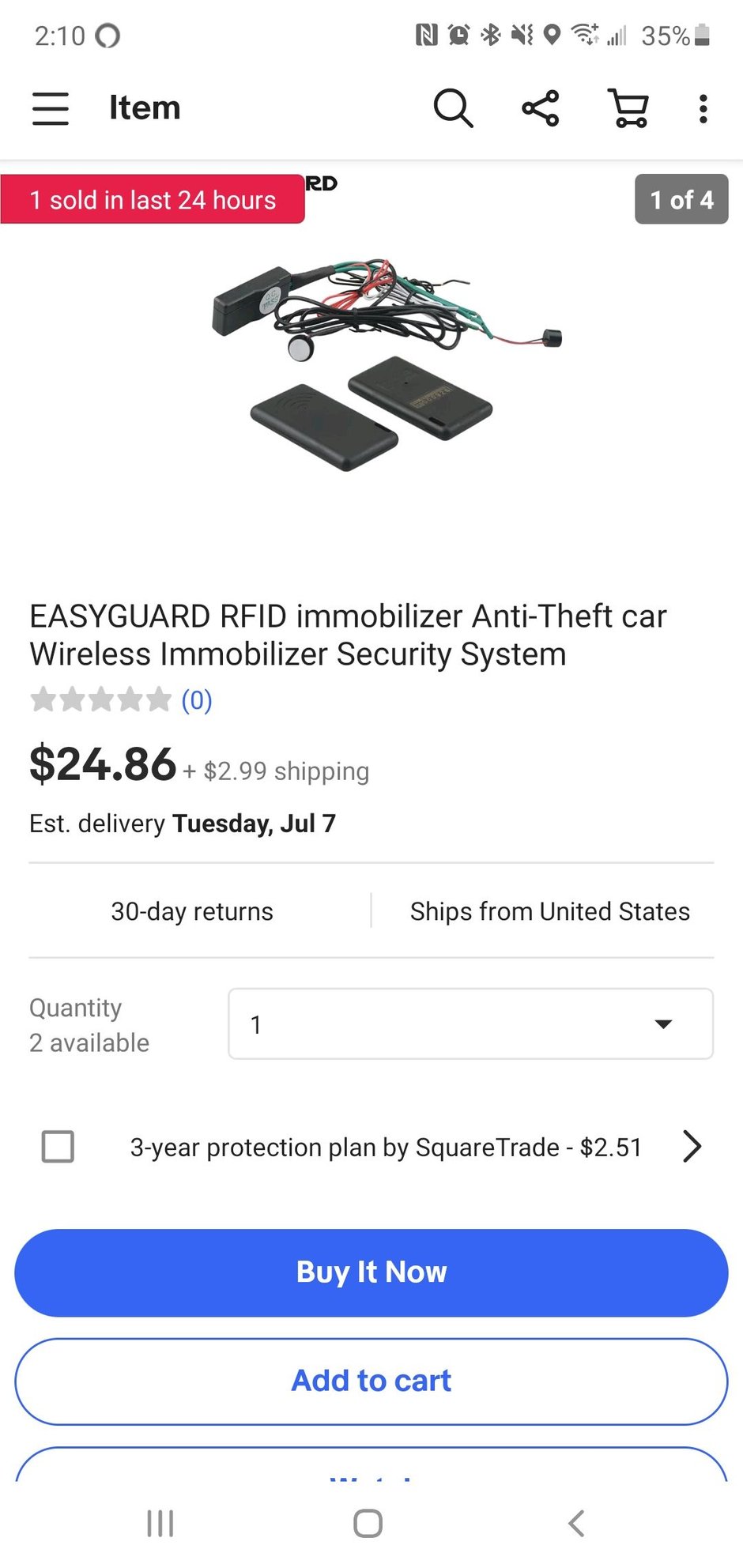

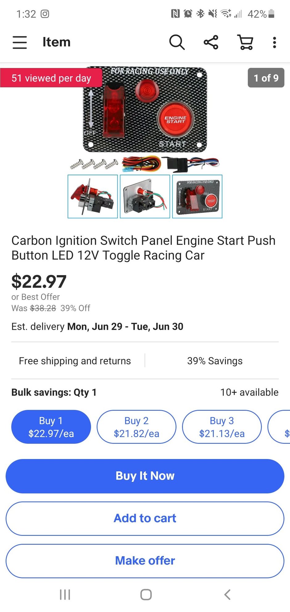

Old Jul 5, 2020 | 01:43 PM
Nicholas Cortez's Avatar
Nicholas Cortez
Joined: May 2019
Posts: 20
Default c5 corvette ignition and vats bypass
I have a 2002 corvette nothing is wrong with the ignition but i thought it'll be cool to switch the ignition to a toggle switch for power "auxiliary" and push start as the starter. I know this is a security issue but that's what the immobilizer system is for. My question is will be able to work and how? Do i cut of the vats off completely and hardwire or find that fuze that matches my key. Etc. I goal is to have a proximity sensor on my Keychain that's programmed to an immobilizer in the car which then allows me to start the car with the push start.
