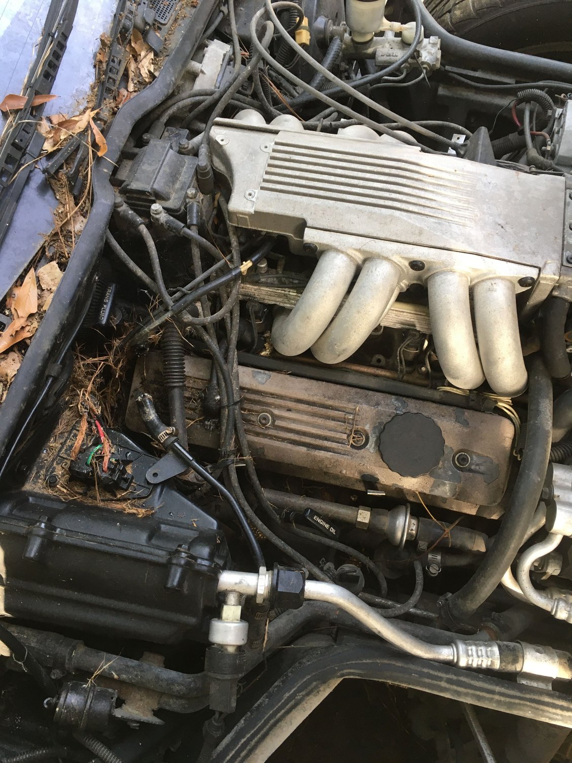

So I bought an 87 from an old military vet. Didn’t pay much for the car and In my restoration, one problem I’ve come across, is the transmission went out after I pulled the car off the trailer and drove it about 100yds. Now it won’t go anywhere. The linkage is moving , and the reverse lights are illuminating. One issue I had is on the left side of the engine, passenger side, some rats
blessed me with there presence and chewed through the coolant line and a bunch of wires up top. Wondering if this was related or if anyone can help a corvette novice....

First check fluid level and color. If it's full your going to need to remove pan and check for debris. If there's alot of debris transmission will need repaired or replaced. You could contact seller for more information about it. It may have been why car was parked. Get factory service manuals if you plan to diy this project. Manuals can be used to identify and locate items in the mess under the hood.

Low fluid will make the tranny slip. Might have been leaking over the years. The wiring shouldn't affect the transmission. It has a mechanical linkage and only the lockup is controlled electronically.

FIRST....I'd power wash the beJEEZUS out of that thing!
