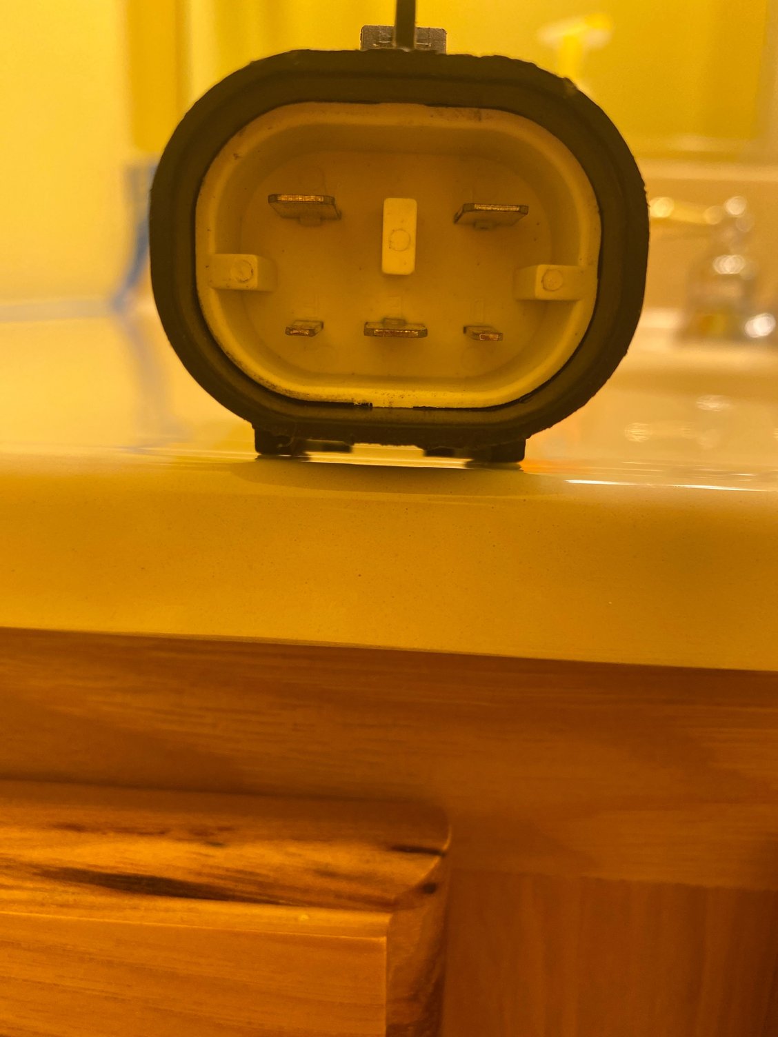

Originally Posted by KyleF
I have lived this code 36. I have bad news for you... you will always have it coming back and it is irrelevant.
Can you post a pic of the inside of your MAF? Is it the hot wire or thin film?
Good news, there are options. Custom tune to turn it off, convert to EBL, Blower works makes a much better MAF set up but will still need a tune, switch to an entirely different ECM...
Code 36 tends to go away and come back.... If you have a film style MAF, it may not even be returning the correct signal.
My suggestion, you can follow all the FSM and members suggestion on how to solve a non-needed function or put your time and money into deleting it.
The MAF is new. It is the hot wire.
I searched for and found the part numbers from the first response in this thread and that type of relay does not work. I replaced the relays with the same part number as I thought you were suppose to do for a 1989. After I replaced the MAF the code went away and I drove it a little then it came back on. I think the previous owner did the same thing to fix it.
Yup, typical of the go away and come back. The ECM is not seeing the proper voltage returned. This is common unfortunately. I have had a MAF car since 95 when I got my 86 Trans Am LB9... I am goign away from MAF.
Sure, MAF has it's benefits and if you look at newer cars they are employing both a MAF and MAP to use either or where it is most beneficial. The most direct route is to have it programmed out. I think if you contacted certain people... you can PM me for a reference since they are not sponsors, get a scan of your car and have them do a custom tune with the Code 36 turned off, you will be very happy and get a bit more performance to boot.
Yes, you can trace wires and troubleshoot the Code 36... I imagine the time saved with a tune will be worth avoiding the headache.
