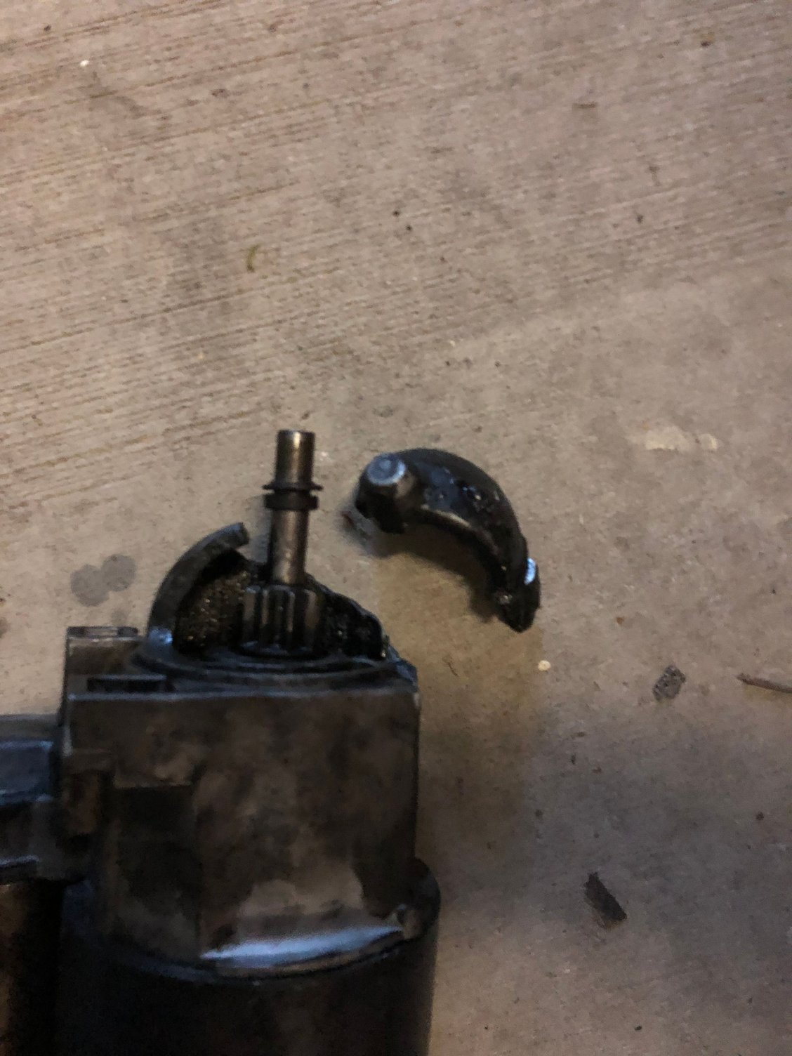

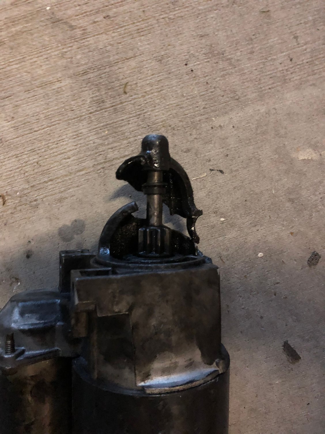

Old Jul 24, 2020 | 03:33 AM
GregMartin's Avatar
GregMartin
Joined: Jun 2018
Posts: 1,402
Likes: 287
From: Brisbane Australia
My old straight drive started making a horrible sound then failed. This is what it looked like!
