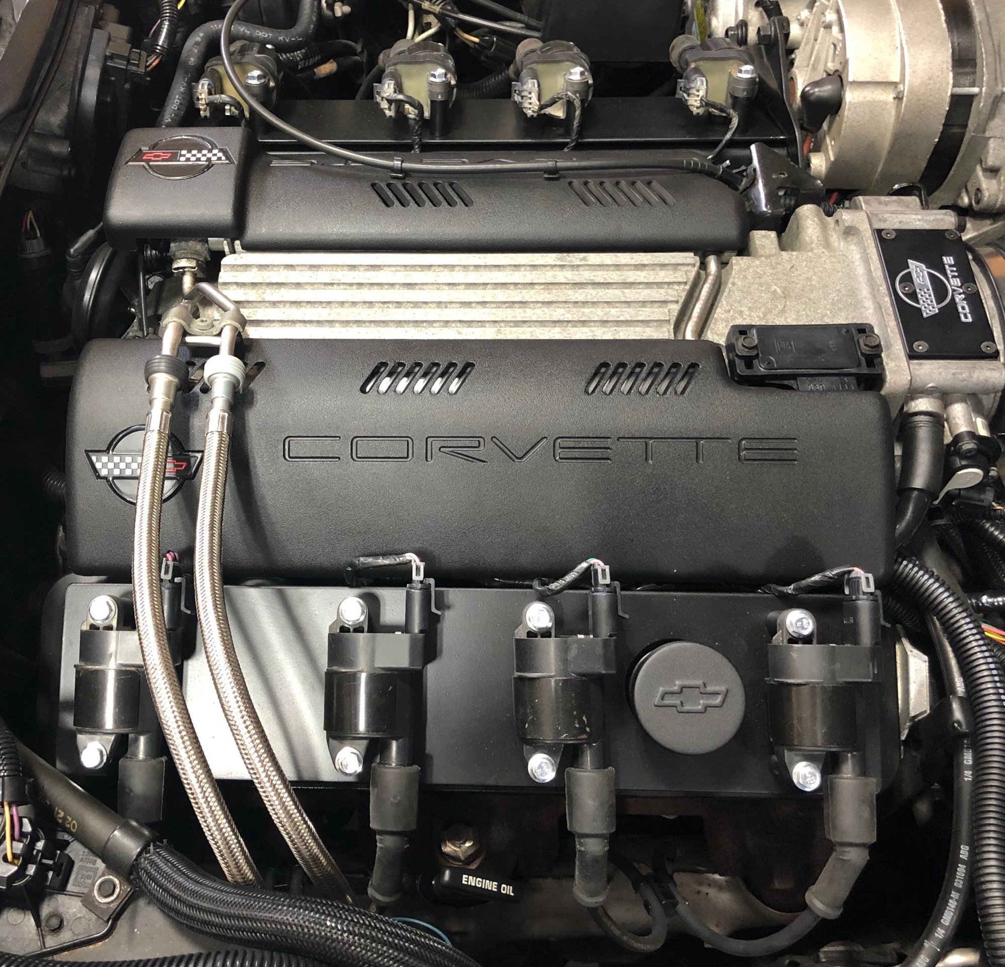

It’s typically the high voltage side of the opti system that fails. Get the LTCC Kit and LS2 coil packs. Your opti issues will be a distant memory.
