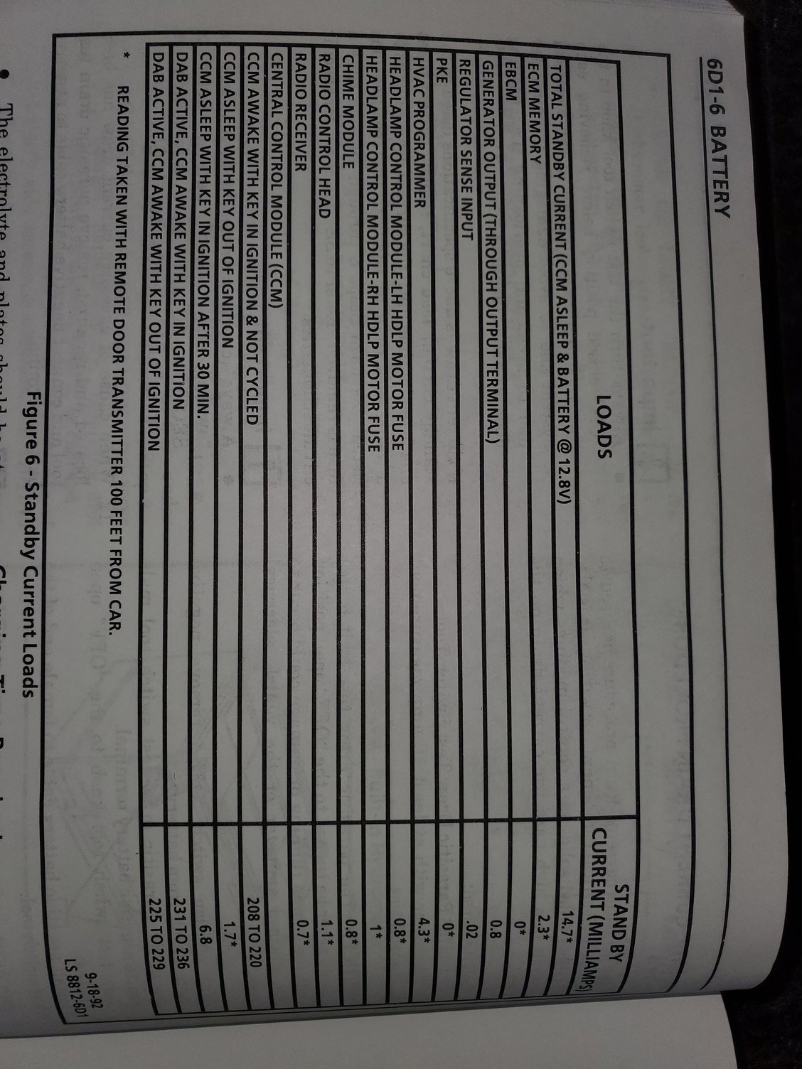

This is from the factory manual when i was at the dealer 25ma was the normal max 50-75ma was for vehicles like cadillac's that has more electronics and computers.
