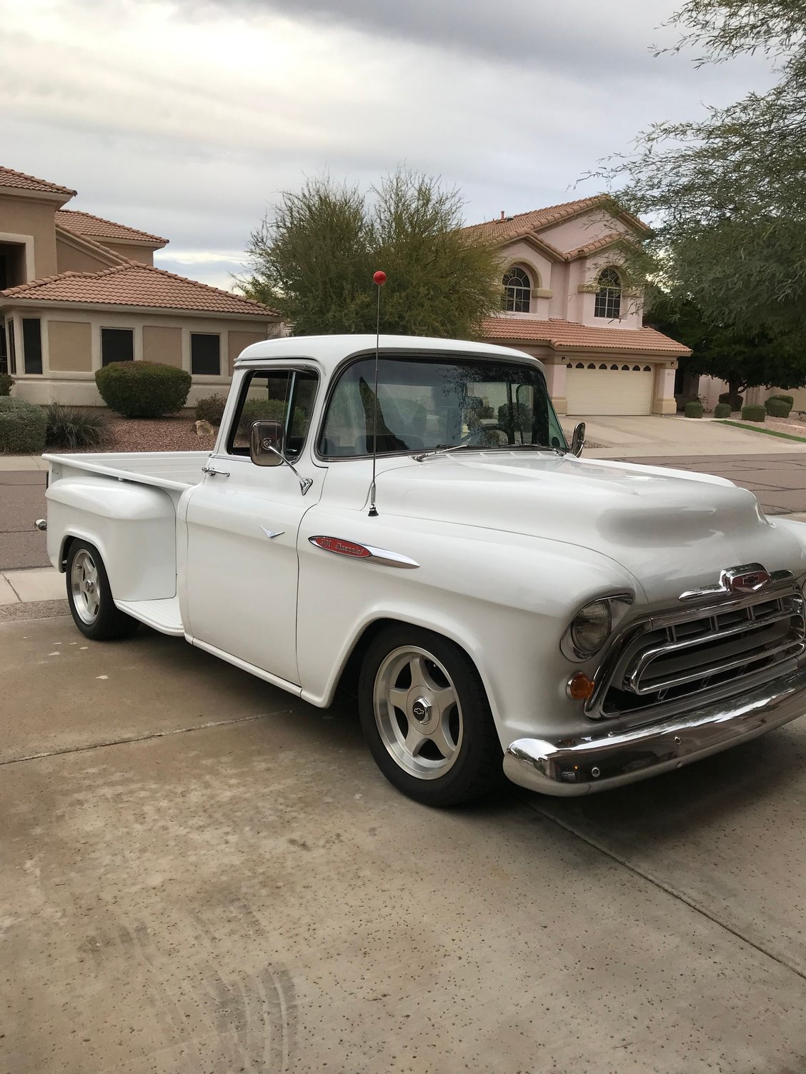

i have a 4+3 in my 57 chevy truck.
manually selected, works great.
