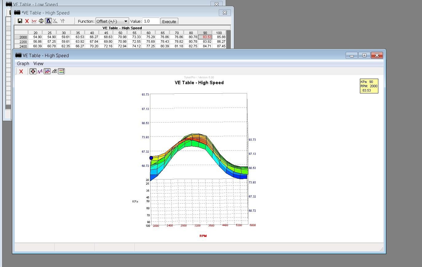

Does the Terminator X allow you to see your VE table by graphical representation? It will look very similar to your torque curve. Below is a TPI Example.
Based off this, I would like the converter to come on at @2300-2400 RPM per my understanding. Let the engine be freed up to spin up to where it starts making strong torque numbers. Once you luanch or open it up, you will stay above this RPM at each shift.
If you can see a graph or your VE numbers, it might be a better indicator of what your combo actually likes rather than guesses. The graph may be hard to see, but the 100Kpa line is closest to you in that view.
