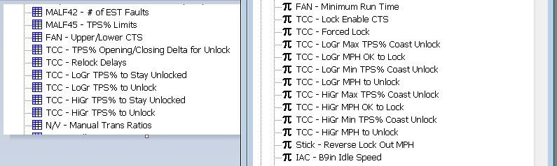

Which is a valid question because it does. I can't speak specifically to the 87 as I never had an 87, but I am going to make a safe assumption that it too has the TCC tables in the tune or some version of them. There is a SA retard at TCC lock up table, but it is not a huge retard, just a few degrees. However, there is a set of tables related to TCC lock up for high/low gear for disengagement based off TPS% and a set of scalers that control the TCC function based off speed.
I think the real question is, does the ECM recognize the switch being made or not.
The proper way is to get it tuned to behave the way you want it and let the ECM control it, the shortcut is a switch.
I understand your frustration, I have adjusted some settings in my tune to get rid of that bog feeling when it won't unlock quickly at low 4th gear speeds.
My understanding from the Turbo Buick guys is this actually allows them to run better 1/4 mile times by locking it early. What you are describing is wanting it to come unlocked faster. I think your switch will need to interrupt the ground to keep it from locking.

Originally Posted by KyleF
It's not the lube system, he asked:
Thanks for speaking your mind. I agree the ECM doesn't know. But when it commands the clutch to engage. it believes it's working, and bases its' strategy off that. Th other issue is the ECM is doing this 100 times s second. a lot faster than a human. The only exception to this id if you convert to a carb that is totally independent. Then...OK, but unless that trans has safeguards for proper lube, I wouldn't do it.If you're happy and comfortable doing it, then by all means. It is your car..
