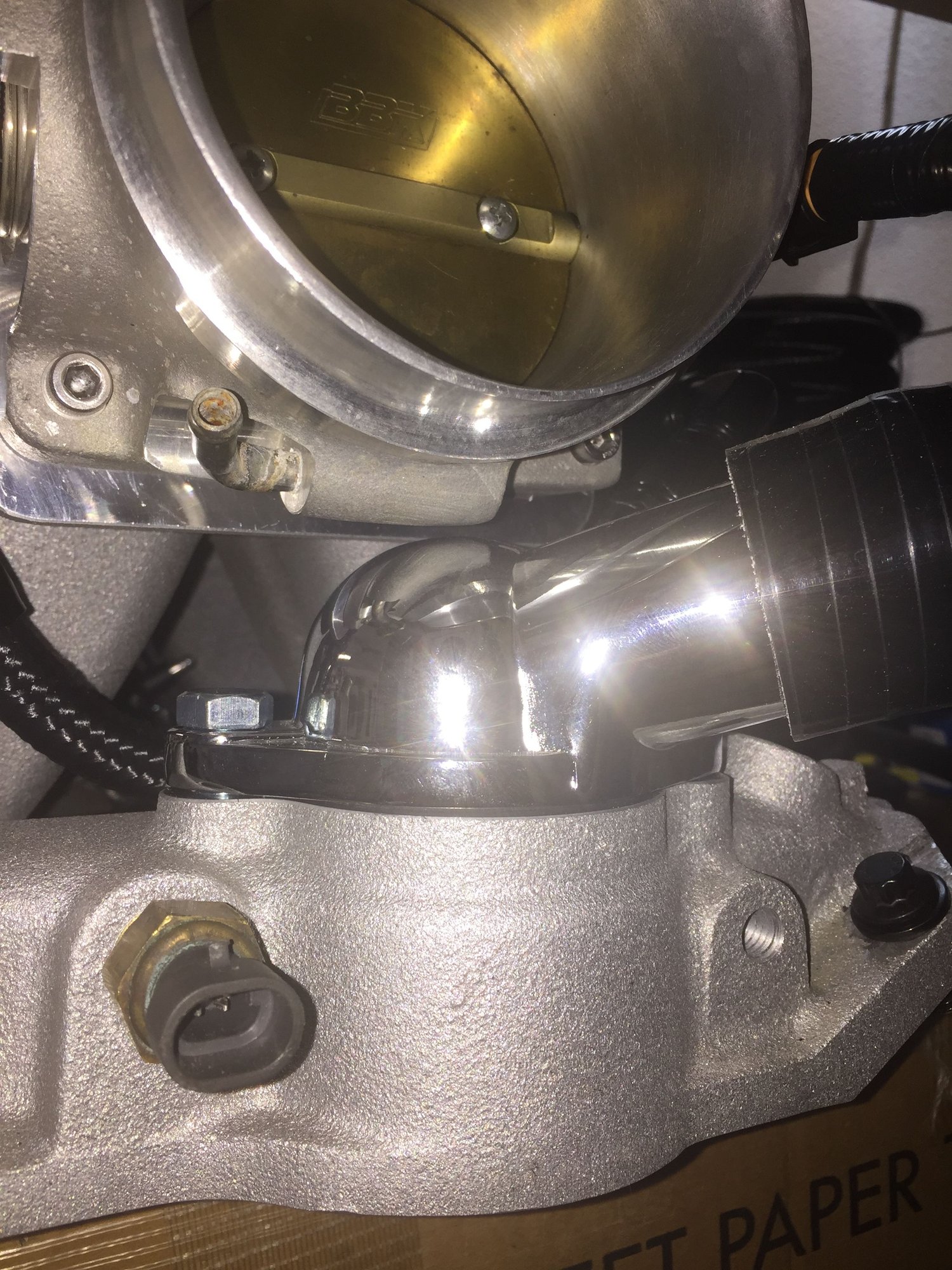

Any chance you could take a pic of your thermostat housing with that trans dapt water neck?
Thanks again!!!

Here is a pic of my trans dapt......not a lot of room but it fits with my BBK throttle body.If you are using a stock GM throttle body then you should have more clearance.
Thanks for this pic. We're using the Edelbrock LS1 TB so the clearance I believe is about 1.5 inches. Most of the necks that we've found point the wrong way.

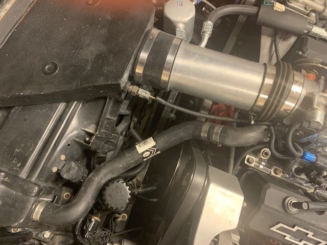

Old Aug 13, 2020 | 04:43 AM
jazfe's Avatar
jazfe
Joined: Feb 2009
Posts: 655
Likes: 164
From: Vancouver Washington
I'm using a 45 degree bend that is 1 1/2 inch at the Trans dapt 9229 T stat housing then tapering to 1 1/4 inch. I'm using that to get around the A.I.R. pump.
I believe I found it on Amazon.If not then Ebay. I would have to go through the receipt folder to be sure.
Old Aug 13, 2020 | 07:13 AM
RWDsmoke's Avatar
RWDsmoke
Joined: Jan 2005
Posts: 1,354
Likes: 325
From: San Antonio Tx
I used two stock hoses cut and spliced together with a piece of brass tubing.
