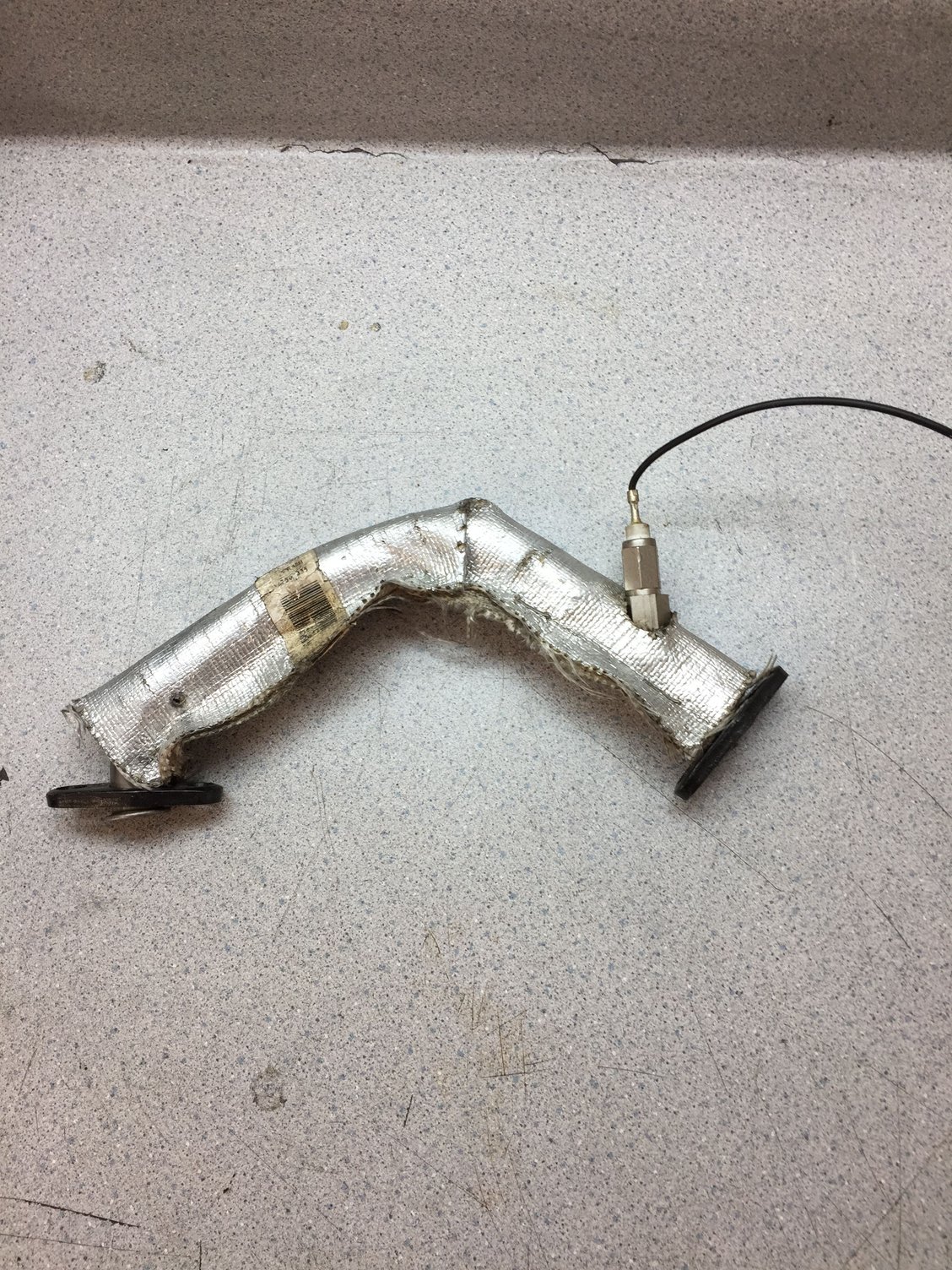

I have this one from my 86 but it was connected to my Hooker headers. Don't believe it is the stock size. I had to leave it off when I installed my xt intake. You are welcome to it for the cost of shipping.

That looks like one out of an 89 c4.
because i have one on my 86,
but i had to change the exhaust manifold to the 89 manifold too to make it work.

Thanks jazfe, pm sent.
