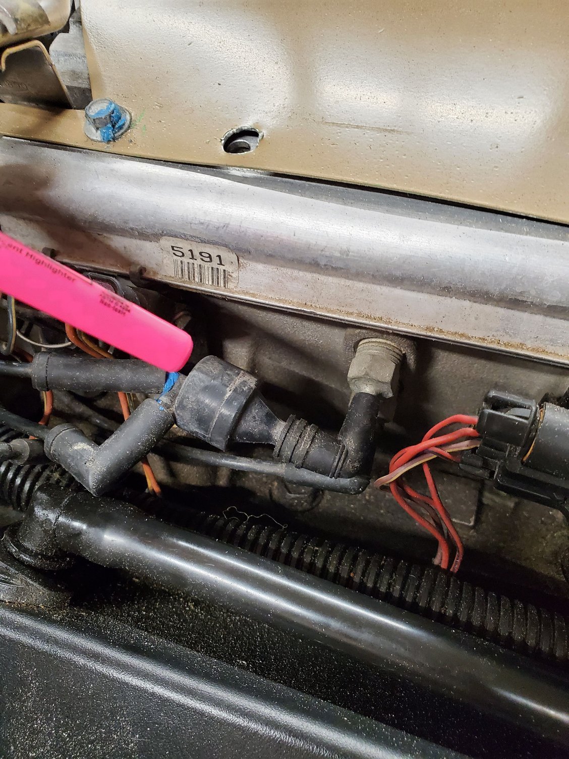

is what I'm wanting to do id replace this with a brass fitting. If I take this out will it effect anything

thats a vacuum check valve. doorman part. yes it will affect things. depends on if u need the vacuum controlled things that it controls. if u remove, plug all ends to be sure no vac leak.
whats your application/intention ?

I got one at O'Reilly a couple of years ago. From Dorman, was on a blister pack. Was cheap
P/N 47150
