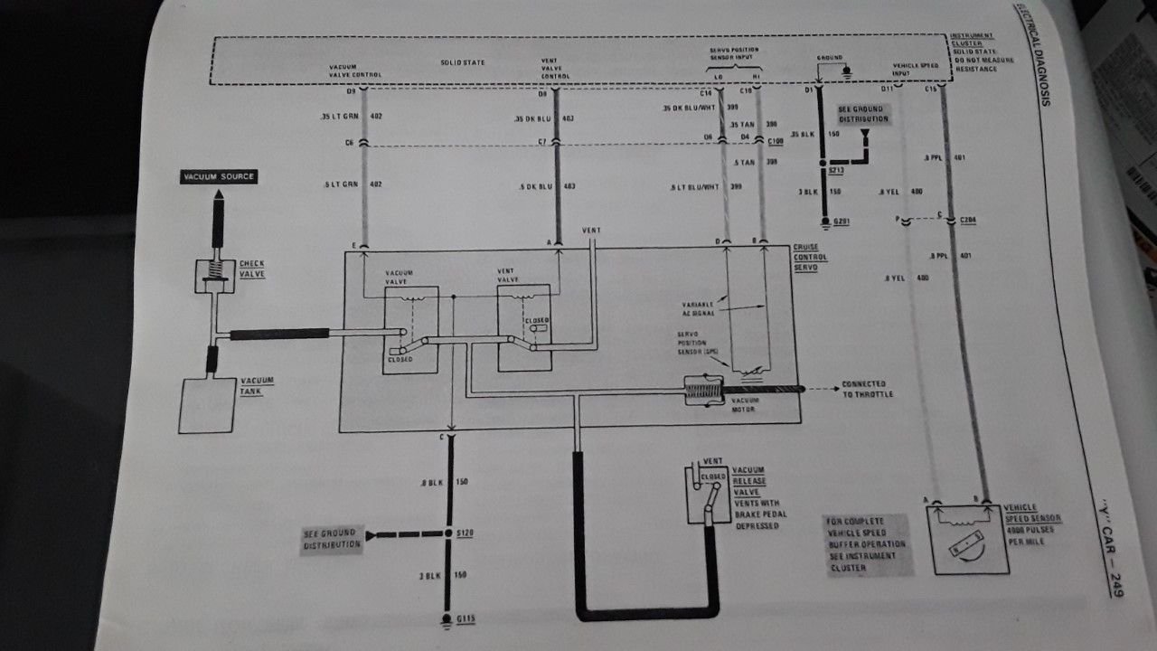

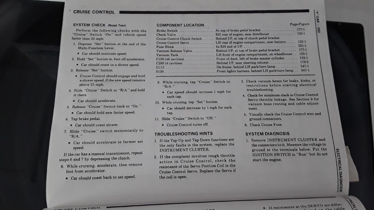

Here is what my 85 FSM shows for diagnosis. TLDR is; if vacuum, chain, grounds and fuses are good pull instrument cluster and perform the voltage/ohms checks there and check ohms at servo.

Sorry here's the schematics.
Joe K

Thanks Joe....this information is gold. I'm sure I will be able to get the issue resolved with this detailed info.
