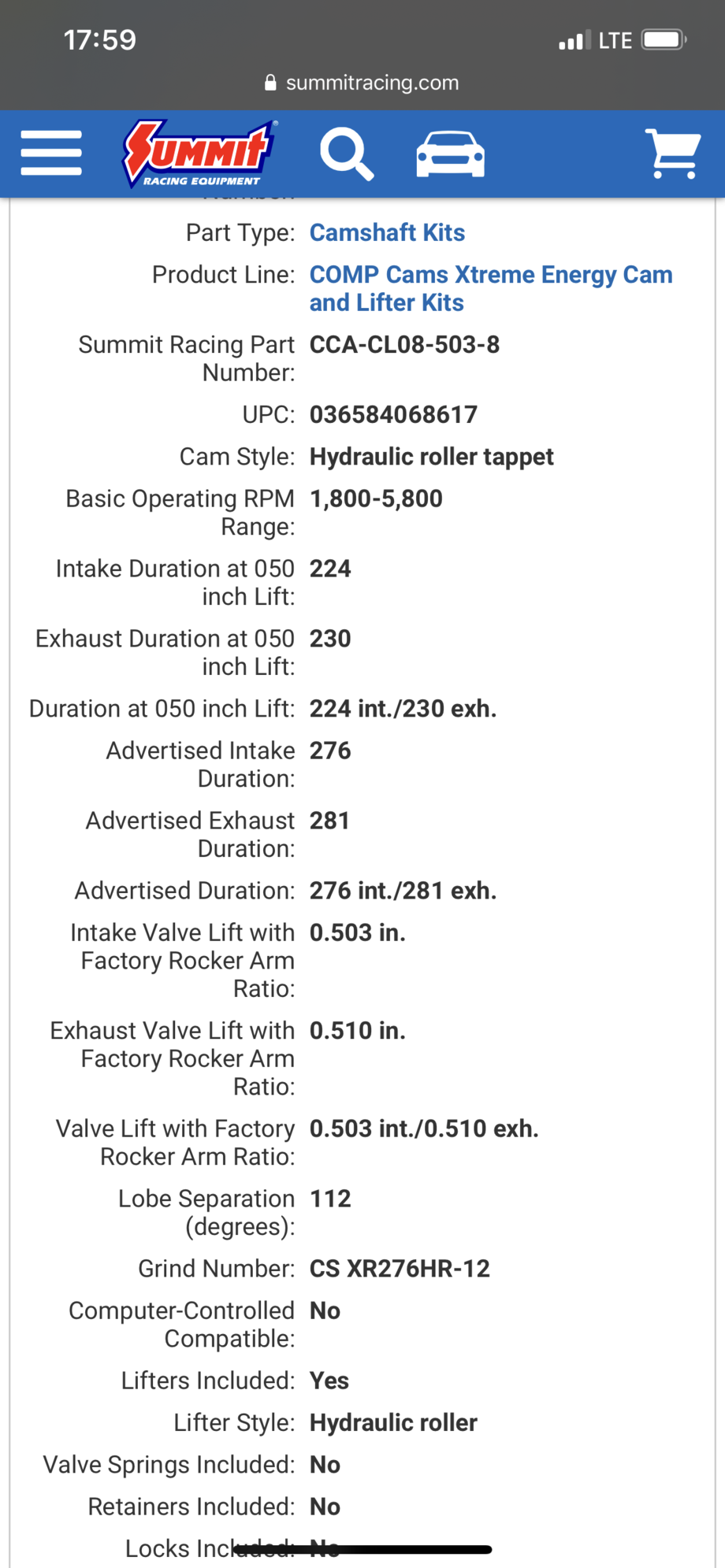

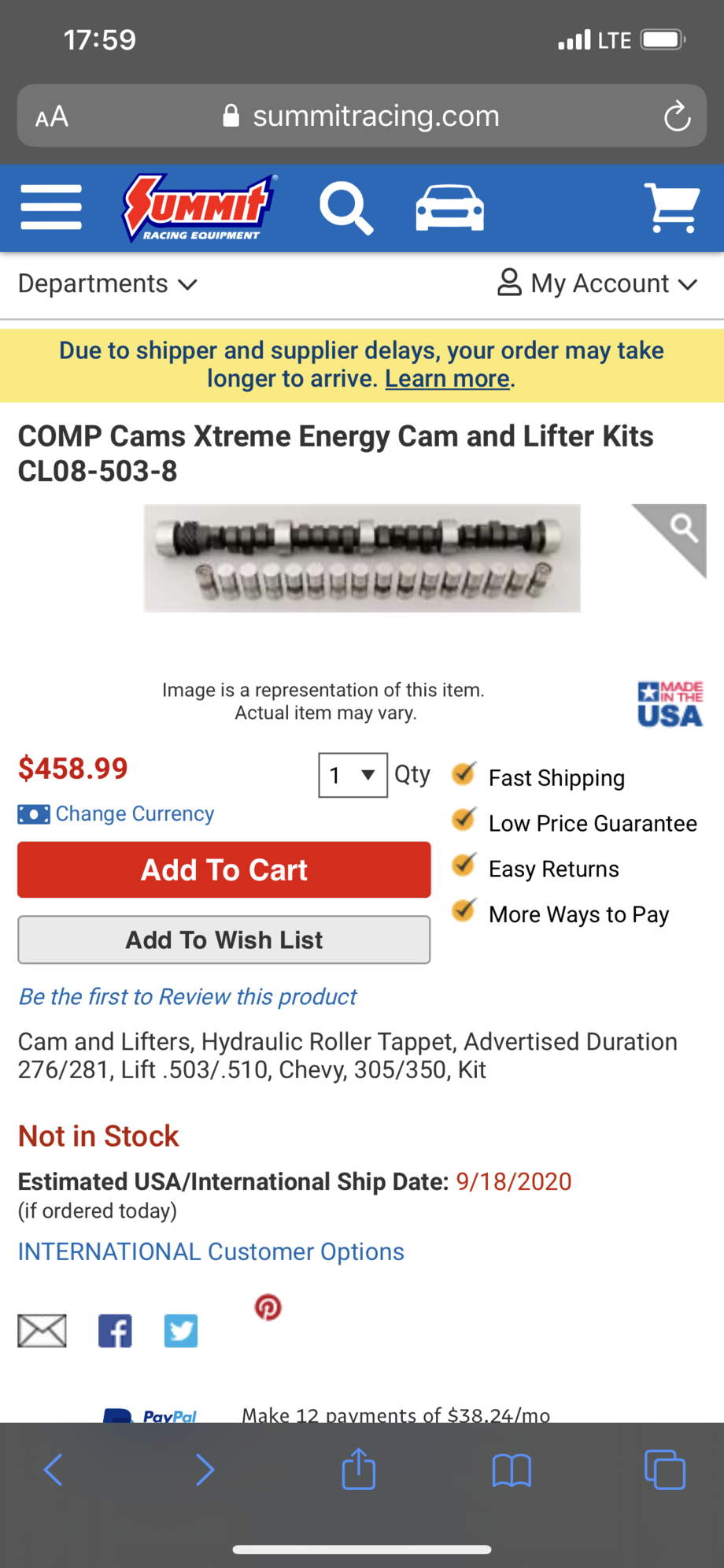

From what I’ve seen and read about a 224/230 seems like a pretty good option along with about a 112 LSA. It seems the CC 503 is a really good option and that’s likely what I’ll go with after some more studying and research. It looks like it’ll compliment the heads and Miniram pretty well.

Any last inputs from anyone?
Ive decided to go with the items listed below unless someone believes otherwise that it’s a bad idea.
