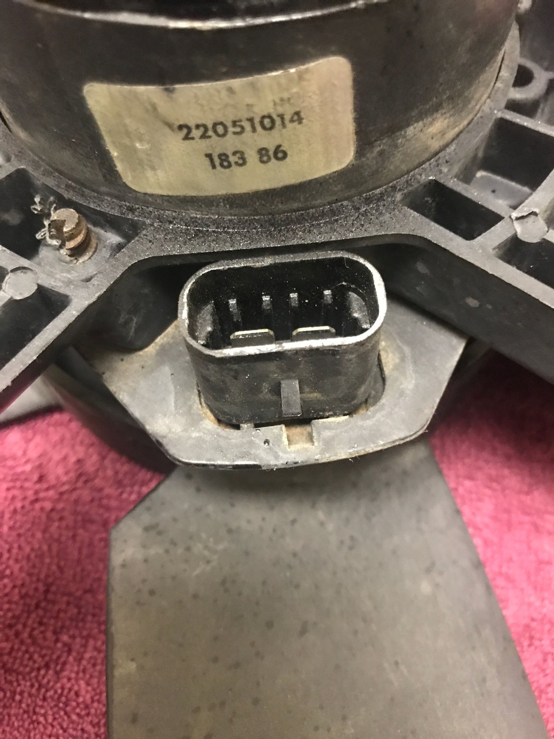

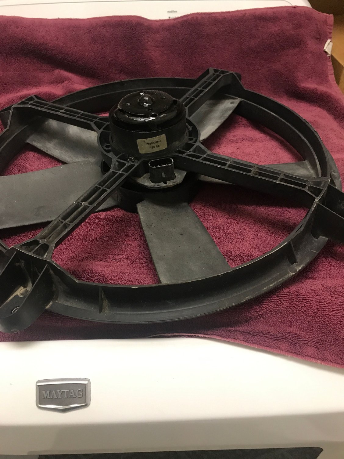

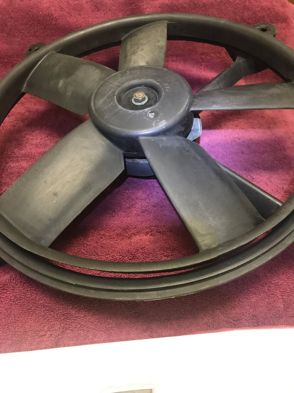

If you need it for some extra insurance, incase your fan quits, i have a cooling fan for $75 From an 86
Fan and shroud mount. Plug n play

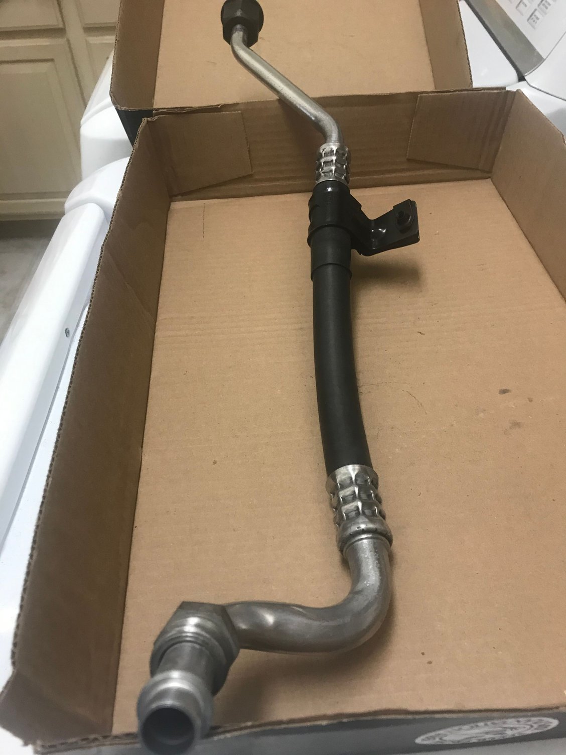

And incase you blow your hoses apart:
