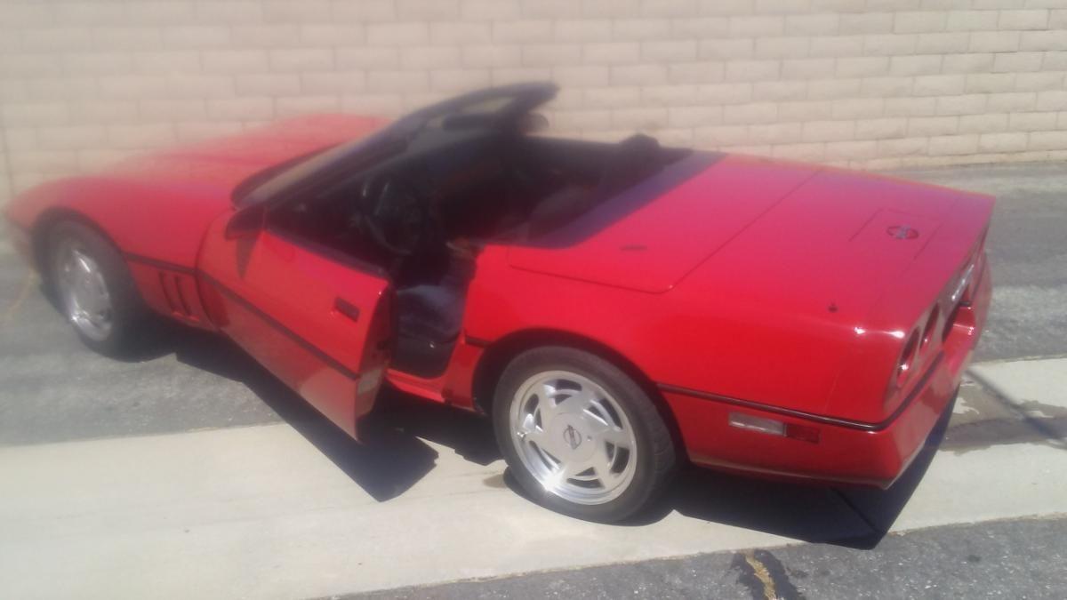

Compressor isnt big enough for a gun, no powercoaters within a long ways.
So rattle can (not my choice)
Wheels below...C4 just wanna freshen up its a driver
Truck is undergoing a full blown resto. May polish them not sure yet.
