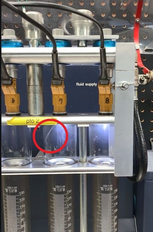

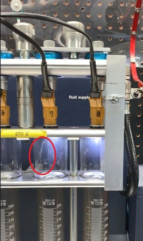

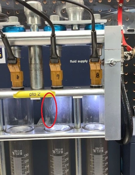

Update ! Solved.
One of my NEW Bosch III injector from Corvettedepot.ca was Leaking !! I had them checked at a specialized shop today. One of them was leaking badly. I am thinking of uploading the video on Youtube and then post the link here. Not sure if this is allowed though.
So, I tried to solved my issue with the original leaky injectors with brand new ones but the new ones had a leaky one too !!! How fun is that !
Fortunately, they owner of the shop just asked me 15$ for this verification which was too sweet from him since he normaly charges 35$ per injector to fully test them. I tried to call Corvettedepot today but I only have been able to leave a message.
I am happy to have rightly diagnosed the problem but at the same time I am frustrated by this lack of quality.
I would STRONGLY suggest to have your new injector tested before installing them on your car. With a repair that will take you hours to perform, you better make sure that the parts are good. Or you risk to do it again like I did. /%/?$""
Here are some pics from the video. The faulty one is # 7. The light was burnt on the tester for # 6.
Leak with pressure on 1
Leak with pressure 2
Leak while running
