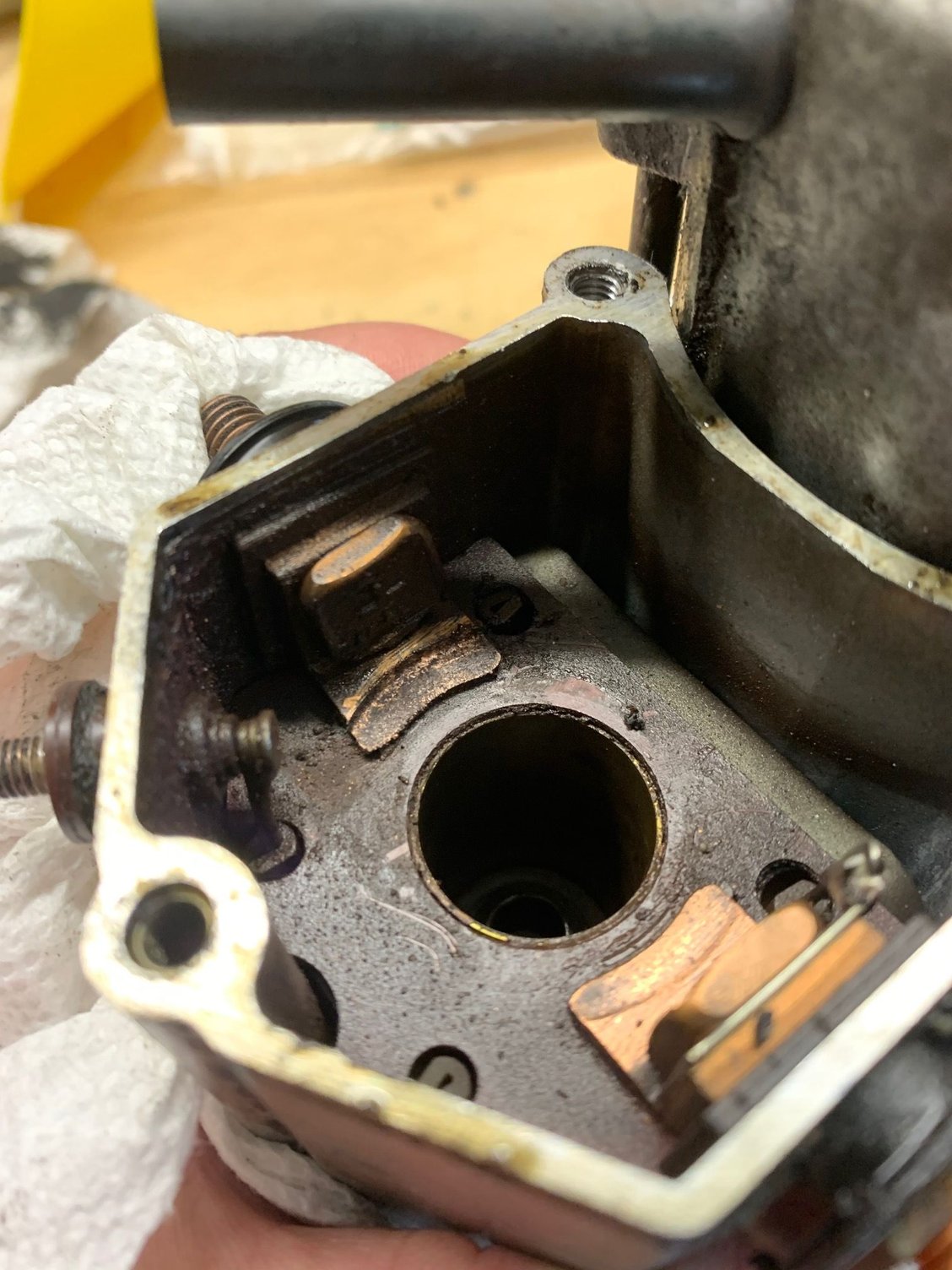

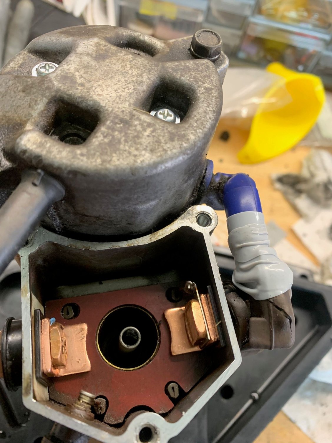

Do you hear one single click from the starter when you try it? If so, it might be the solenoid contacts. Just replaced them on my son's 90. Was a cheap and easy fix, if that's your problem. Here's what the before/after of the solenoid contacts looked like. The big step in the "before" picture was just wear over time from impact and arcing eroding away the material until the plunger no longer made contact. Before failing completely, his would also work sometimes if he tried cranking enough. It was just happening when the motion internally caused the plunger to line up just right such that good contact material on all surfaces could touch.
