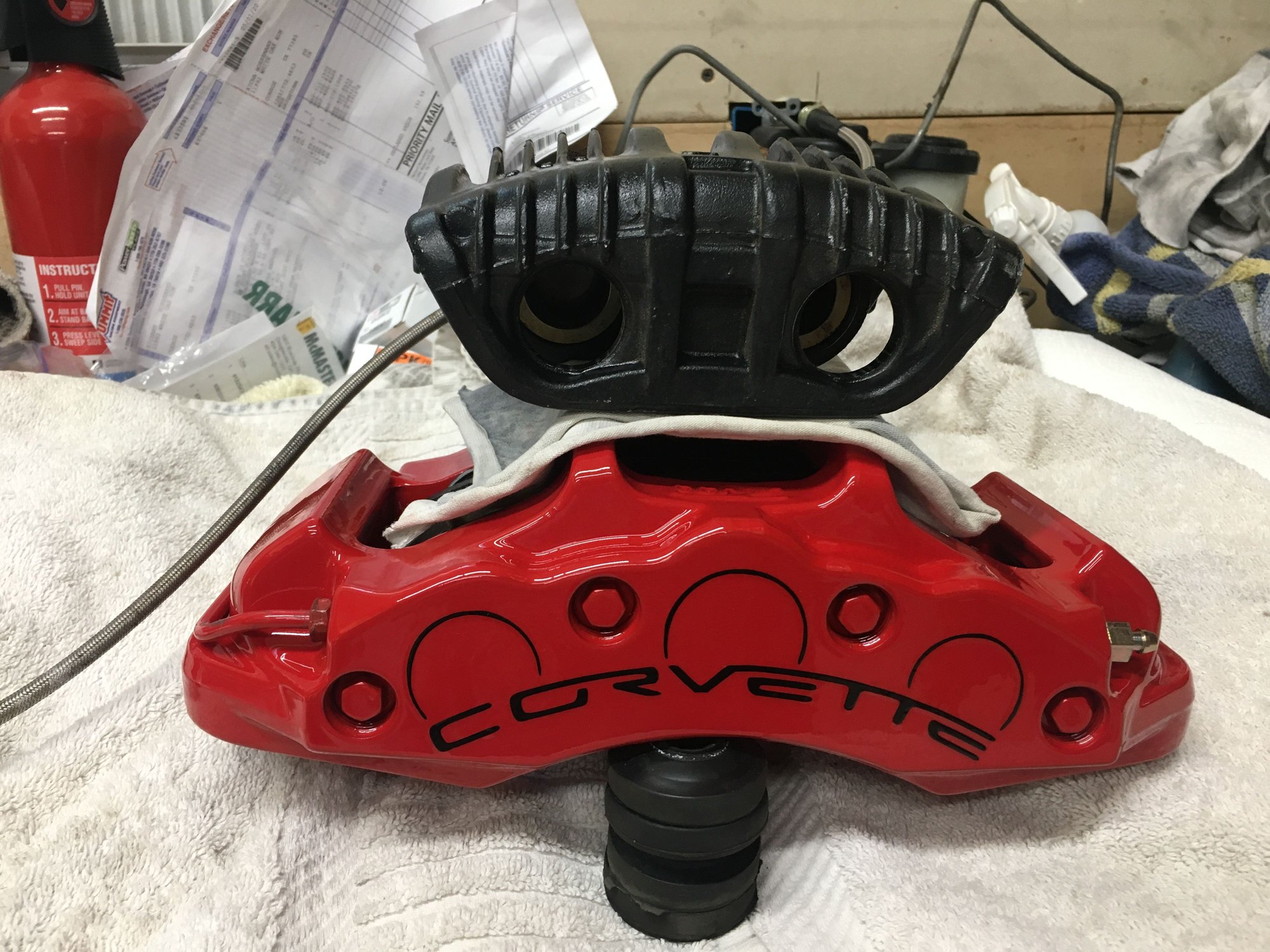

i just completed installing c6 z06 brakes on my 91. some of it was just purchasing the correct parts and some was doing some head/*** scratching and modifying, but it is doable. what i need to do to finish up is fabricating a e-brake cable and getting a pair of wheels to clear the front calipers and the fenders. open the link from the member above and you will see some of the pitfalls along the way.
c6 z06 caliper compared to the c4 z51 caliper
c6 z06 caliper and rotor
another view

SpedRacr93- Thanks for the advice, the C7 brakes I have were basically free so that's why I was considering doing that swap but was just leary with so little parts and support out there especially compared to doing a C5 or even C6 Z06 swap. I do have a set of C6 base brakes that maybe I should do instead.
Sleazy Rider - Great pics thx!!
Love the way the Z06 calipers look, bigger is better definitely applies to brakes!
