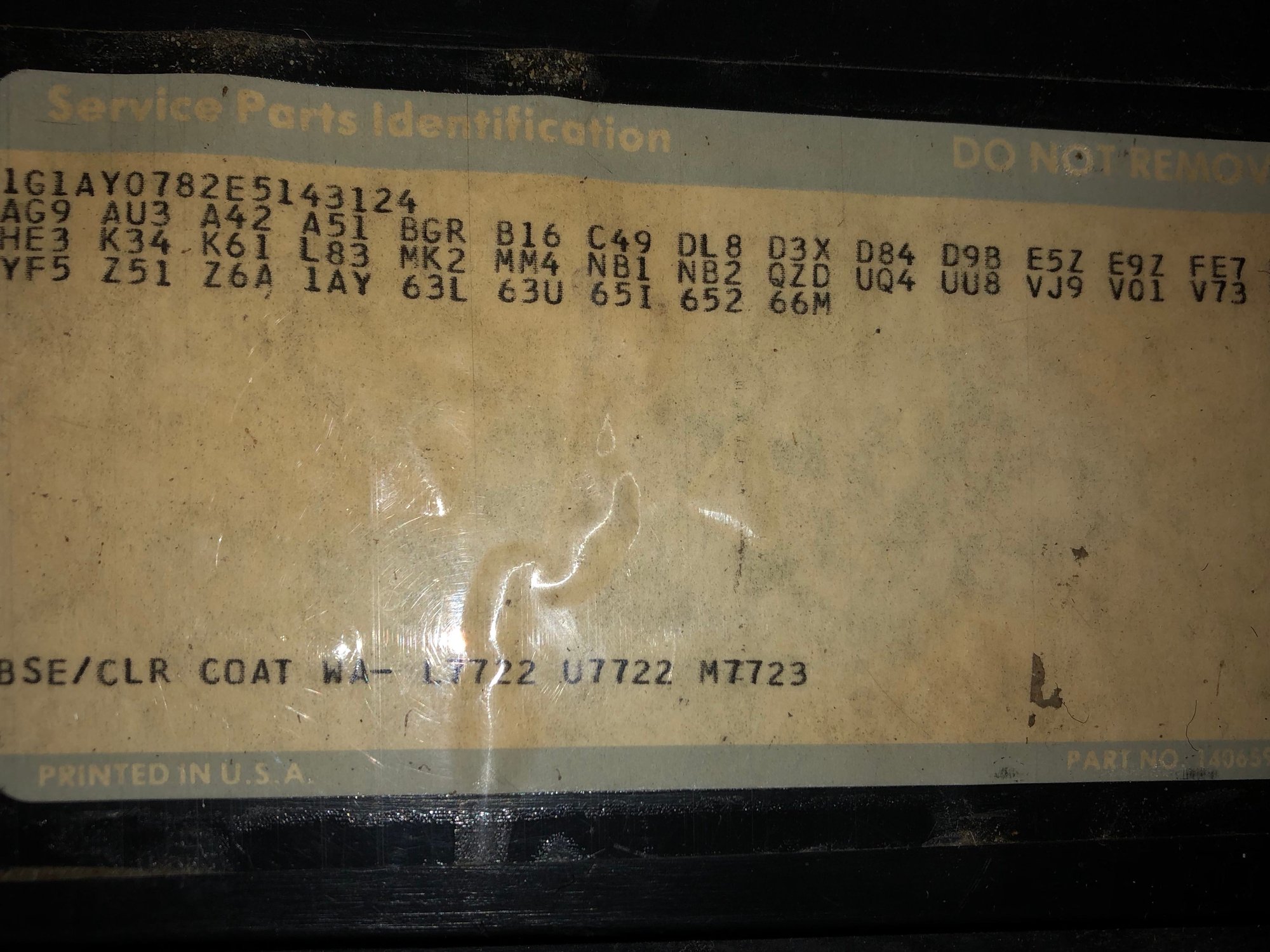

It shows it on the service parts identification sticker
This is mine

The RPO codes are listed on a sticker, usually inside the center console lid or the drivers' side rear compartment.
