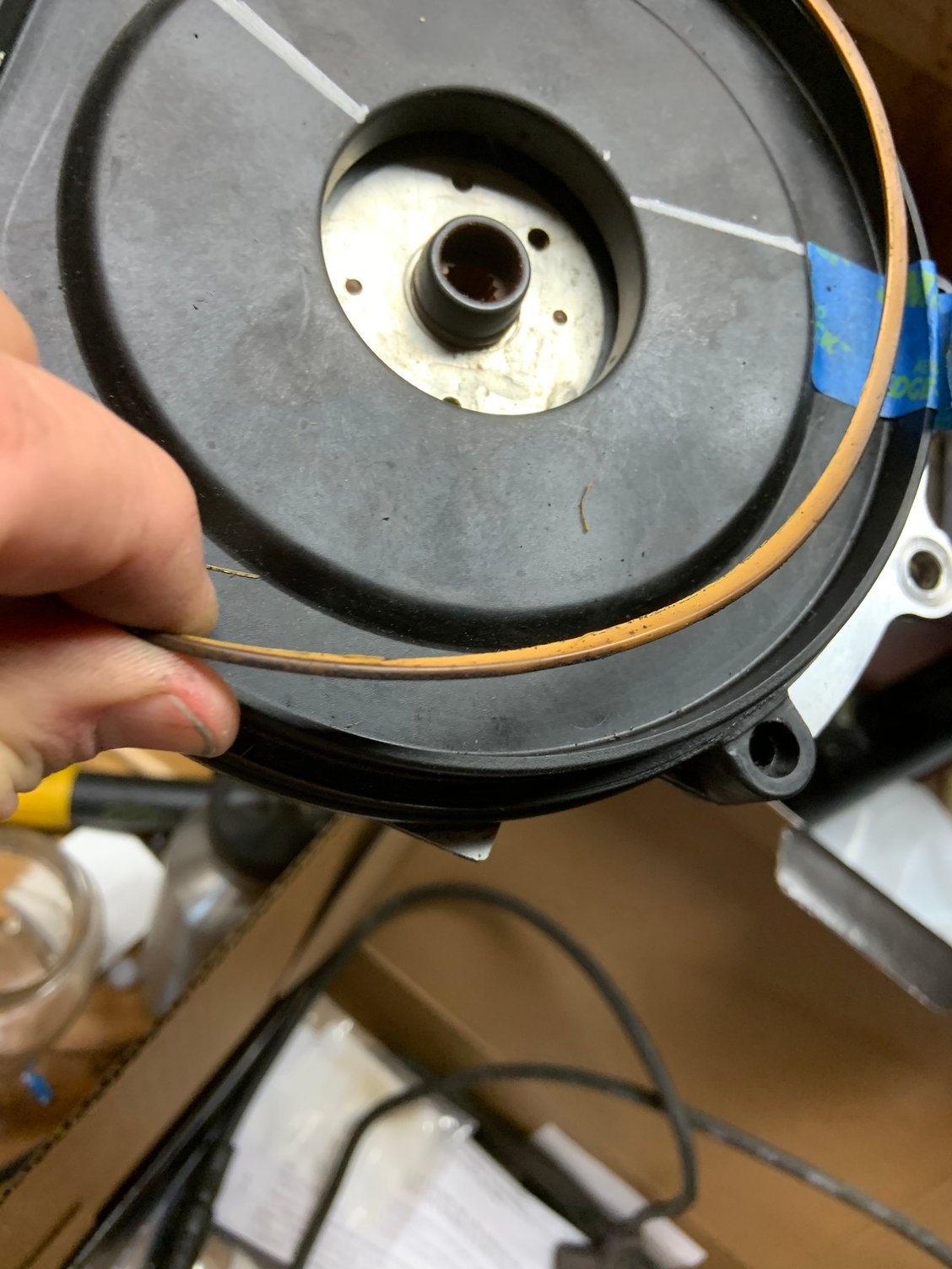

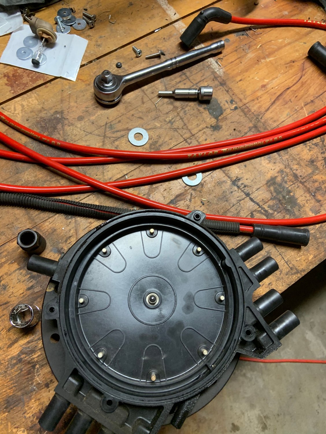

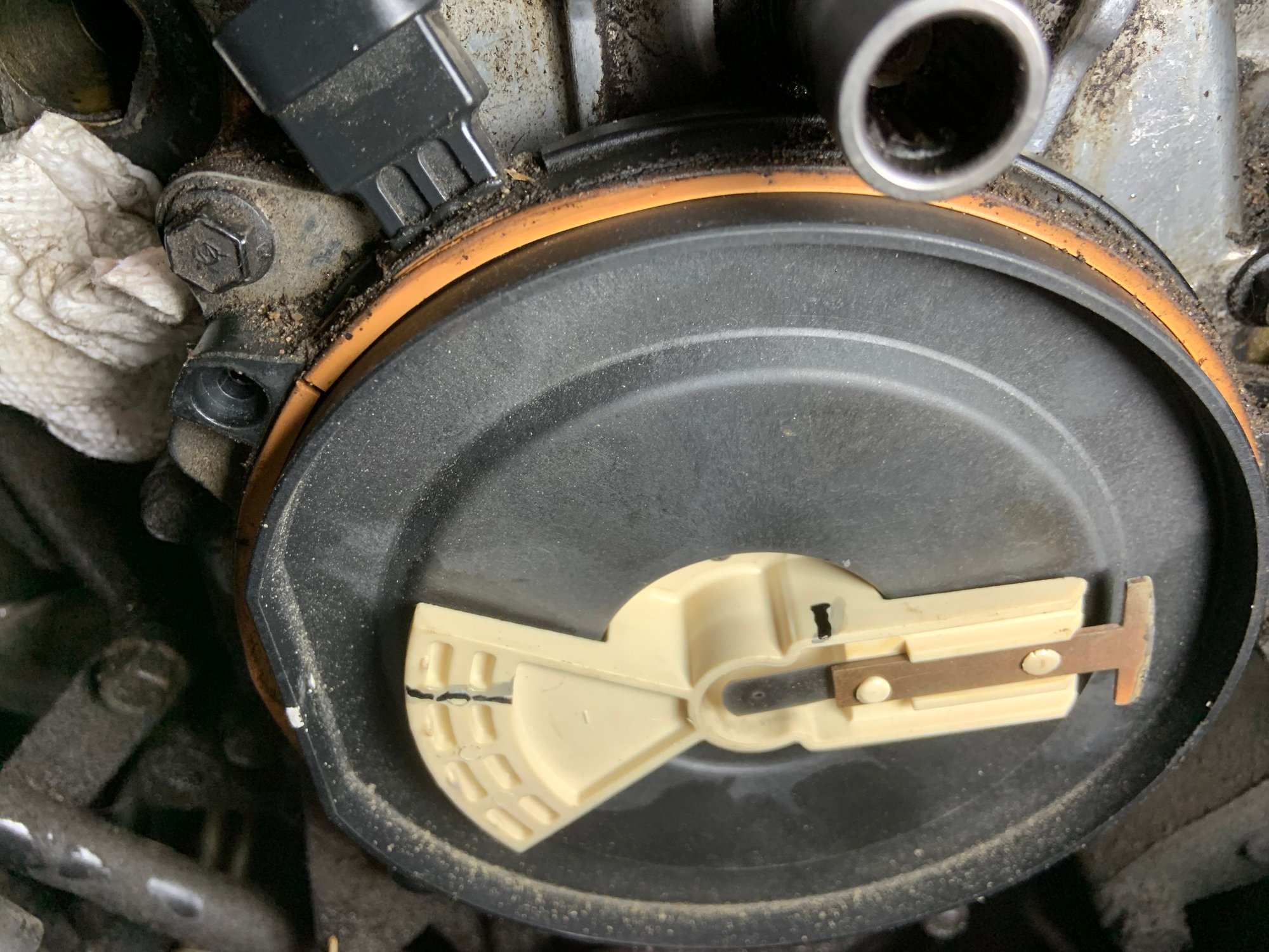

Obviously, I've little idea what an orgonal would look like, but this is what's in there...
The inside of the cap looks great--clearly only 2100 miles on it (probably being over cautious in pulling it). You can see there was indeed a vent tube out the bottom--but it wasn't hooked up. I can't find any part numbers on the unit, so now I assume its not OME. Does anyone know who makes these yellow cap'd opti's?
Rotor looks good too

good so far. The tan caps were back from when they made quality units
whats under that rotor?
underneath there you should find a reluctor wheel (hopefully clean)
then the sensor. It has a mitsubishi symbol - thats what you want to see

Well, now I'm back to thinking this is OME. Aside from the rotor screws being those annoying little torque head screws, which appear to be OME all over these distributors, the dis The optical base is a single, press-fit unit. There is no "cover" that-- as I have seen on many videos--pops off to reveal the internals (thus I can't look for that prized Mitsubishi emblem). There's no way I'm gonna start prying on this thing. Everything so far looks great--so when the new rotor comes, I'll just button it up from here.
Then the dreaded plug and wire change. I'm already just perplexed by #8...
