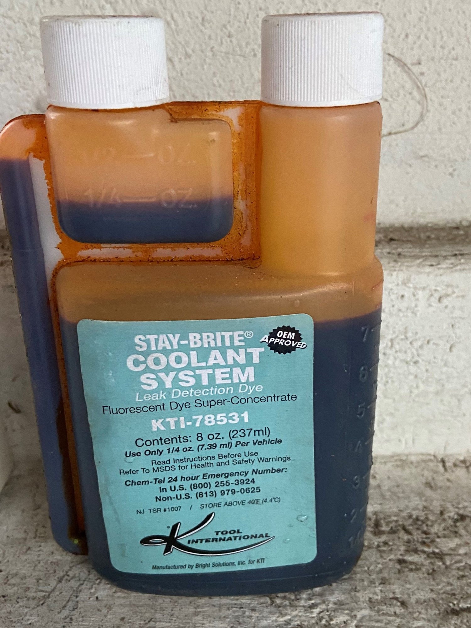

Pick up coolant dye, I have this, stuff is great very strong, don't even need a UV light for big drips, but use a UV light to see the small leaks.

I think it's autozone that will lend out things like the tester. Here's a tip if you use something like the yellow/green Prestone antifreeze. It will Flores under black light, which can be used for looking for indications of a leak. Pressure testing is a good way to tell if you have a leak but won't tell where it's at.
