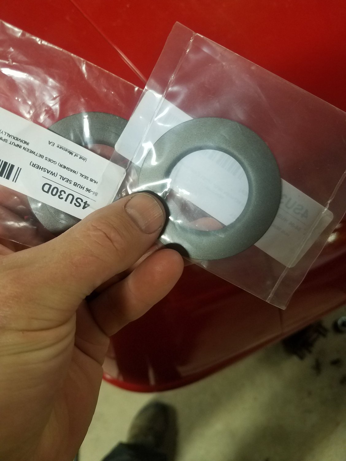

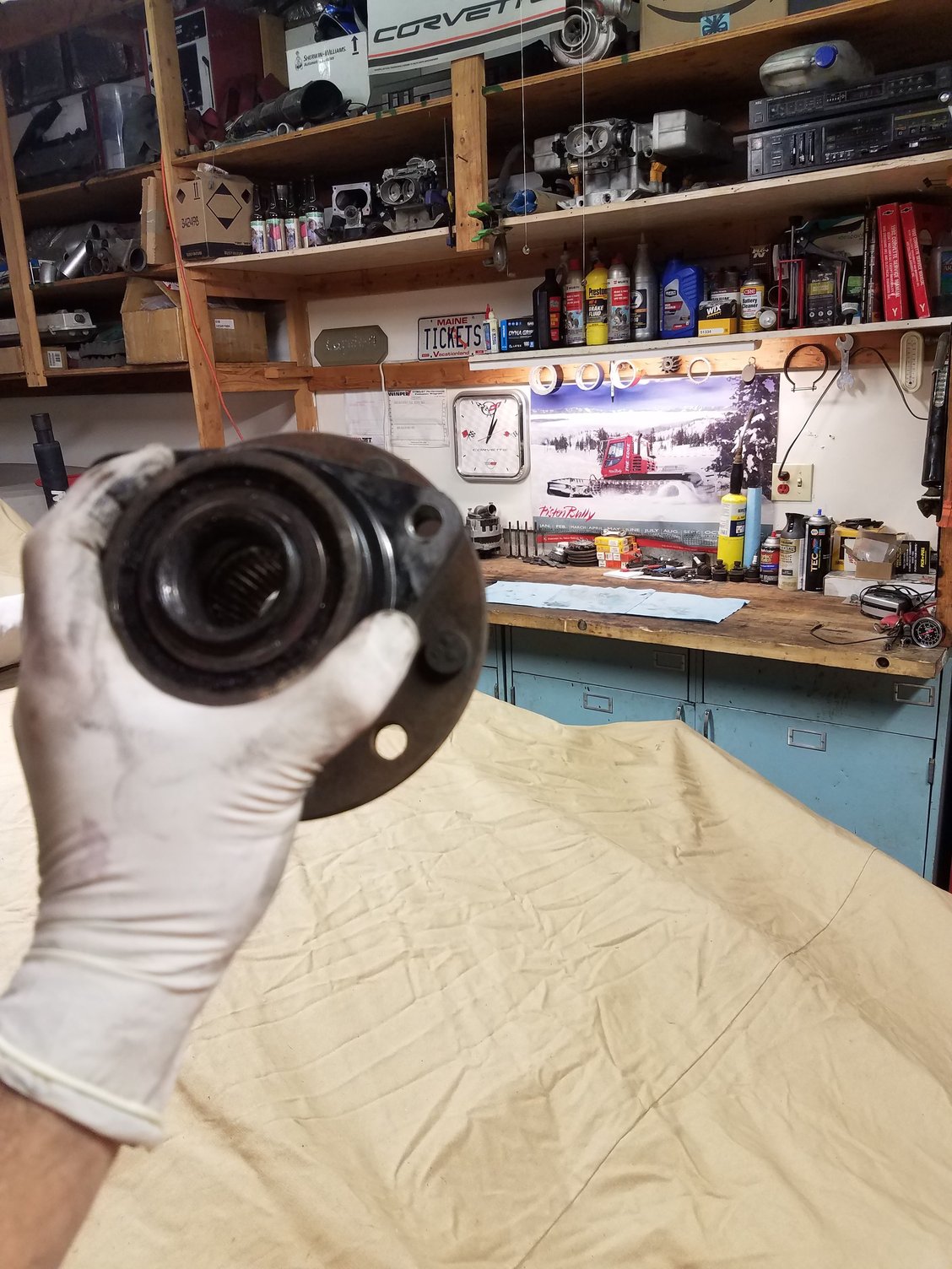

My memory was on point. SKF:
I had the bearing out in ~20 minutes and was hoping to have the thing done in ~an hour....but it completely tore up the "teflon" washer....so I need to order a couple of those. . Now the car will sit for a couple days.

Quote: ....I had the bearing out in ~20 minutes and was hoping to have the thing done in ~an hour....
You do good work. I have done it a bunch of times and it takes me about 1.5 hours.
Glad you could find the teflon washers. I had heard they were getting hard to find. Hope yours come in soon so it isn't down as long.

Quote: Glad you could find the teflon washers. I had heard they were getting hard to find. Hope yours come in soon so it isn't down as long.
Good luck.
Thanks! We'll see. I actually ordered a pair from two different places -neither said they were out of stock but neither said they had 'em, either. I'll likely call them tomorrow to either confirm or cancel the order(s).

Check the condition of the "NEW" teflon washers. I'd swear the one's I received were used and recoated.

Thanks! Will do, for sure.

Quote: Check the condition of the "NEW" teflon washers. I'd swear the one's I received were used and recoated.
Check out the following thread. It is pretty common that they don't look that great.
https://www.corvetteforum.com/forums...g-scrappy.html
My post is post 9 in that thread that shows some pictures of mine. The used ones look much worse (and mine were not making noise yet)
There was a post a while backs(years) making that same claim. I’ll see if I can find it.
Found it. https://www.corvetteforum.com/forums...n-washers.html

I'm pretty happy to say that volunteer Vette products came through. Washers arrived today. Never even heard of those guys before but I have to say, they're all right.

Is there any way to dismantle the hubs (in a non destructive fashion)? It would be interesting to see if a replacement bearing could be fitted inside.

The C4 bearings get destroyed when taken apart. Years ago I believe someone on the forum took one apart.
