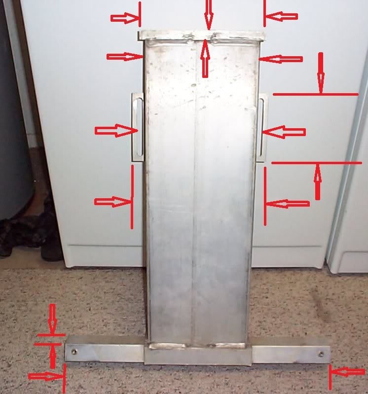

Here is one of the pics to start getting an idea of how to dimension. If I get a commitment to provide the measurements, I will go through all the views to make sure that we have what is needed for someone to fab one up
you can find the centerline of the slots by taking the outside measurement of the slots and subtracting the width of 1 slot. so we would need the width of the slot plus the outside dimension
etc etc
sorry the arrows are not perfectly in line, just was working in paint
etc etc
I haven't forgotten about this, just been busy as snot lately. I should have time in the next week or so to either take pics with a tape measure or make a drawing with the measurements attached.
Jim
I didn't think you had. I have all the pictures downloaded. As I said, I will commit to showing every where and how we need a dimension, as long as you do the measuring.
That should be fair to us both.

Not sure if this has been discussed, but what about thickness of the material used to make this? Does it matter much, or is there an industry standard?
Maybe weigh the box?
Old Oct 21, 2020 | 05:55 AM
  #54
drcook's Avatar
drcook
Joined: Apr 2016
Posts: 4,648
Likes: 1,059
From: N.E. Ohio OH
Finalist 2020 C4 of the Year - Modified
At least the same thickness as the smaller lateral piece is. Looks like the ends are open and can be measured.
etc etc
Any progress on this endeavor? Did you ever aquire all the dimensions/measurements/thickness(gauge) of the pieces!? Haven't forgotten about this thread and have been considering this mod more and more!👍

Nope, had surgery in December and a couple other orthopedic issues since. Ortho issues are my cross to bear, but you don't die from them or sit there drooling and messing yourself.
If I could get a commitment, help from different folks we could make it a group project. The picture above illustrates how we need to get it dimensioned.

FWIW the rear bar is not square to the main body. It is mounted at an angle and has an interesting sleeve thing to make it mate to the square main body. Also, the main body is fully sealed. Someone would have to sacrifice one to find the actual aluminum sheet thickness.
