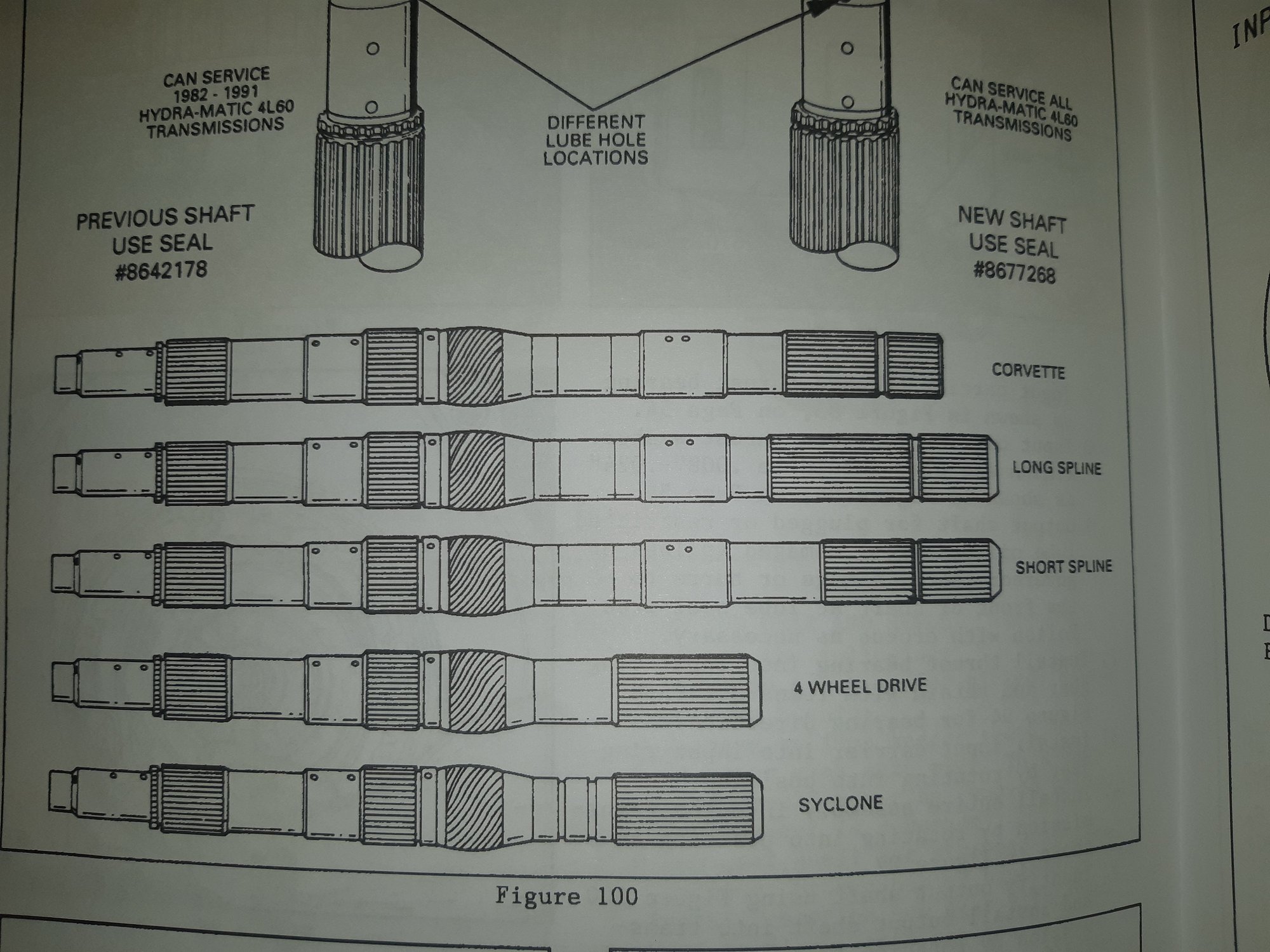

Other question...What is the difference between a vette 700 and others? I know the rear of it where it bolts to c-beam is different, but is that it?

As for the transmission differences, corvette has a tail housing for the c beam.
I heard early on that the output shaft was shorter, but others have debunked it.
