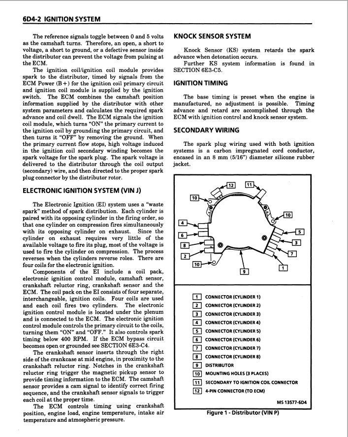

Does anybody have a link to a writeup on how to do a compression test on the LT1? The book mentions some things I don't understand. Is it the same as any car? How do I handle the optispark? Thanks!
The things from the book were what does it mean by
"remove the "BAT" terminal and four terminal connectors from the optispark".

Looks like items 11 and 12 in the illustration

It's the same as any car. Don't really need to do a wet (oil added) test. If it has poor compression, adding oil isn't fixing the problem.
Remove all the plugs. Disconnect the opti harness under the left injector cover. Hold throttle wide open. Crank. Write down the numbers. Look for less that 10% variation.
