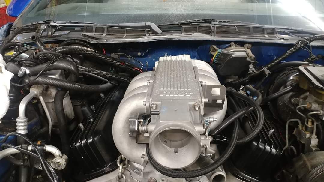

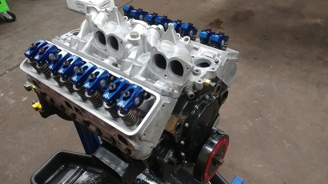

This a 383 stroker fully forged motor lpe219 cam d port 113 heads heavily ported and polished with a first performance intake im.sure it can go to 5800 or so car ran a 12.3 at 109.8 with a 1.6 60ft all on stock shift points hense why I want it to shift higher im.thinking it has more in it.. no dyno numbers but track tells alot. This is all controlled by a holley hp efi system

I agree with your assessment. If you hold it in a gear, say either first or second, does it continue to pull strong up to 5800 or fall off at a specific rpm? If it keeps pulling to 5800 your only option may be to control your shift points manually. If that does not help your option may be experimenting with the governor weights as arbee pointed out.
Strong times as it is, but I always like to see dyno numbers to know exactly what the engine is doing at specific rpm points to know where to shift.
