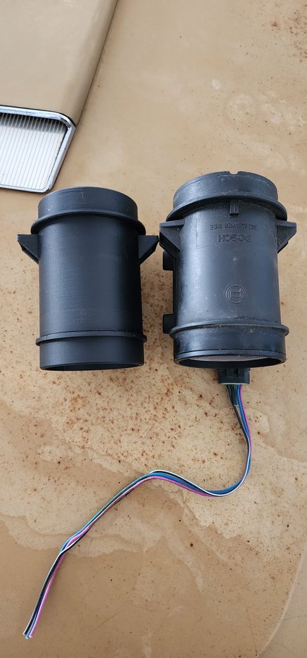

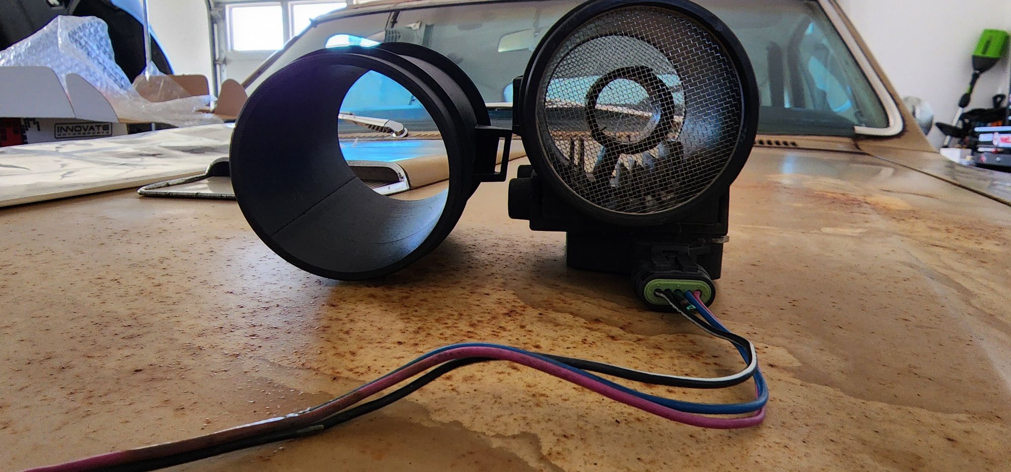

Figured I'd share what is basically a gutted MAF that you can 3D print for a couple of bucks for the folks running a speed density setup with the stock plumbing. It snaps right into place and uses the stock o-ring, a smidge tighter than stock, but that just maybe my printer. Still in the early tuning stages but I'll update this thread with HP gains if any.

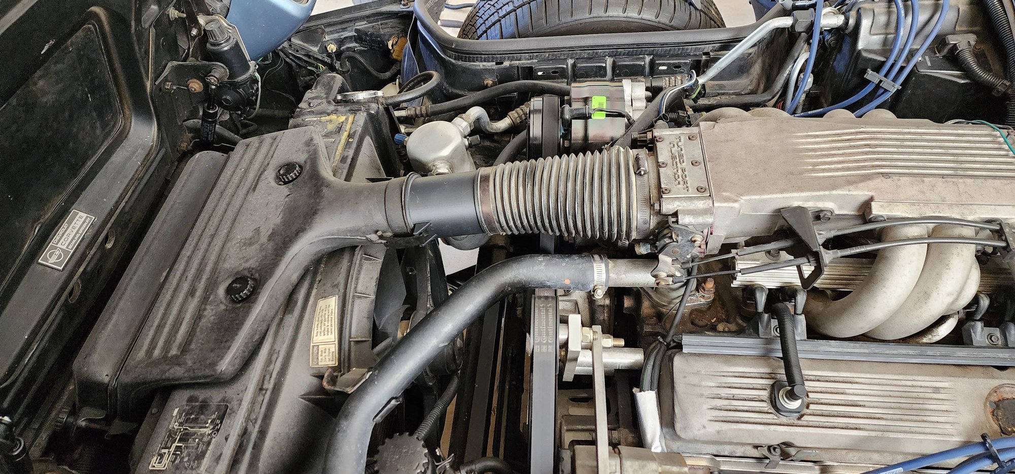

Just want to say that your design was a huge help. I wanted that OEM appearing look, without having to keep a $200 part on my car that is no longer needed. I used CraftCloud to have the part printed up. $55 to my door in less than 2 weeks. It fits perfect and looks stock.

I will admit, this is my first time using a 3d printed part and I wasn't sure what material would be best. I went with Carbon Fiber PLA. I guess I will find out how well it holds up in practice but for $50 I figure it was worth the risk to try it out.
Edit: I see cloudcraft also offers quotes for ABS which probably would have been a better choice as far as heat resistance but I don't think it would have turned out as nice visually as the carbon fiber PLA. It will be interesting to see how it holds up though. I'm just happy it fits.
