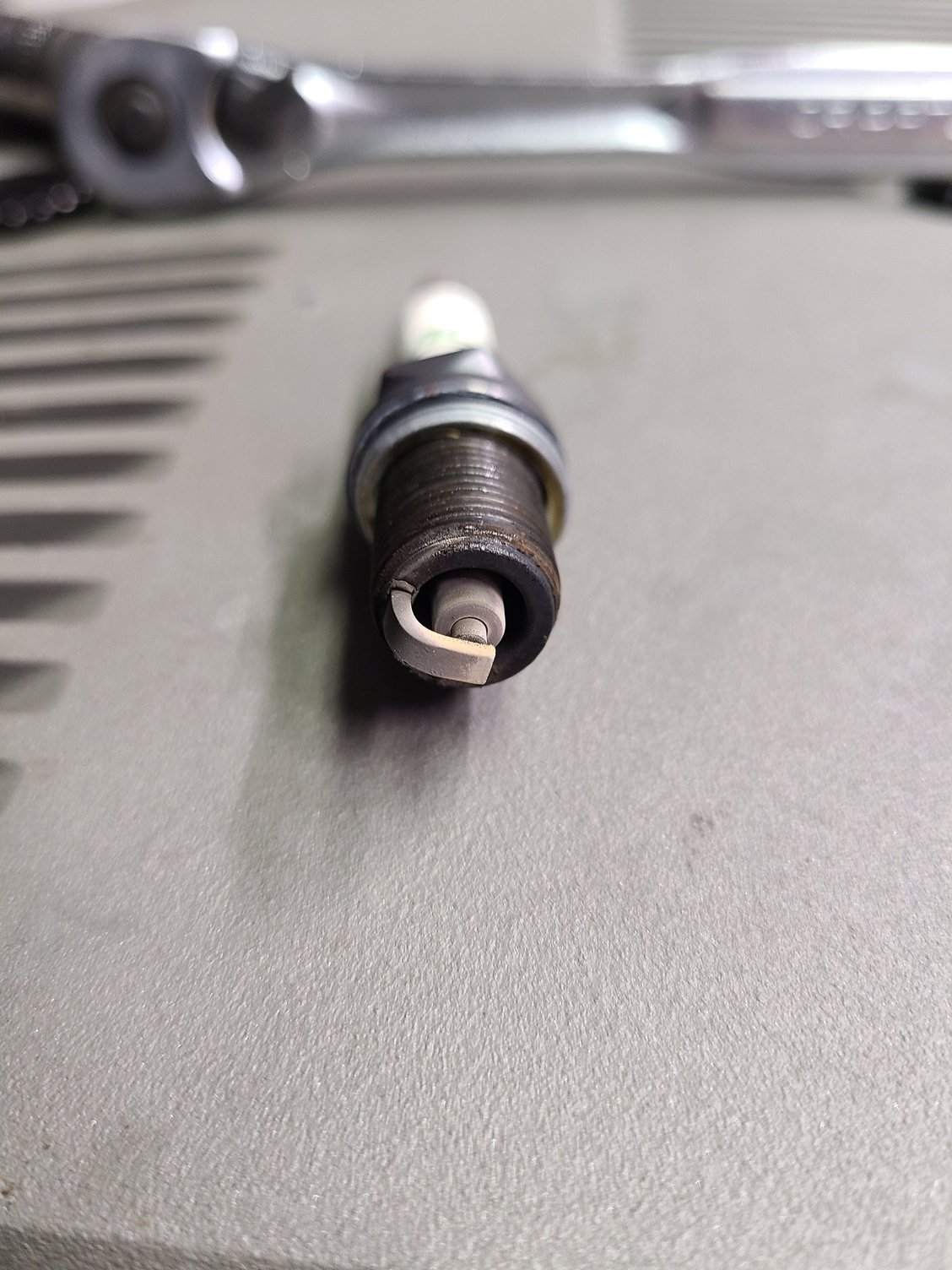

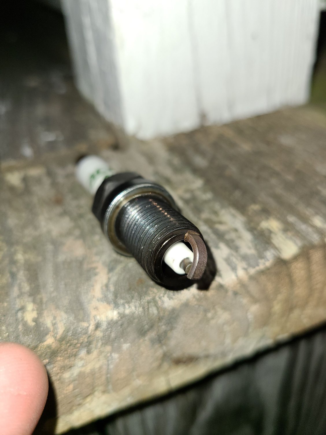

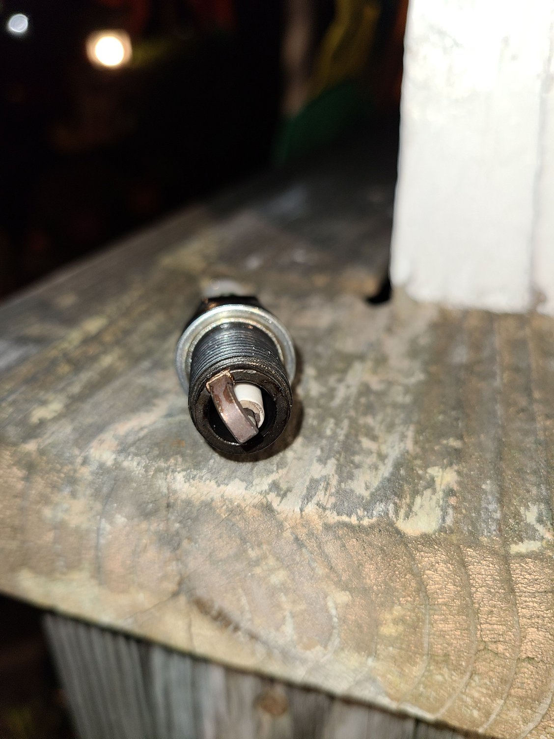

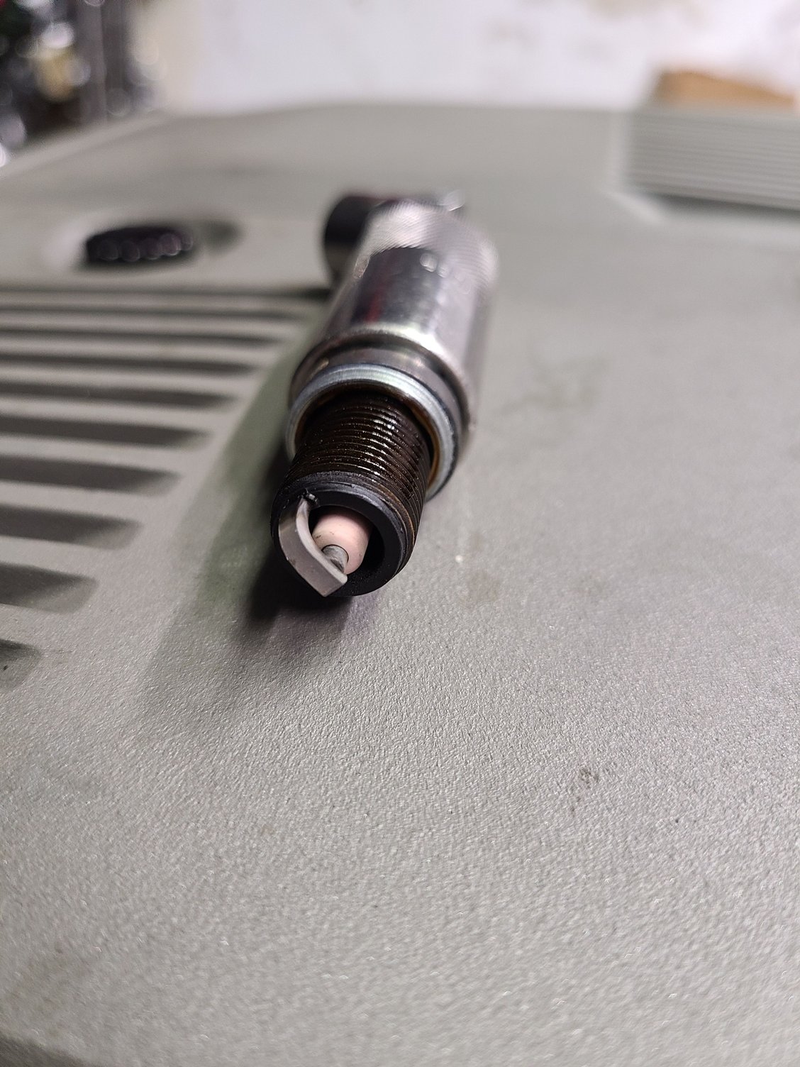

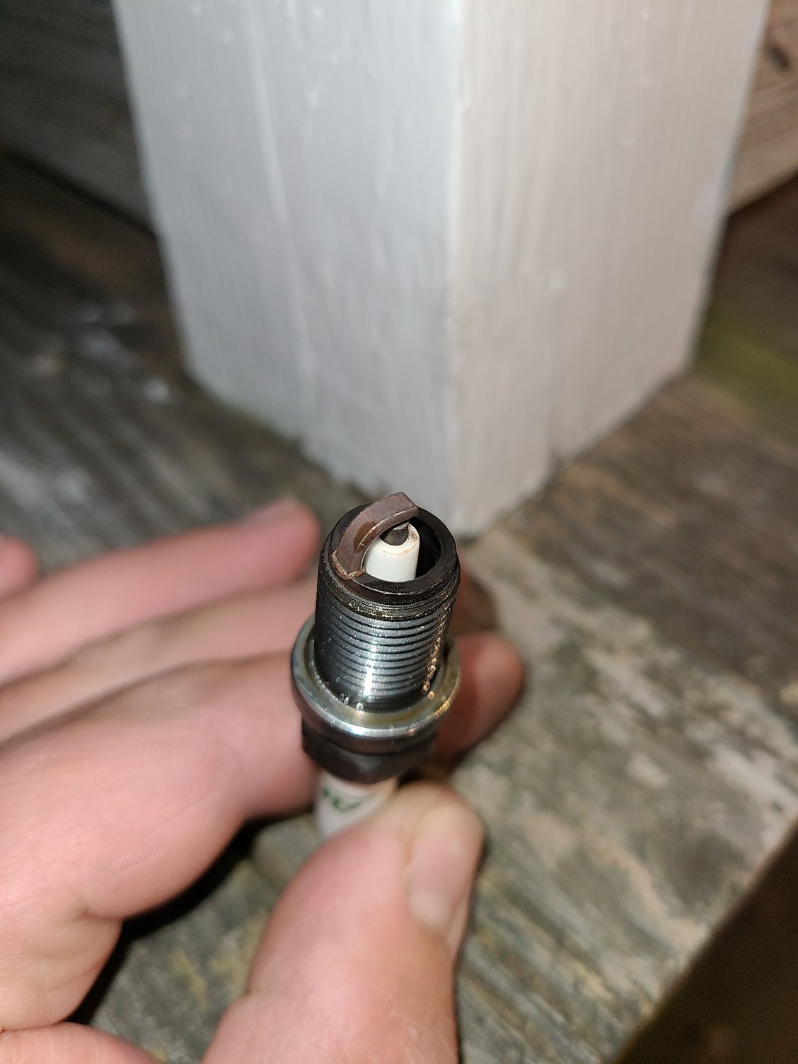

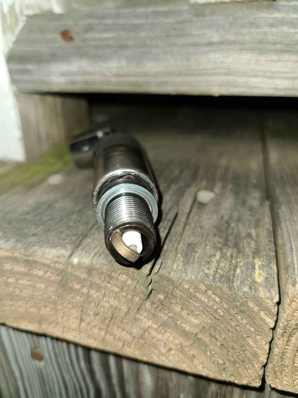

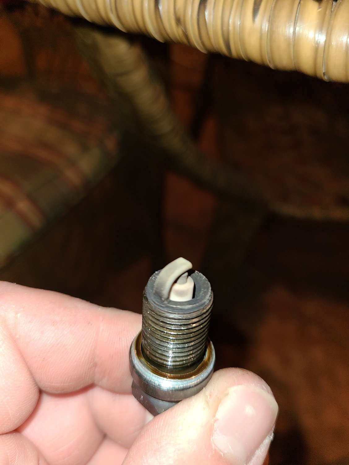

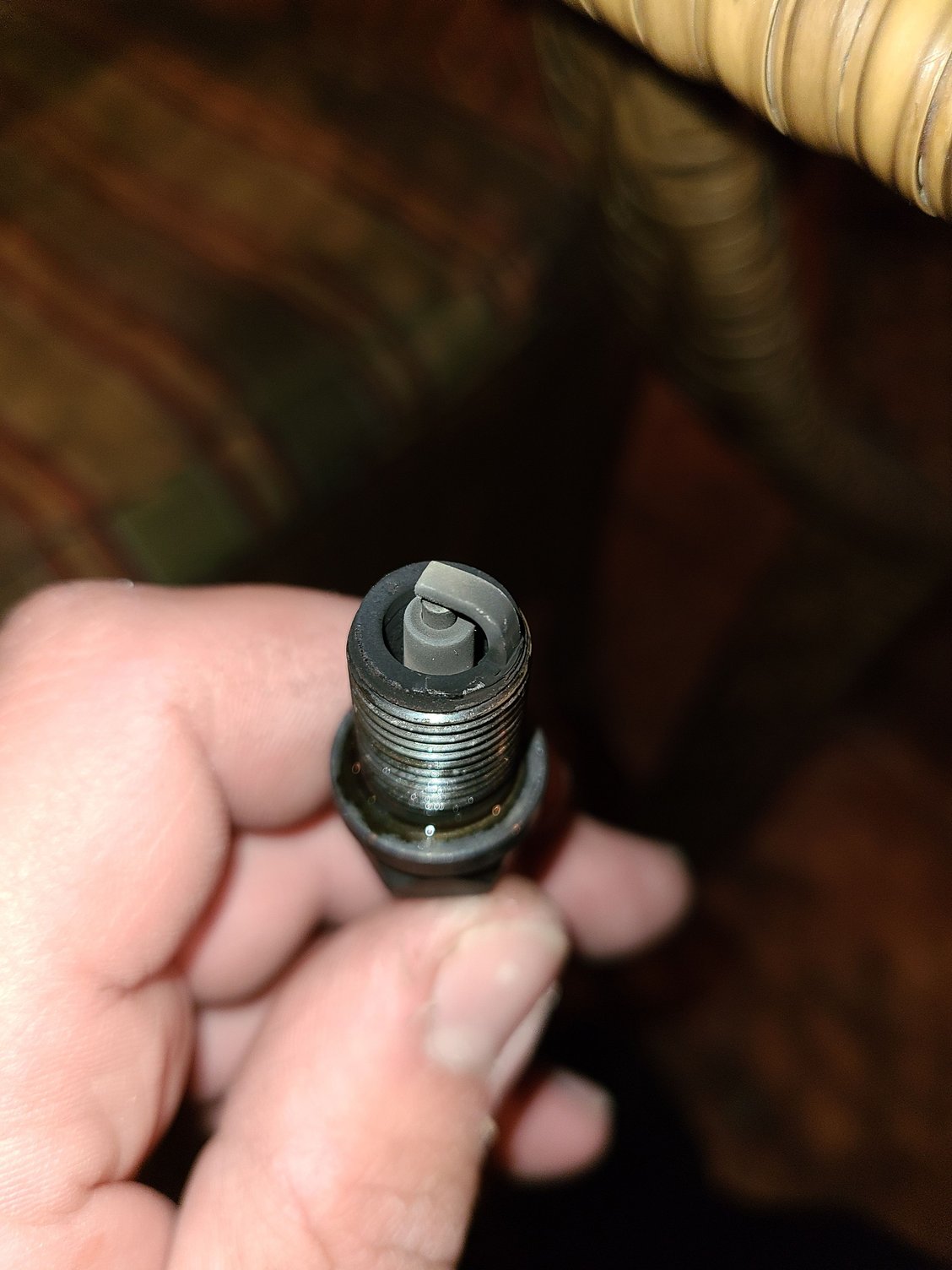

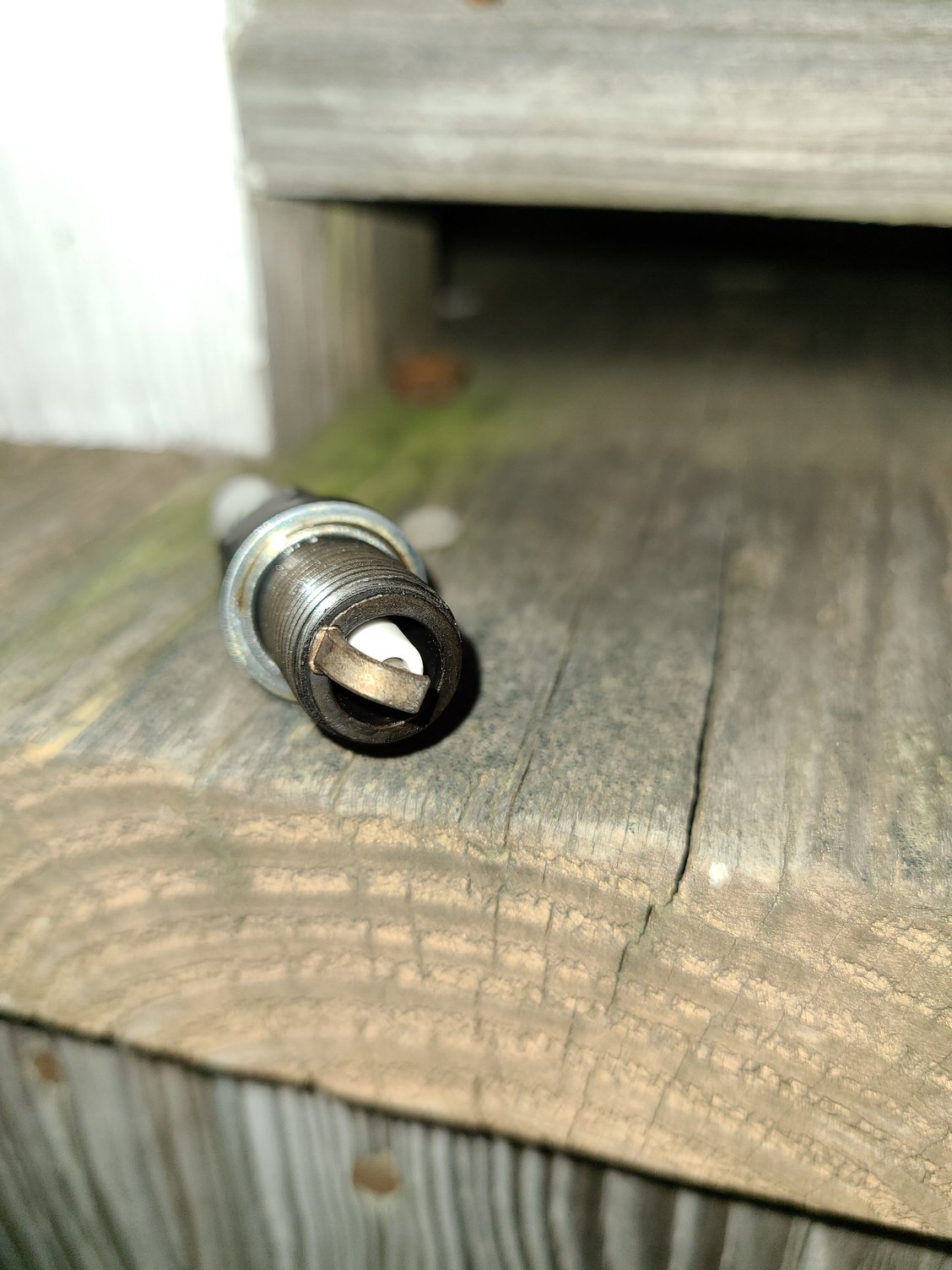

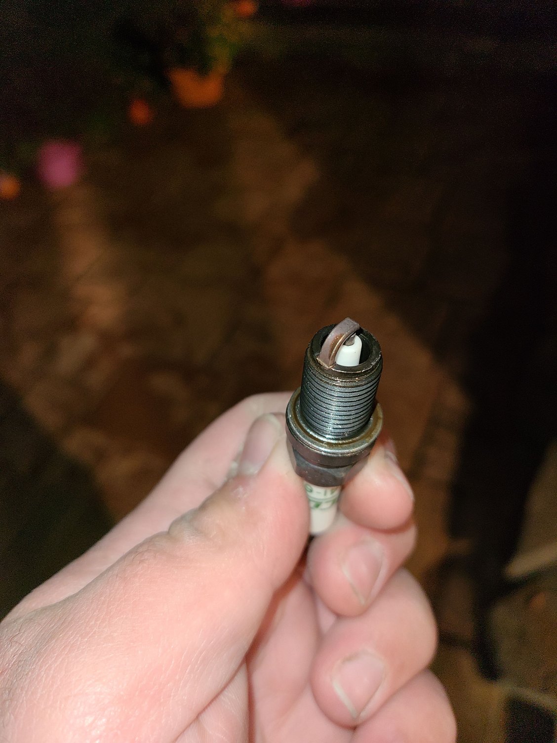

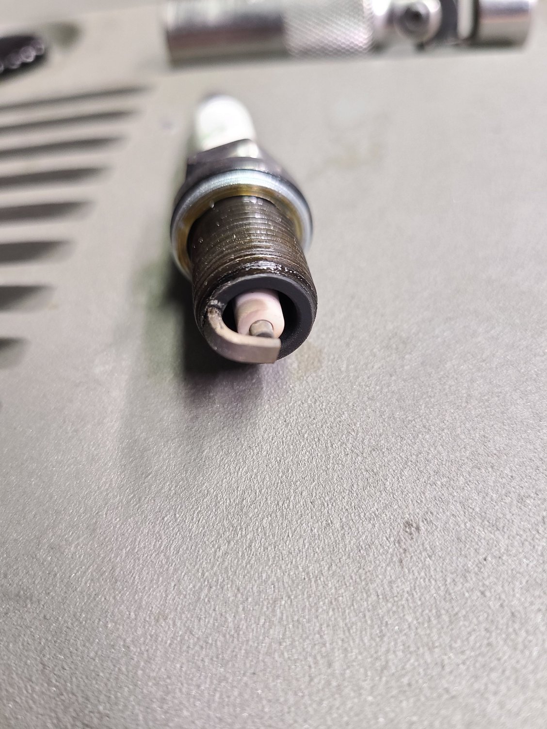

Info: car is running open loop, I am making tuning adjustments to check against the wide band and tables so I have it running a little rich. I am more concerned about heat range and such. According to what I see (idle commanded at 13.8) these look good except for 3. Photos are 1 3 5 7 in that order. I can't get to the other side in my garage right now but the other side has my wide band in it.
Not really sure what is up with 3. 1-5-7 all seem pretty even. 3 looks particularly rich. Wonder if its the egr hump in the intake doing something weird?
There was some idle time on these before I pulled them. Yes it isn't great running them for a bit but I figured it is better than nothing. More importantly it looks like the heat range and timing is safe. No detonation or the such and while fat, it isn't pig rich by any means...

I'm not familiar with the 84 but does the PVC dump into the intake near #3 intake port?
I changed the intake on my 86 and now the pvc dumps near #6 intake and so my #6 plug is darker than the rest.

PCV on mime comes in above 7. But the runner lqy out means the port is above the inlet for 6 and 8. My fuel pressure vacuum reference is however close. May have to check for seepage.

..... Heat range looks OK ... the color change should be about half way 'round the bend on the J-strap ... what cam , intake/injector size ?

So the consensus is 3 is dry fouling and 1 5 and 7 are okay?

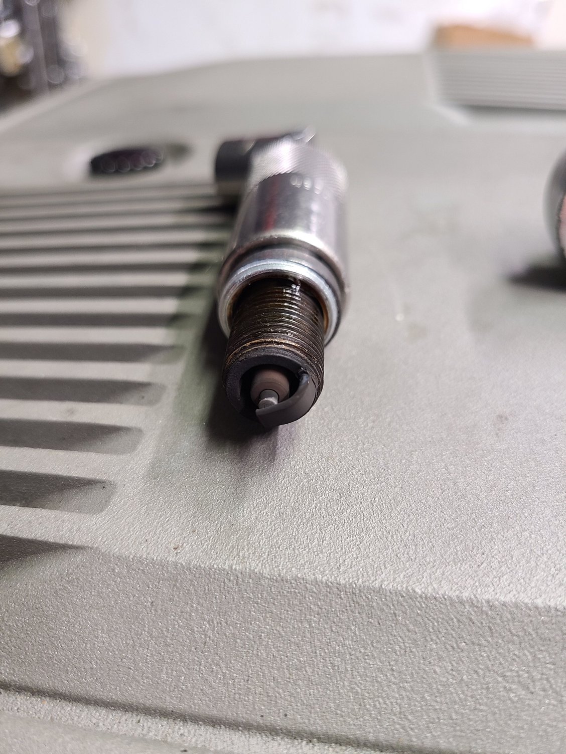

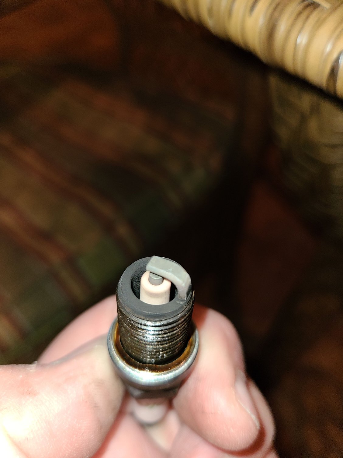

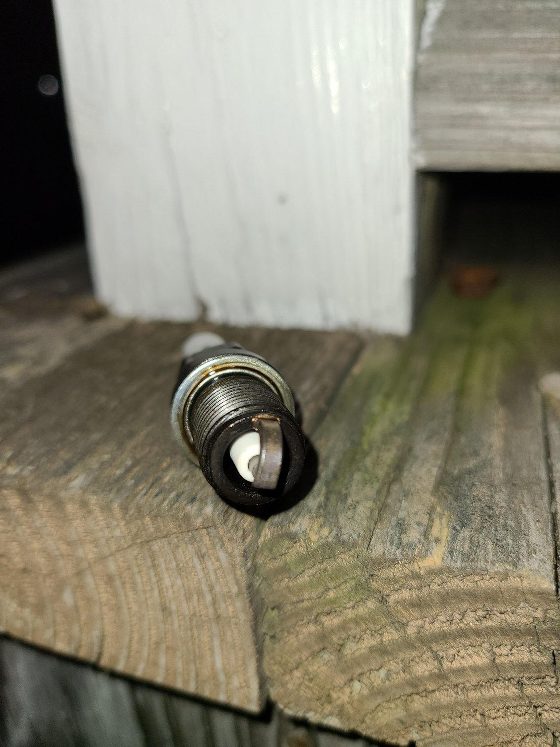

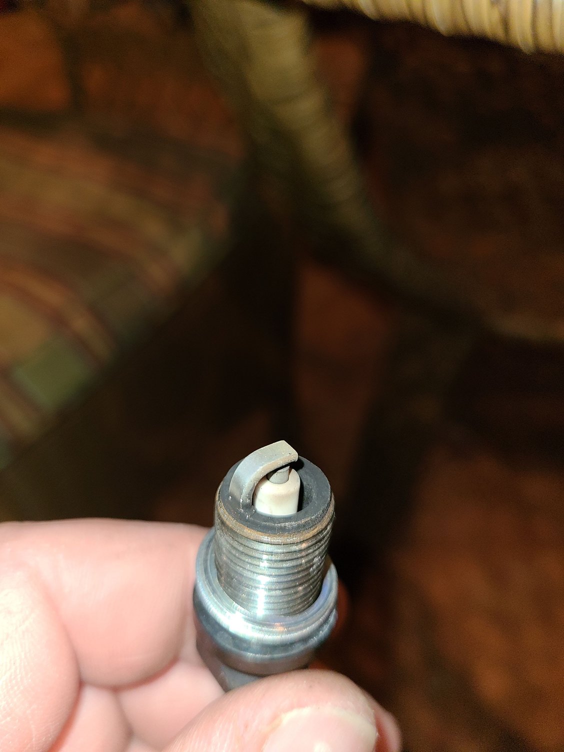

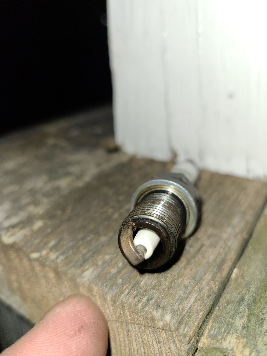

Pulled the other side. I'm thinking maybe one beat range cooler. In order: 2,4,6,8. I threw in fresh plugs and did 2 1/4 rips as well as a quick wot to my driveway and coast to keep them clean. So it should be more readable. Going to check the data log now.

1357 2468
they look good and even. I backed the wot afr down to 12.6 from 12.8 just to be safe.
