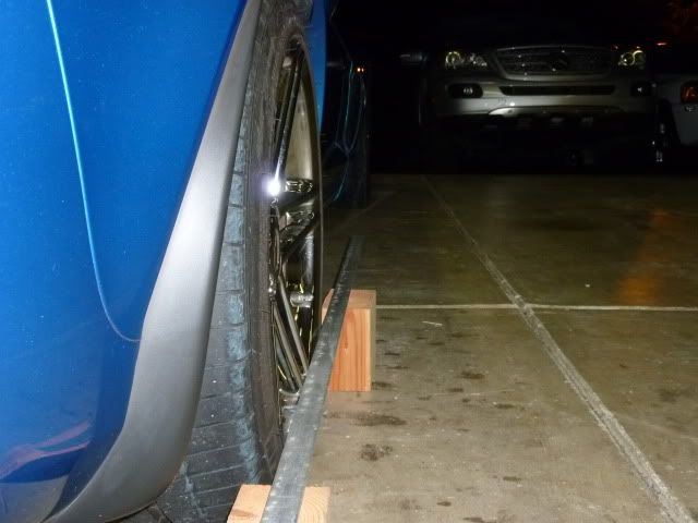

Sight from the rear on the outer edge of the rear tires and measure the distance this imaginary line is from the front tire on each side. This distance should be the same. Use a toe gauge to measure the toe. It's not hard to do. Just have to think about it.
