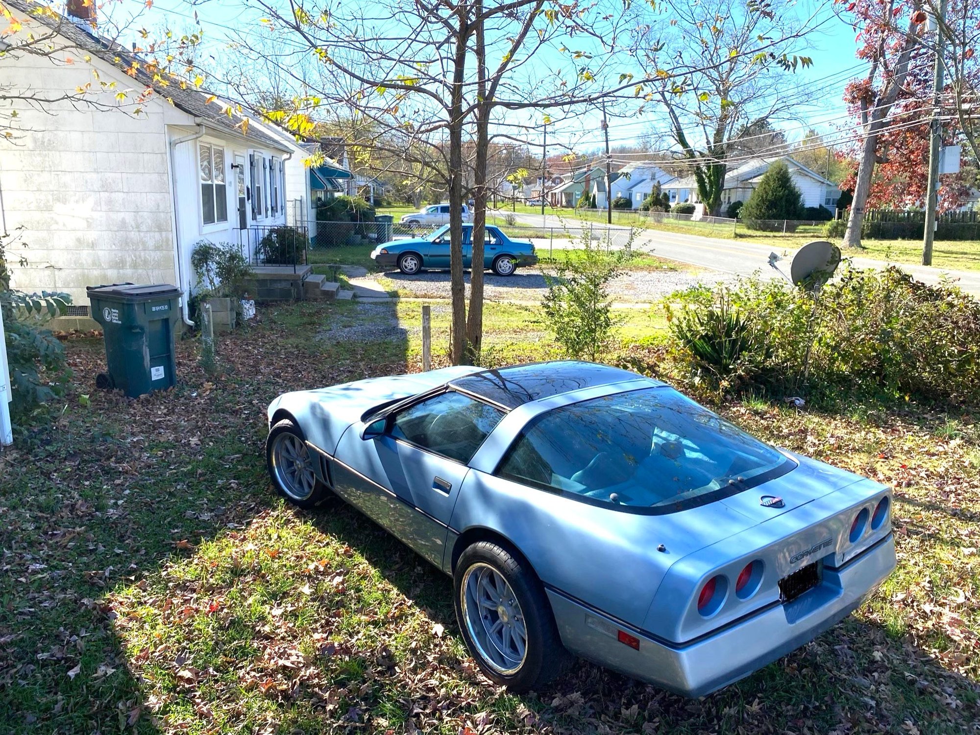

I’ve been Steadily working on my 85 vette for over a year . Finally got to spend a day cruising around . Holley Sniper EFI , Nitrous Express Progressive nitrous system , Edelbrock EPS dual plane intake , Comp Cam and valve springs , Stock heads shaved and ported ,MSD HEI with Accel Ceramic boot wires , Monster Transmission 650hp 700r4 rebuild kit , Holley 100 gallon per hour fuel pump , 2.5 True dual exhaust ,SoundFX mufflers , Air pump delete , 9.5 x 18 rear and 18x8 front wheels

Hows she running? That s lot of mods for a shakedown run. Who did the tuning?

She runs pretty good . The Holley Sniper self tunes pretty good for the most part . I can email Holley my data log and they will recommend adjustments.
I forgot how much fun these C4’s were to drive , got to do a nice mix of highway and backroads for around 60 miles total . Without the TPI it definitely wants a 3.54 gear . But other than that i don’t have any complaints so far

The system is supposedly self tuning for the most part . I can data log and send it to Holley for fine tuning or tweak it myself with the laptop . I got to do a good mix of Highway and backroads. I’m very happy overall but without the TPI it really wants a 3.54 gear .
