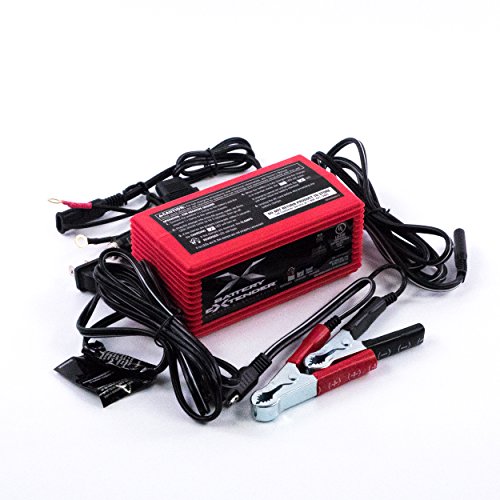

Here's mine:
I added the lighter plug. It contains its own internal fuse, although the wiring to the lighter socket is fused at the vehicle's fuse panel. This photo is old, and I have since extended the wiring between the charger and the plug, which allows me to hang the charger on the garage wall, suspend the wiring overhead, and drop it down through the partially-open car window. The voltage drop across the additional wiring is trivial, and the battery is maintained with a near-optimal charge while it's parked. Works great. I can connect/disconnect it in seconds, can move it from one vehicle to another in a minute if desired, and it's pretty much impossible for me to forget to disconnect it before backing the car out of the garage.
Live well,
SJW
