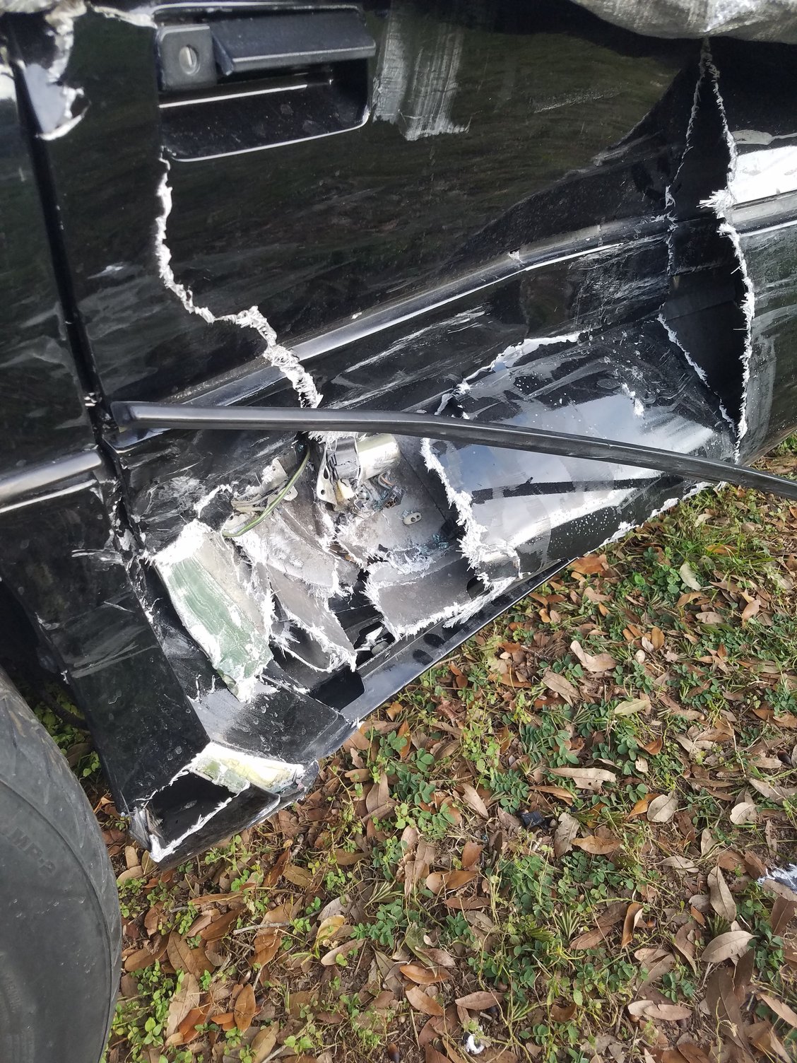

Where the door got hit is towards the rear of the door and the lock is no longer powered or functional. Funny enough the door light is still powered. As someone said above the security system runs through the passenger door. For a better understanding of where exactly it was hit, here is a picture.
There is a small ?motor? visible and some wires to the door.

It appears that your lock solenoid is visible on the outside of the door. There will be electrical issues potentially in that area so look hard for anything damaged.

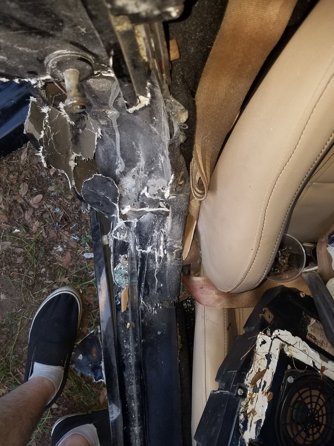

I finally was able to get the door off the car after many hours so I could check fuses and am at a deadstop. I visited a Corvette parts and restoration place (with more than 350 parts cars C3s and C4s) and asked the owner if a replacement door and repair was possible. He just did a little laugh and told me he can't work on it because the door sill was damaged, and that C4s can get "totalled" from just a hit anywhere on the frame rails since the cost of repair is higher than their value. Even a dent. Is he right? I would like input on the damage to the structure before I proceed with any repair. If it can't be repaired then I'm going to have to get another one.
