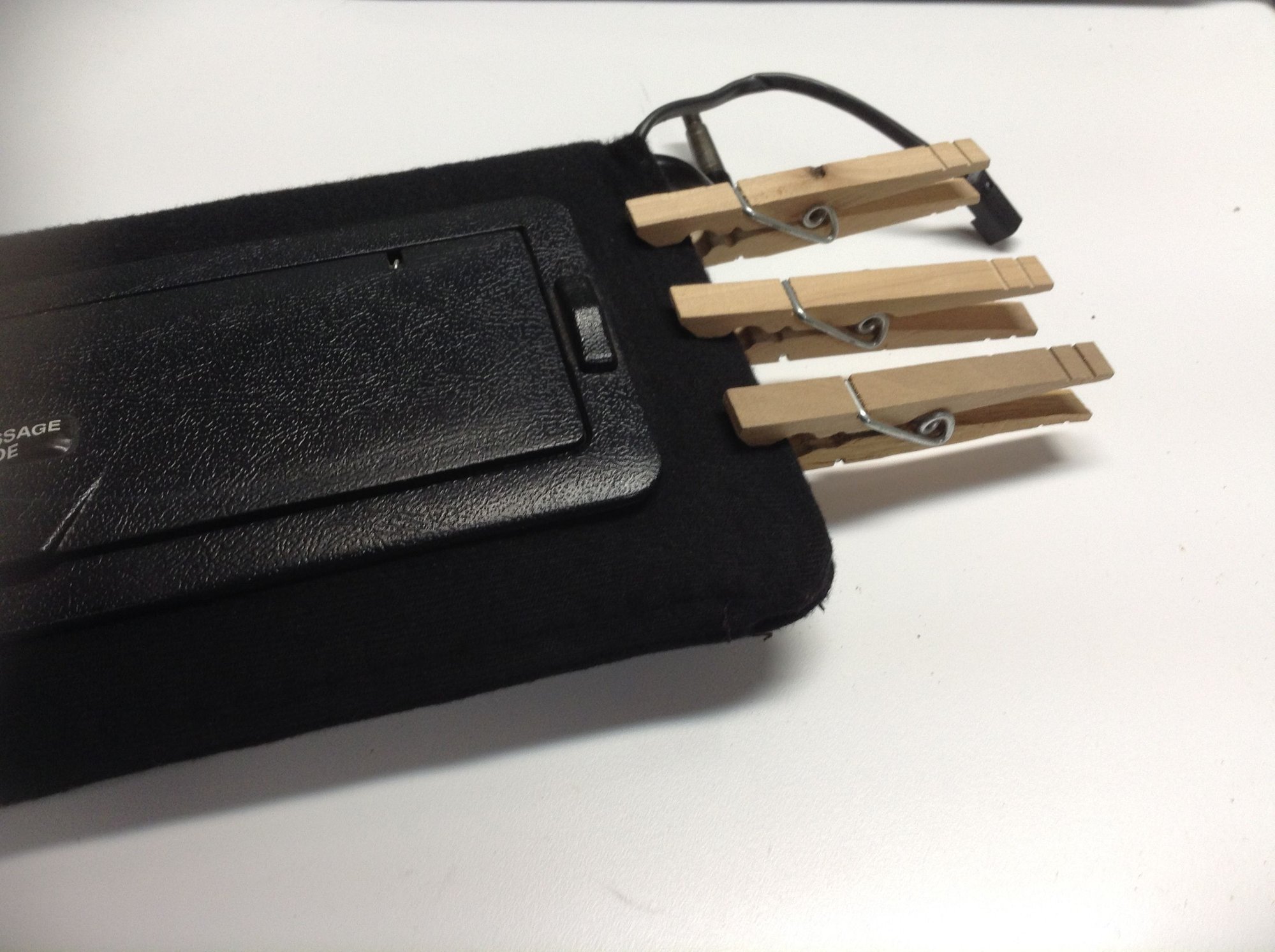

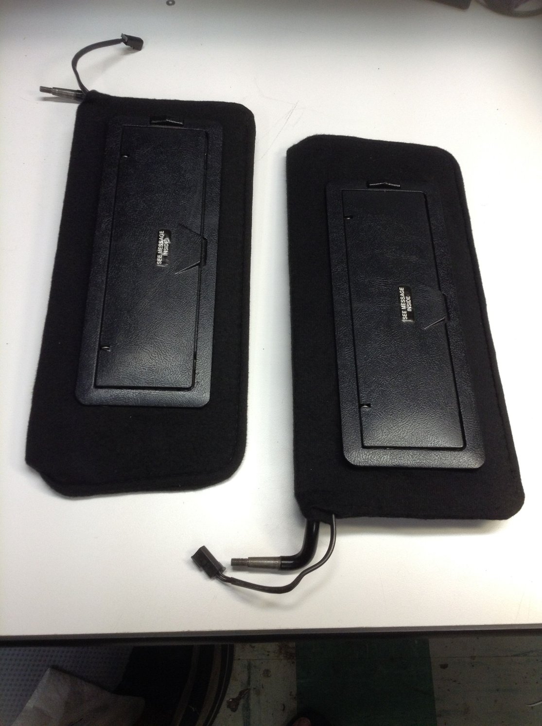

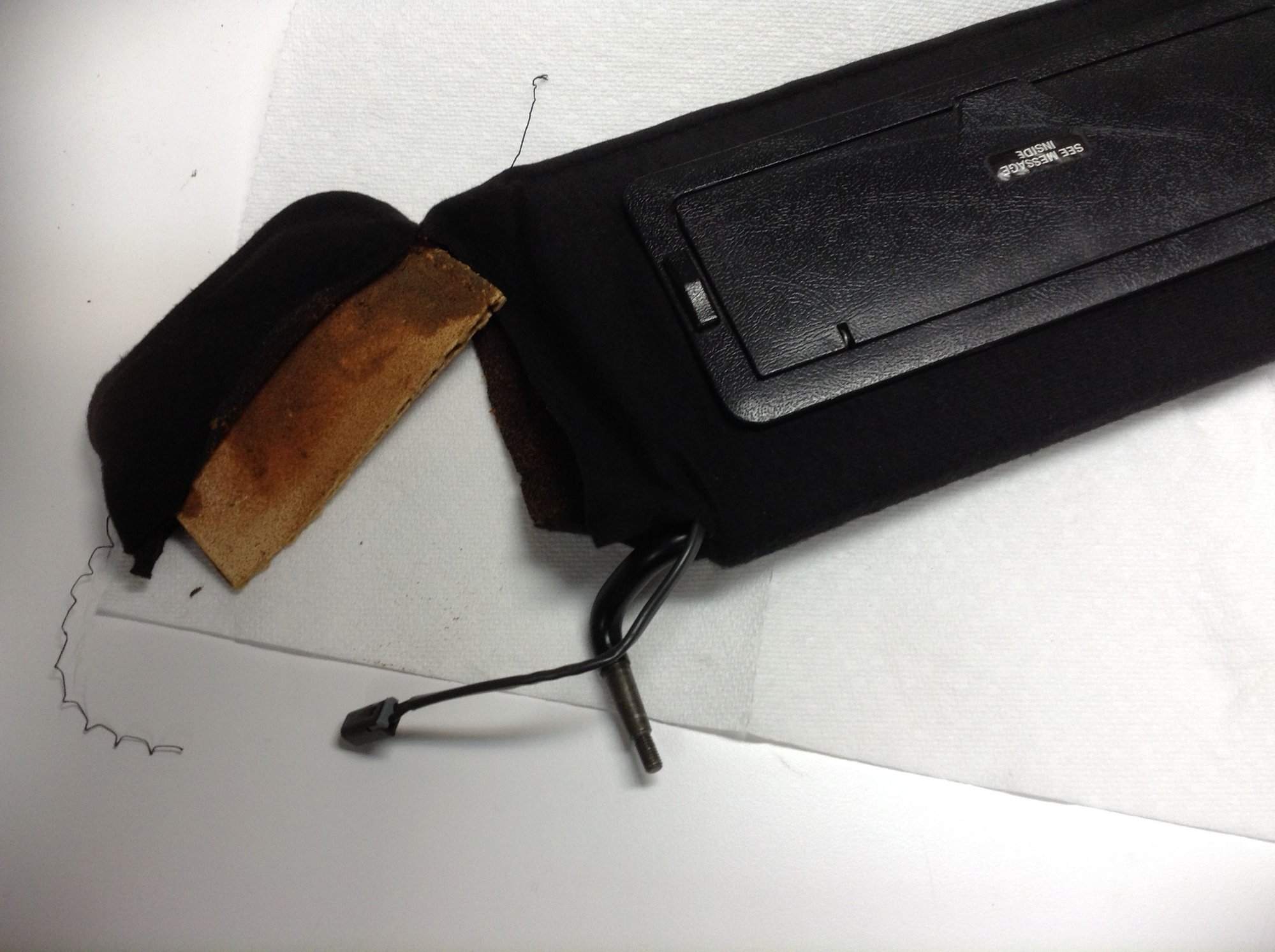

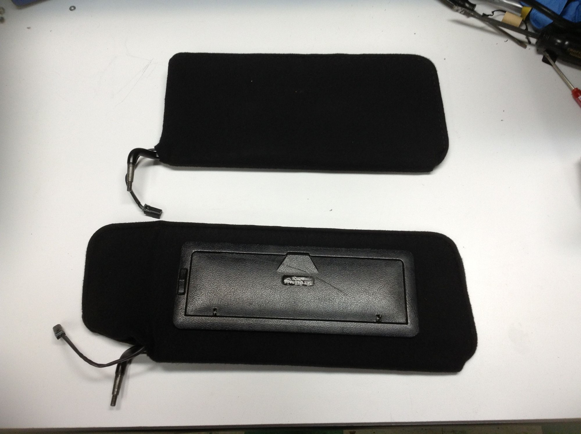

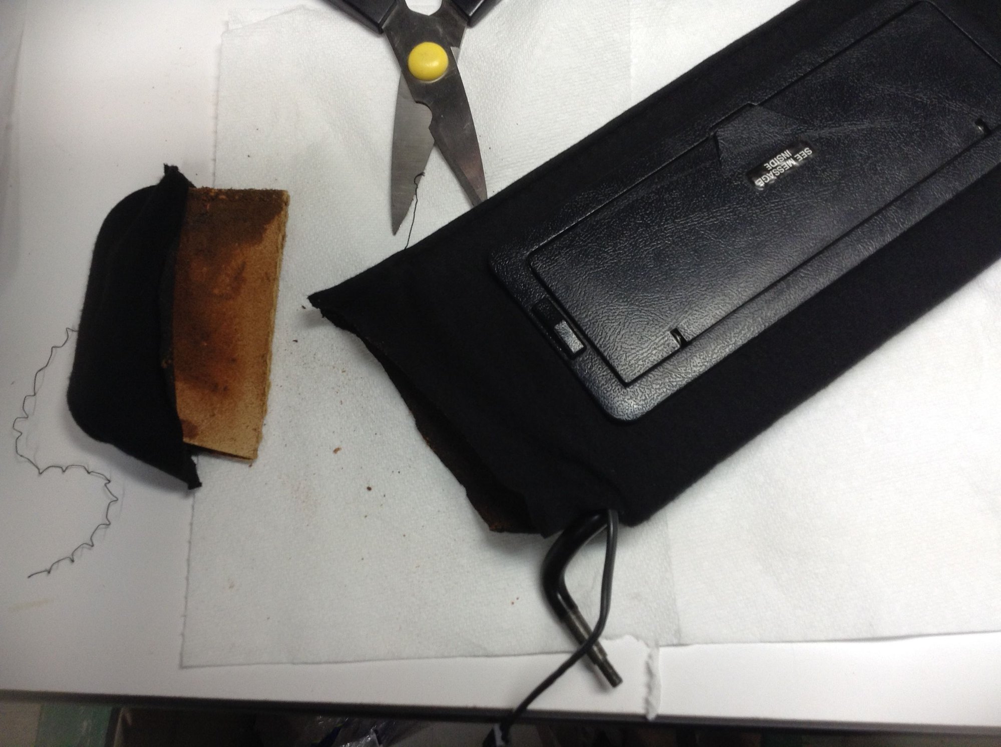

At least one forum member found junkyard visors that seemed to have worked well and looked good. I don't recall exactly what they were, but IIRC, they were from a Chrysler product. For an alternative to consider, I removed my visors, opened up their ends with the floppy ears, removed that portion of the cardboard, trimmed the fabric covering to a suitable length, and re-stitched the fabric. Obviously, this leaves you with a shorter visor that doesn't fully block the sun in the upper corners of the windshield, but IMHO it looks one hell of a lot better than the floppy eared mess that previously existed. If I were to do it again, the only thing I'd do differently would be to trim the new corner of the remaining substrate to a larger radius than what I did, to better match the other corner.
Surgery begins:
Amputation complete, with enough fabric remaining to extend beyond the substrate for stitching up:
Ready for closure:
One done, one awaiting surgery:
Both done:

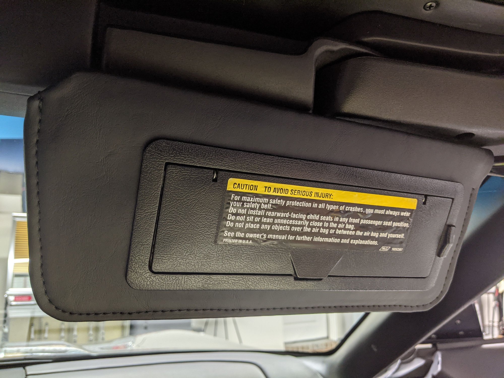

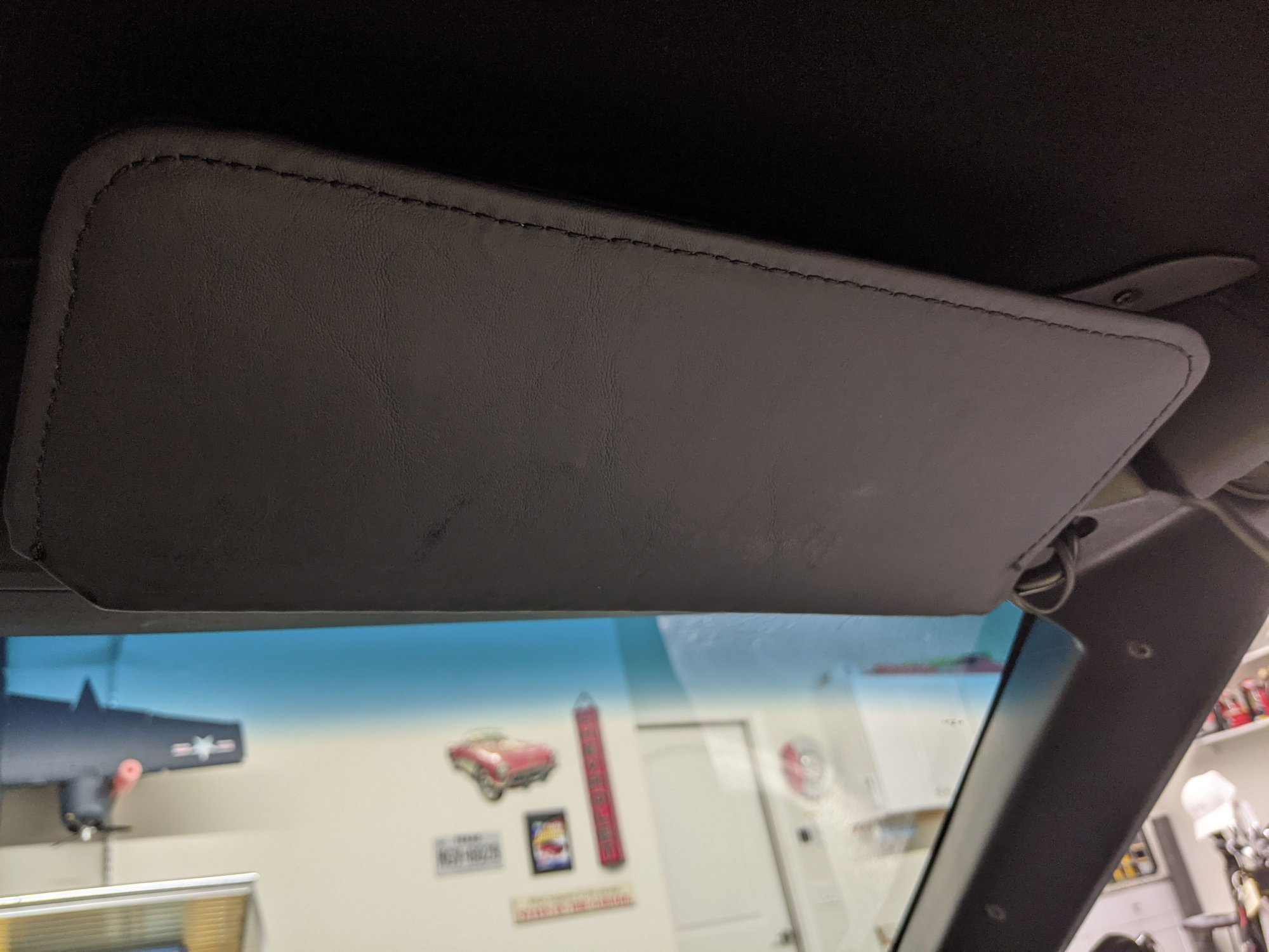

I had mine recovered in black vinyl at the local upholstery shop. They came out great. The cardboard inside had deteriorated so badly that dust kept coming out of them. I also removed the floppy ears.

what did they charge you to do that?

I believe it was around $150. About the same as a new set. Here are a couple pics. Much better than the cloth covering.
