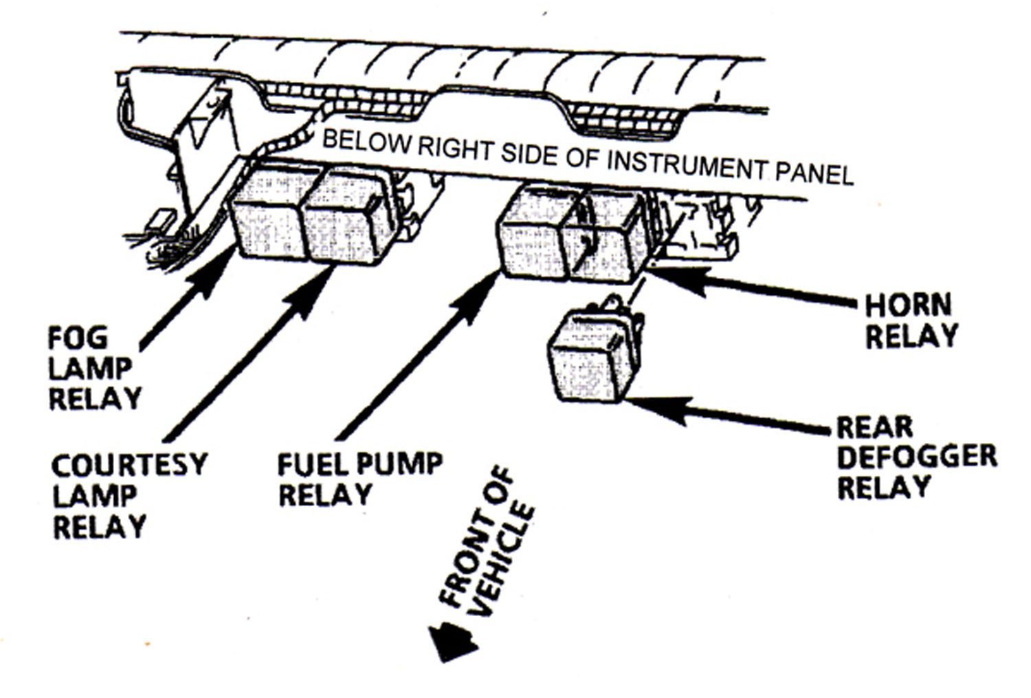

It won’t crank or start, you just get the security light. I had alot of problem with mine. Also a 1990. The crank and no start could also be a pump relay. There are 2 under the dash. One under the driverside and one under the passenger side. The vats is goofy, ive heard of some people and have had it happen to me where you drive the car shut it off and go to turn it on and nothing. Then after the vats resets after 5min or a day or so it starts right up.
