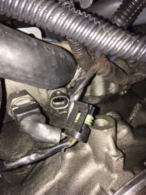

To follow up, I went out today to try and figure out what is making my cooling fan come on at such a low temp before my thermostat opens. I disconnected all three cooling sensor. The one in the intake manifold, the one on left cylinder head and the one on right cylinder head. I started the engine and let it warm up. The main puller fan came on as stated in my post above. This did not make any sense with all 3 sensors unpluged. The only thing I can think of is something is sending information to the fan relay to run the fan. Everything looks original with no wire tampering anywhere.

Thank you all for responding with your suggestions. This is the temp sensor that goes to the ecm that I unplugged along with the other 2 as I mentioned. I am going to pull the ecm and check it out and see what prom is in there and go from there. It also could be a bad ecm. I may take your advise and buy a hypertech chip or order one from TPI chip programming if they still make them. I am still confused and think I honestly did the testing the way I explained twice. The second time the main fan came on at 160. How I tested with the 3 sensors unplugged was wait for the fan to come on and then plug in the sensor by # 1 plug and then checked the dash gauge. I deffinetly believe the dash gauge is reading correct because when the top radiator hose gets hot the temp gauge reads 190 and when I drive around it reads 190 give or take with a 190 stat. I do not want to install a 160-170 thermostat but will go with a 180 and I could always consider a sensor kit for that but first things first.
