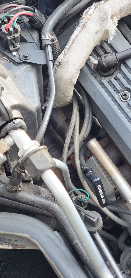

Some background info. My 86' C4 has had some issues with stalling and surging in the past. I pulled code 33 and cleaned my MAF. Then after a few weeks I pulled code 42 (Electronic Spark Timing malfunction).
Recently, on a drive home I got some stalling issues and a service engine soon light. I stopped at a stop sign and smoke poured out of my hood on the passenger side. Stopped in the road and opened the hood to find a small fire on what I think is an exhaust pipe. The picture is where the fire was.
I was able to blow it out and drive home (25 miles) without further issue. Next day I drove to the other side of town (2 miles). When I got home there was smoke coming from the same spot, but no fire. After watching it a bit the smoke stopped but im a bit worried im going to burst into flames.
Both times this has happened I have had no issues with coolant or oil temp and my oil was changed about 2 weeks prior to the first fire. Also I checked my oil and it is at a perfect level.
Any ideas?

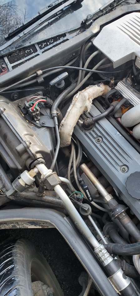

The fire was just under the white heat protector you see. Toward the bottom of the engine.

Valve cover gasket leak.

Valve cover and China Wall? IMO, pretty common. I'd definitely clean everything off and dump some dye. It is difficult or easy depending on your facilities. Out in the driveway in WI today? FAWK NO. In a heated garage, sure. You may be able to loosen the AC bracket enough to get the compressor to tilt forward enough to move the VC. I'd take the VC out and check it for straightness, clean the head and use a new gasket. Some have suggested using some RTV, others say no.
Edit. I don't know if this works without removing the AC compressor since I have a HSR intake and no AIR tubes. YMMV. You might have to remove the AC compressor enough that you can get at it and not have to discharge the thing.

I see Bosch III injectors...some people have had issues with the way these injectors seal as they are shorter than stock and do not use some sort of retention clip.
Bosch III + o-rings
Bosch III + o-rings
IDK how the retention clip works for sealing. Doesn't the rail push down on the injectors? I thought they were there for assembly lines? I haven't had them in my car since a long while ago when I had the 383 installed.
Do they look that different in length?

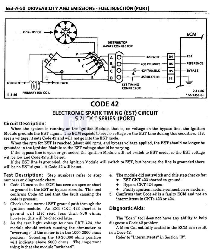

Aklim is right, the clips do nothing. You do need to double up on the o-rings as shown. I find it odd that you had a fire. Usually oil dripping on a hot manifold will smoke, but not reach the ignition flash point. I suspect your spark timing issue is causing your engine to run lean making the exhaust very hot. This page from the SM may help:
