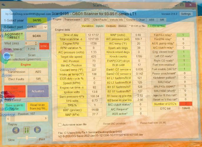

Ok, I used scan 94/95 as recommended by Gary Doug. Here is what I captured when the engine was warmed up and idling. Can anyone take a look and comment on this? Thanks....
