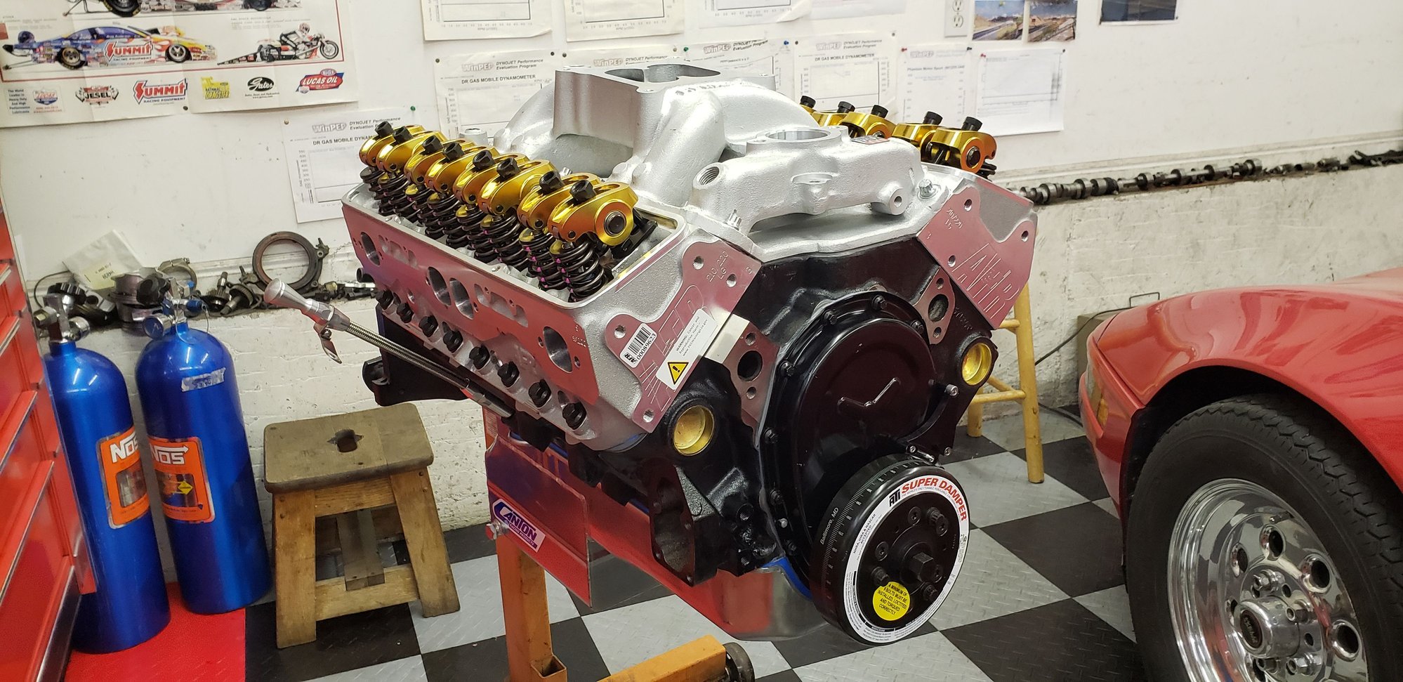

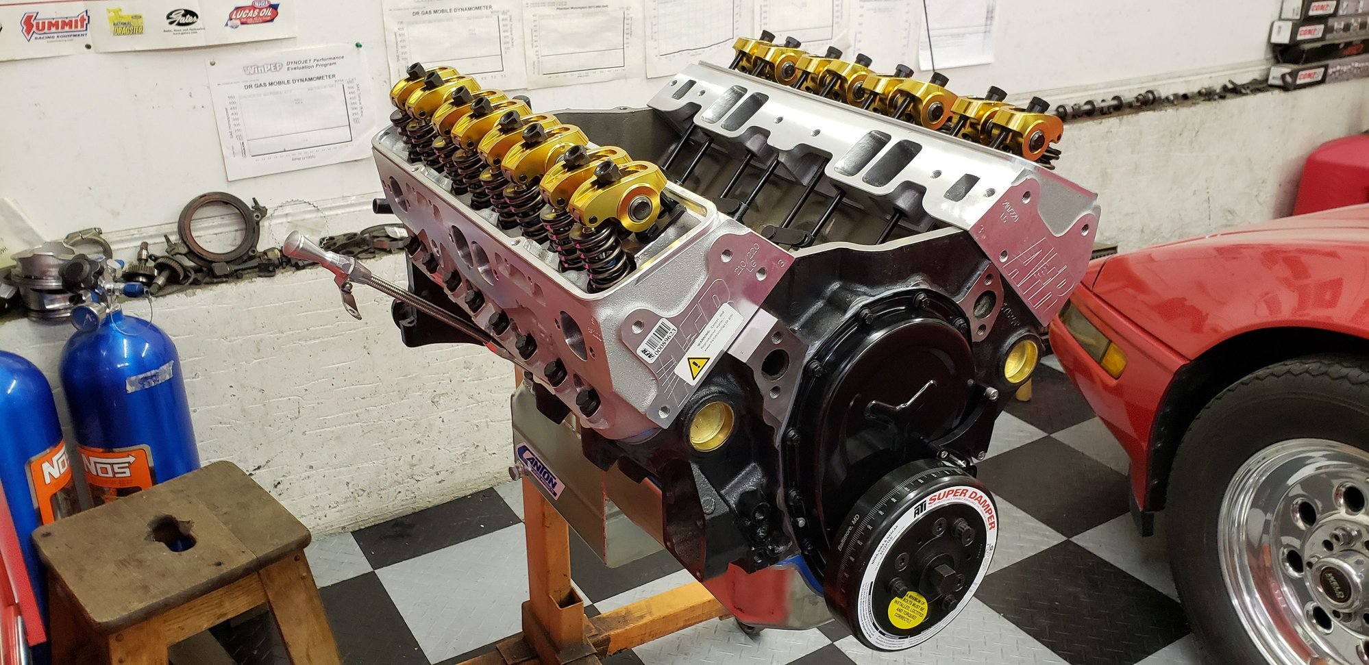

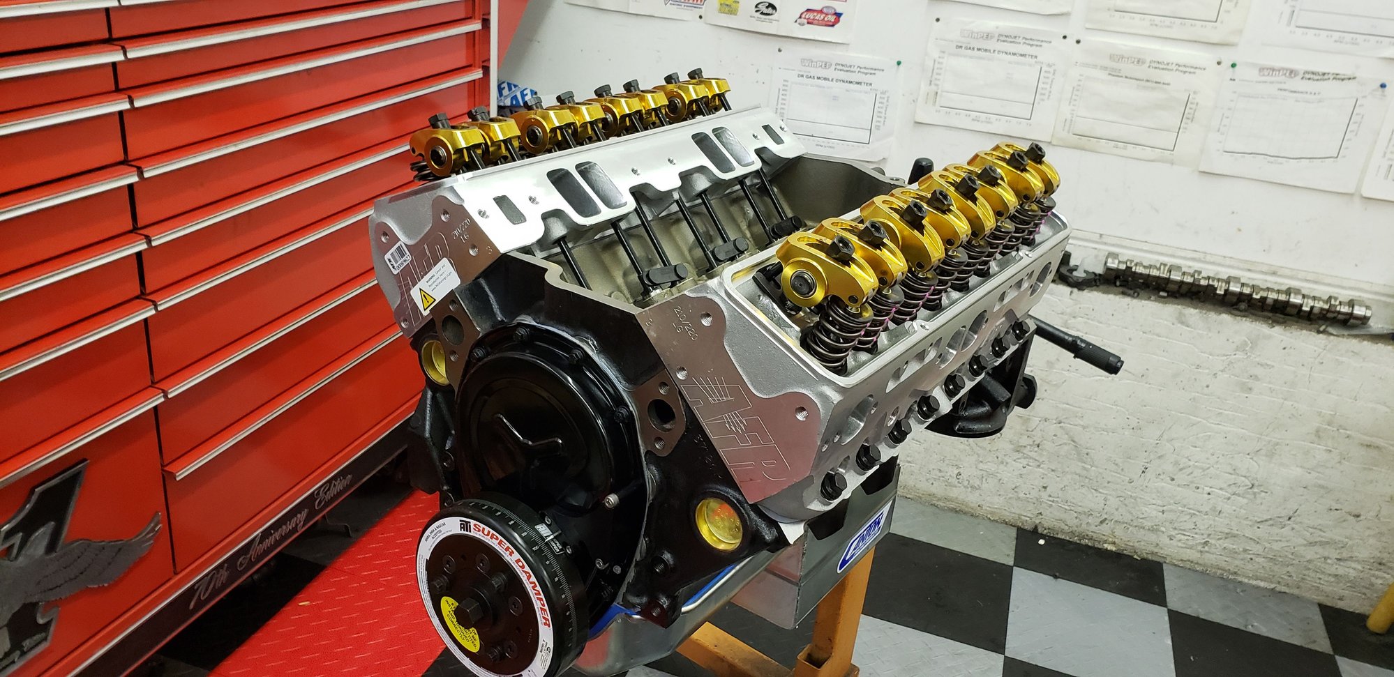

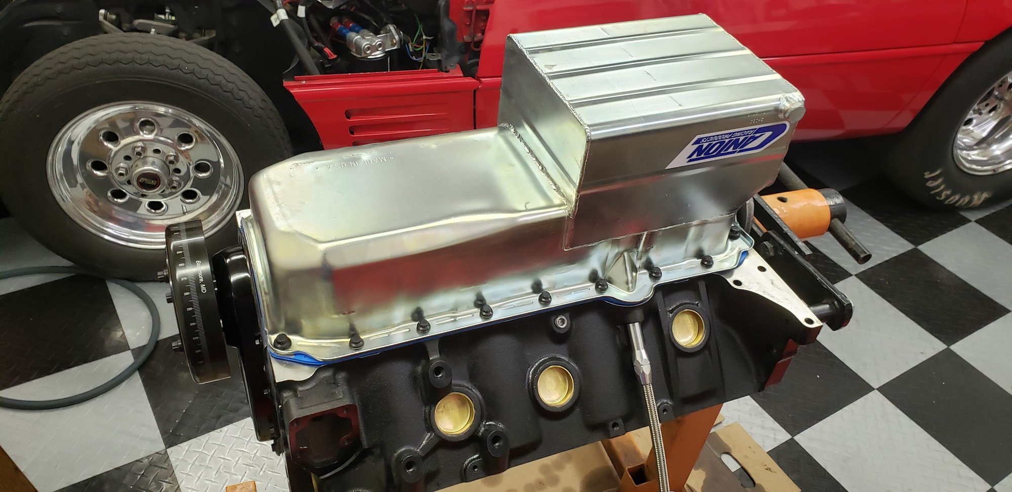

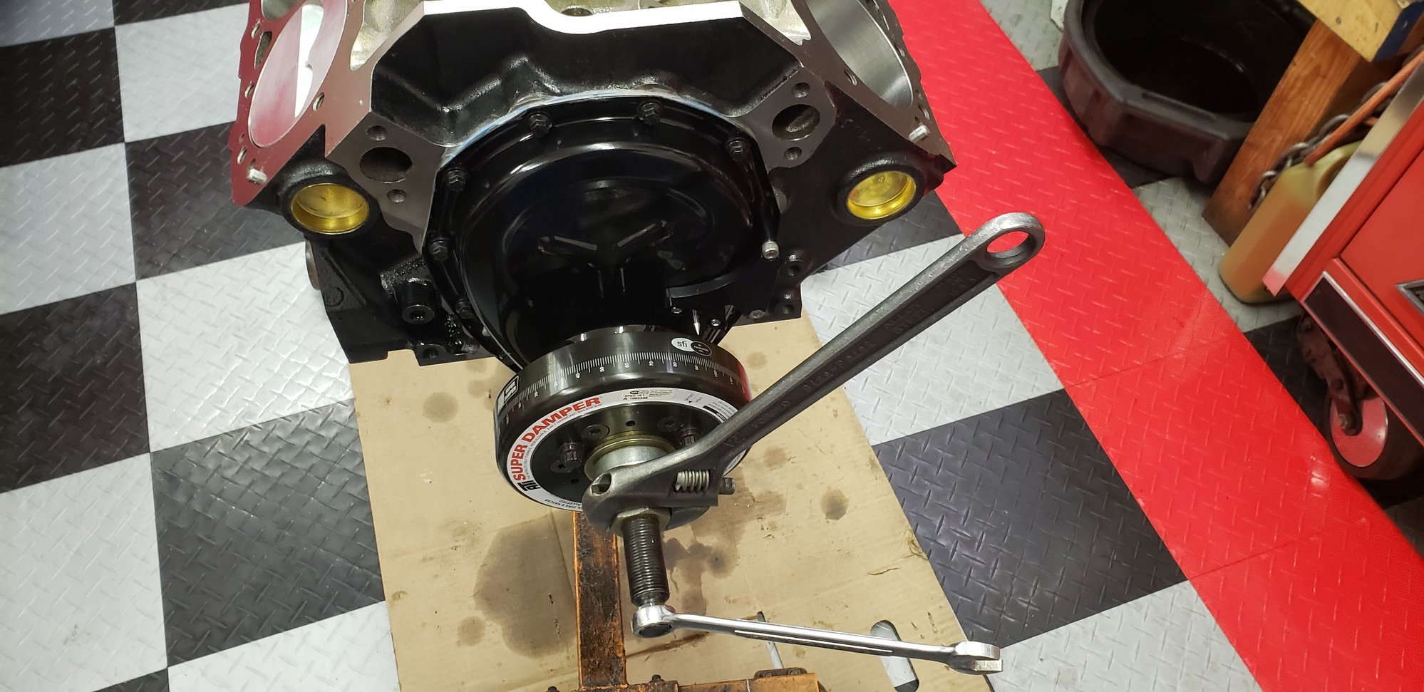

Hey Guys, I haven't posted any engine builds in a while. I'm doing a 427 sbc (4.125x4.00} for a local guy. It actually going in a car hauler truck. So its not a max effort build. Its kind of a hot rod truck. It has to have low end pulling power, but he still wants as much top end power as we can. So I'm using Dart SHP block, JE pistons, Callies rods, a Manley crank. I'm using AFR 210 comp port heads that flow over 320cfm. I had to be careful on cam selection. I wanted something small enough to make low end torque, but big enough to try to still make some top end power. I ended up using a Crane 222/230 .543/.579 on a 112 lsa. Thats with a 1.6 rocker. It's not alot of cam for a 427. Its also carbureted, so I'm using a Edelbrock performer rpm air gap. A good dual plane will also help with torque. I had Strasburg machine do the machine work. They are one of the top machine shop anywhere. They internal balanced it to .5 of a gram. I think it should run good.

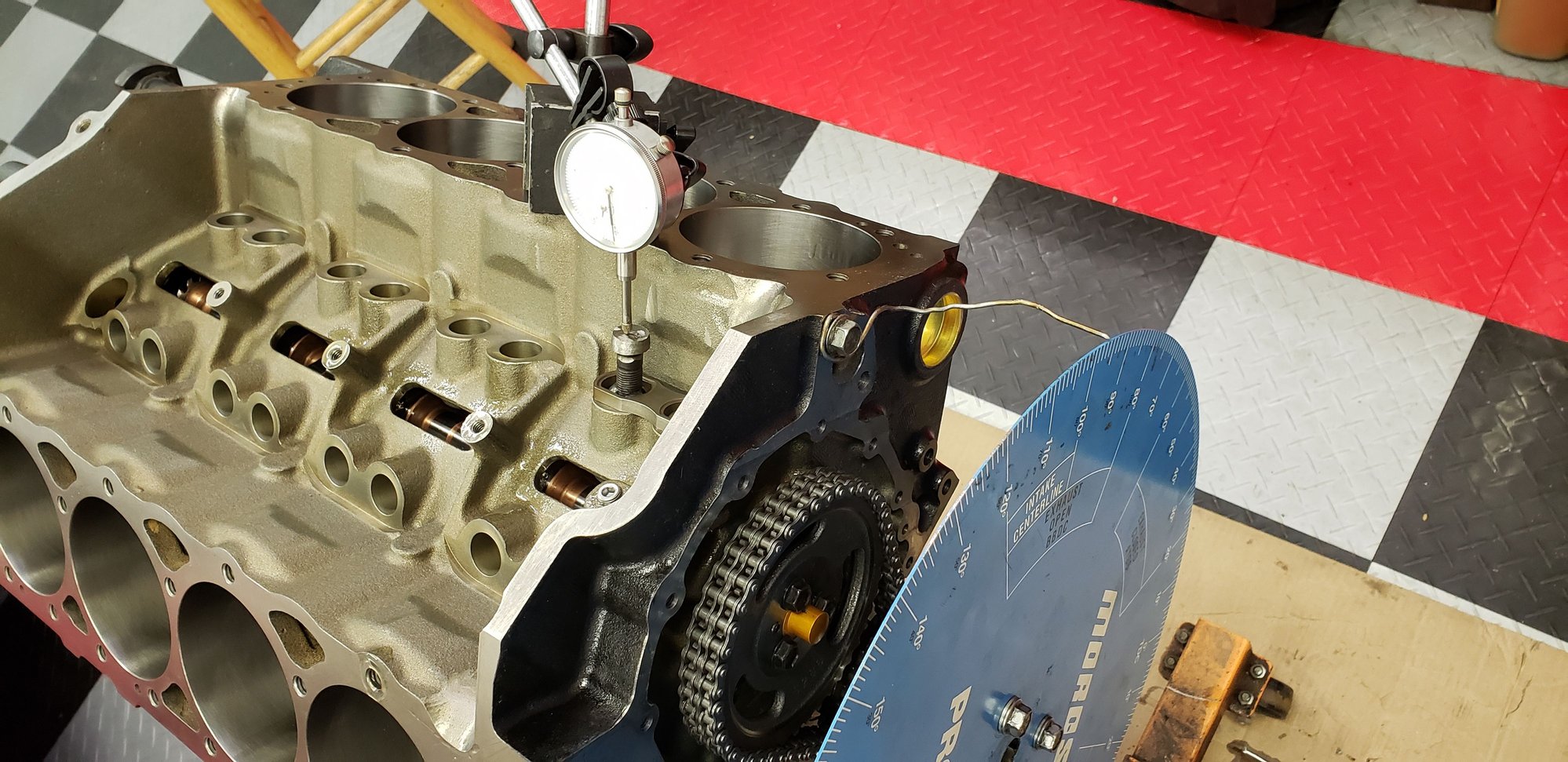

I degreed the cam. It was .5 a degree advanced, so it was about perfect

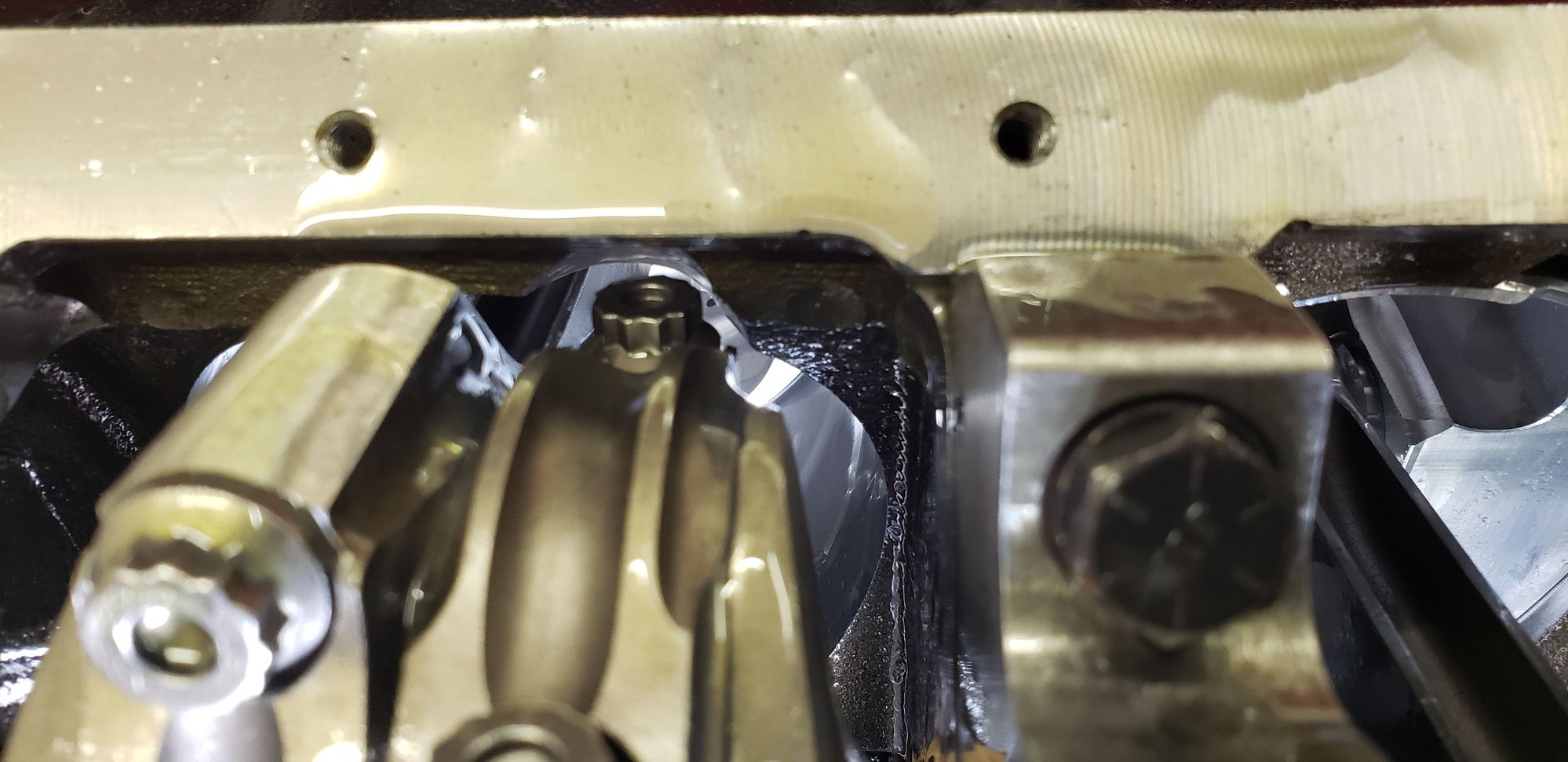

I use a small journal rod because rod to block clearance and rod to cam clearance is so tight. You can see how much clearancing it took to make it clear a 4.00 stroke

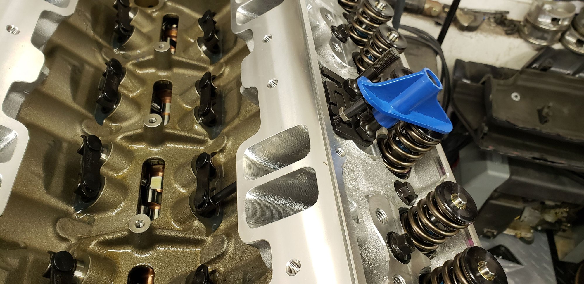

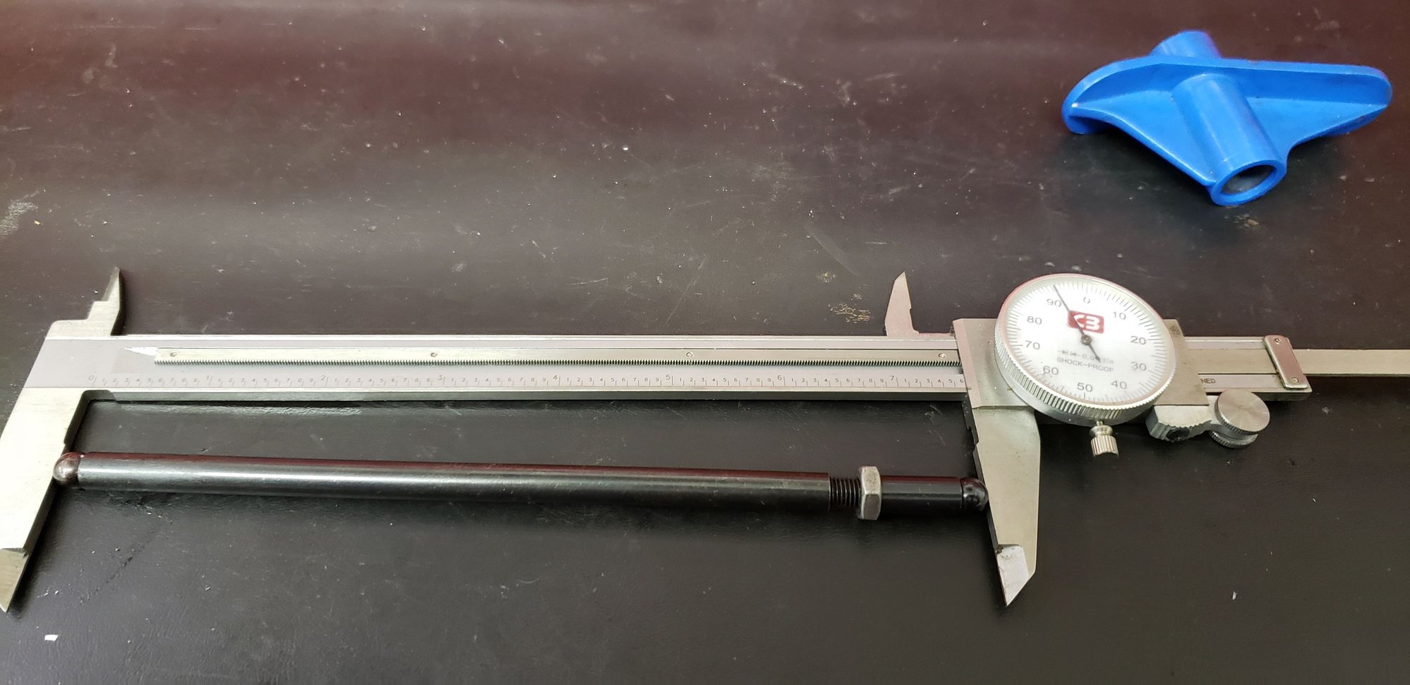

I was measuring pushrod length. Stock length is 7.20. Because the cam is ground on a .950 basecircle and the AFR 210 has a taller port, it needs a 7.60 pushrod length. The AFR 210 casting is the same casting as the AFR 220 head

Originally Posted by TravisSchoech
Hey Jim,
Mechanical roller or just retrofit link-bar?
its a hydraulic roller. I used the tie bar lifters because with a .950 base circle the stock lifter directional plates dont grab enough of the lifter. I could have used a tall body lifter Crane makes, but they are well over $700. These will work fine
