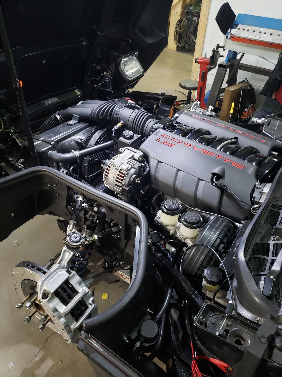

You could also go another direction Like me an do an LS/T56 magnum swap, which was much more involved but will yield an awesome car.
Here's my thread:
https://www.corvetteforum.com/forums...peed-swap.html
Quite a few people on the forum have done LS swaps, so you can search and find thier threads also if its something that interests you.

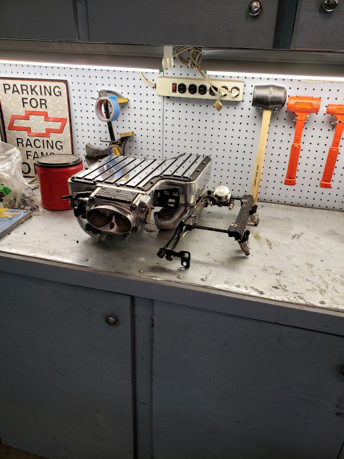

If you want something that is even less work you could just do a cam, super ram, headers on your car and either keep the 4+3 or so the SST TKO 500 swap.
I used to run a super ram until I started the LS swap, with a cam it can make power to around 6000rpm. Great street intake for a 350 or 383. Here's what they look like (Mine is just collecting dust in my workbench at the moment)
Hope that goves you some ideas and kind of answers your question.
