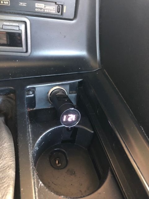

I was looking at those too. Actually that specific one General consensus is these modulators work better than the little cigarette lighter transmitters. I spent a little time looking at the wiring coming from the CD changer. Trying maybe hack together something into the existing transmitter. According to the pioneer PDF the existing one has an attenuator, and some sort of simple eq.
I just ordered one of these. The 88mm x 20.6mm it should fit right in there and give me what I'm looking for without any mods for now.
Baseus FM bluetooth transmitter

So the Baseus bluetooth jammy just arrived. Fits just fine, connected and plays without issues. Transmit power is very low but usable. The USB ports and display are opposite of what I think they should be. It'll hold me over for a while.
PS It does not seem to sleep itself.
