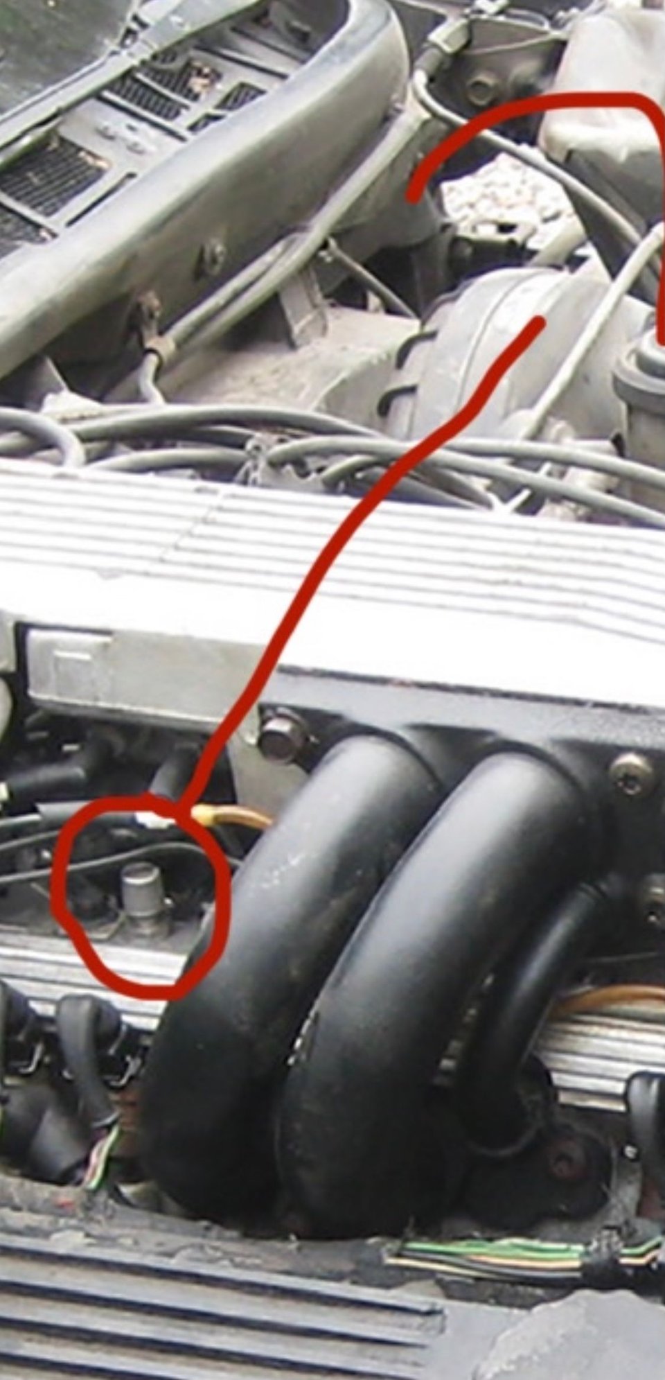

After some research I have found that this to check the fuel pressure...? Basically I got the car a month ago and just recently noticed it and saw there was no cap it smells like gas coming out and when I noticed the cap missing the car had problems staying on for more than 5 seconds... could that be the case and where can I get a new cap for it thank you also I’m new to forums :/

The plastic cap doesn't hold the fuel in. There is a small valve similar to whats in a valve stem on your wheels. The cap just protects the valve. Are you leaking fuel out of the test port?

yes... what’s circled in the image has gas or what smells like gas bubbling out 😔

use a valve stem tool and try to tighten the valve, just like on a car or bicycle

Any junk yard would have one. The U Pull & Pay I go to wouldn't even charge you for one. Just find a GM with a test port on the rail.

The cap is not your problem. The schrader valve needs to be replaced.

These GM#'s might actually do what you want - might!
25532663 or 88894338 for the Schrader and 25532662 for the 'cap'
I'd think local GM or ACD jobber
