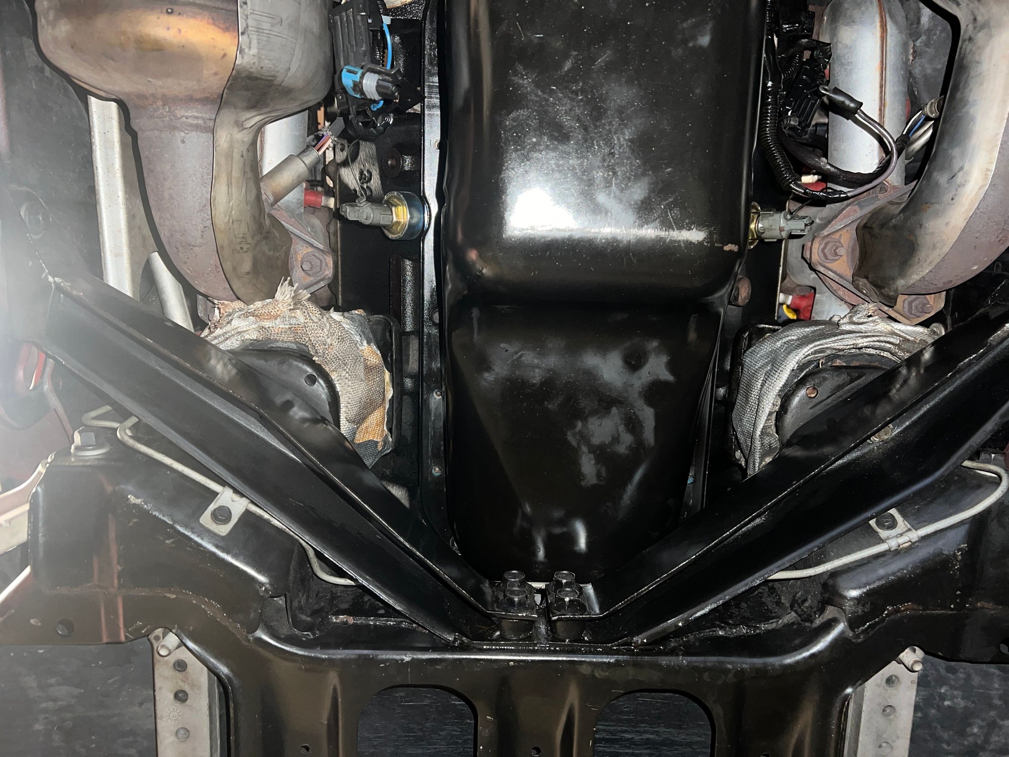

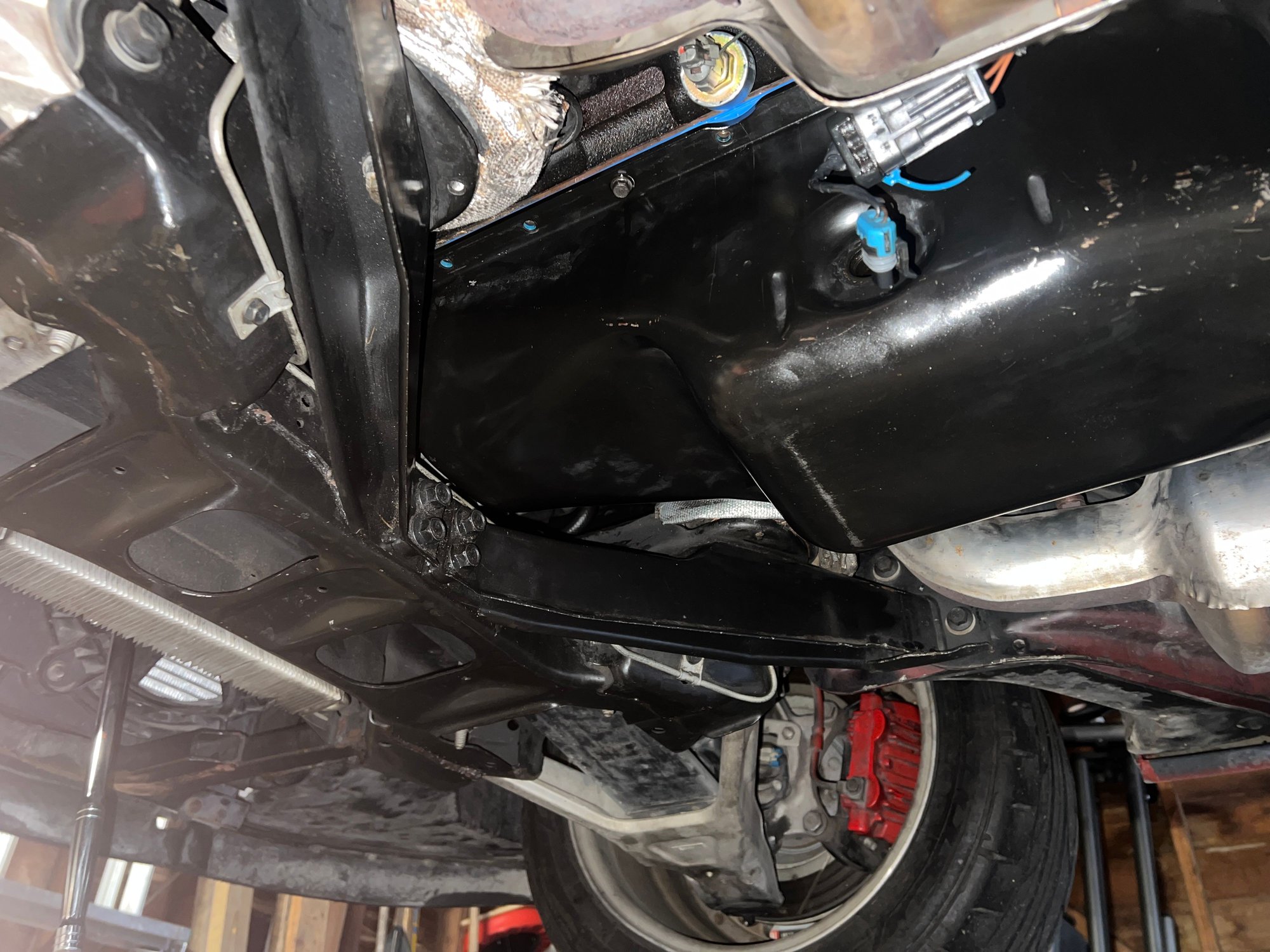

When you removed the crossmember braces, didn’t you have to support the engine? It looks like the engine mounts sit on top of these.
The engine sits on pads from the crossmember. The braces are below these pads. The engine stays put, sitting on the pads. << I know this is true for the late crossmember used with ZR-1/LT5 and the LT1/LT4 because I've had the braces off of both of these. I'm not sure about the earlier L98, because I haven't had the braces off an L98 car.
Interesting. I looked up pictures of early LT1 crossmembers and it doesn't appear the engine mount stud goes through it like on my 1996 LT4 car. After checking out my car, I understand what you're saying. The pad that the mount is resting on is actually coming off of the crossmember, when it appears that pad is being supported by the crossmember brace. Great!
1992 LT1
1992 LT1 Not an LT1. It is an L98.
This picture is a 1990 or 1991 (It has the impact brace in front of the crossmember that begins in 1990) L98 car.
L98 with KC4 oil coolers have the pipe under the oil pan. They also have the air tube to the rear cat converter visible to the inside of the exhaust pipe. LTx don't have oil coolers or air pipes. L98 have different braces and crossmember than LTx, including LT5.
